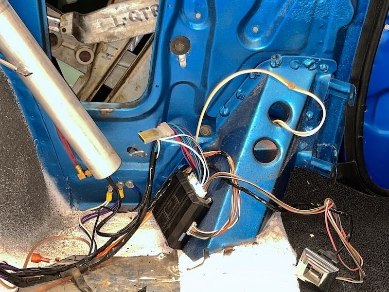

The module that Fleming linked to will only work with late-model reversing-type window motors that have a single winding; circa 1979-later. The window motors in most earlier models have dual windings; one for the UP direction and another for DOWN and they ground through the body of the motor to the door sheet metal. The DEI535 module can provide auto up & down for 2 windows or auto up for 4 windows. It controls the window direction by reversing the polarity of the motor which is why it is only compatible with the single winding motors and cannot control the dual-winding motors.

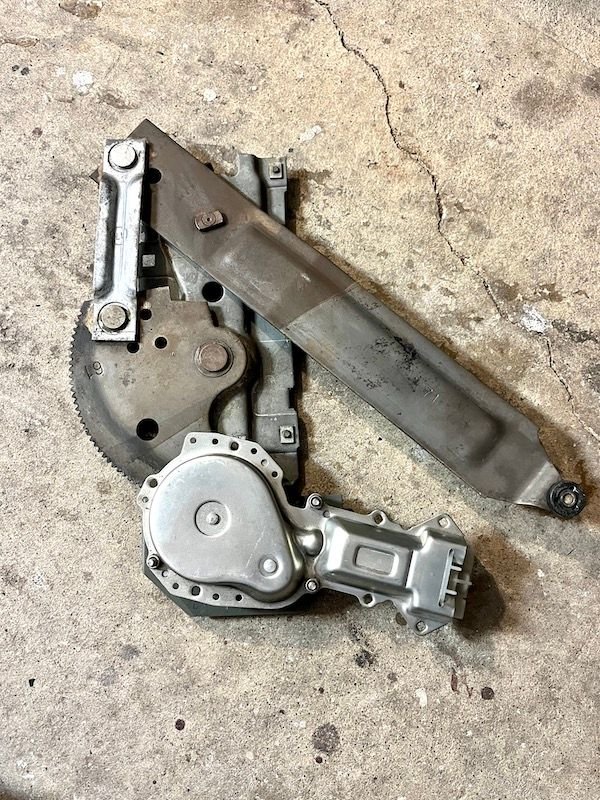

Like you, I wanted one-touch, auto functionality for my convertible project so I designed some custom adaptor plates to allow me to mount late-model, single winding motors to my earlier power window regulators. I also had to build custom switching and motor harnesses as well to connect to the DEI modules and used late model window switches to be compatible with the reversing motors. It was a very arduous project and I spent many hours drawing wiring diagrams and working out wire color-coding; but I'm very satisfied with the end result.
Here's some pics from my project.

That's what I did. I used one module for the front windows and another for the back. My pic above only shows the front module and the associated wiring harnesses. The lighter colored wires in my pic are the switch legs from the drivers master switch; they were wired through the rear switches before feeding the switch inputs of the rear module. Here is a pic of the second, rear module, which is mounted in the driver's side ashwell.
