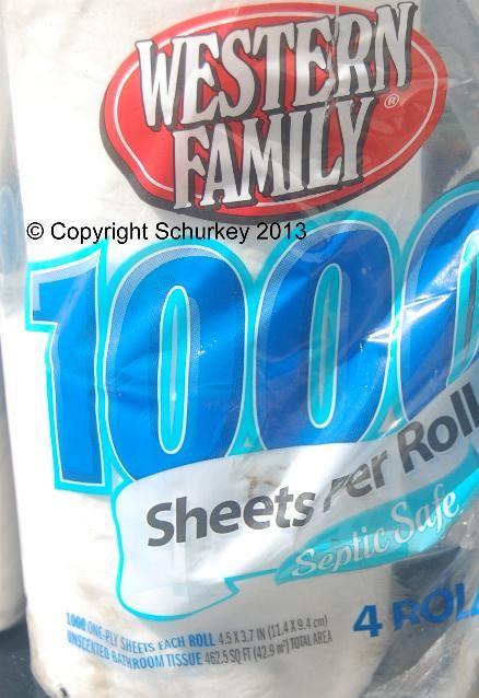

But the ones I have are the old SKY-Frantz filters that use a roll of toilet paper as the filter medium. I get 'em used on eBay for a hundred dollars or less. I've got a bunch of 'em, one on my solvent tank, one on my boat, one on my K1500. My K2500 will get one next summer. Add a Tee to the oil pressure sending unit, put a return into the oil pan or valve cover or oil-fill tube. Mount the filter, add some hose to connect the supply and return fittings. I like -4 steel-braid-over-Teflon (PTFE) hose. As long as the filter housing stays hot, the bypass filter doesn't need to be changed. When it gets cool, the filter is plugged, and I need another roll of cheap, old-fashioned single-layer asswipe.
