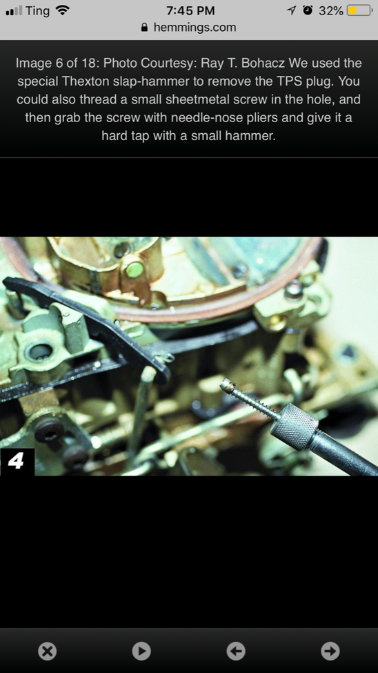

I seem to recall drilling a hole in an air horn on my friend's 87 Salon to make something adjustable. This was 17 years ago or so. It was near the accelerator pump pivot arm. Would that be this 3 point thing?
That was the cap on the adjusting screw for the TPS.
Probably not. It most likely was drilling the plug to use a screw or something to pop it out to reach the adjustable screw for setting the TPS voltage. If you didn't have to do any tiny-thread tapping just in front of the air horn from the inside, you wouldn't be adding a rich stop. To me it looks pretty difficult to add one. Seems simpler just to use the 2-point as the 4/32" setting window is built in.
