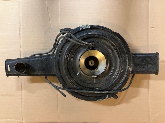

I'm trying to identify the Dual Snorkel Air Cleaner below. Thinking it was used by Oldsmobile in the 80's. Can anyone positively identify it? Thanks
Old Apr 5, 2026 | 02:49 PM
Posts: 50,802
1983-84 Hurst/Olds

Thank you
Old Apr 5, 2026 | 03:26 PM
69HO43's Avatar
Posts: 2,551
1983 only. The 84-87 air cleaners didn’t have the hole for the tvs on the driver front. It is coded “OX” but usually the decal center front falls off/desitigrates with age. Physically fits all VIN 9 or wannabe VIN 9 307 applications.
