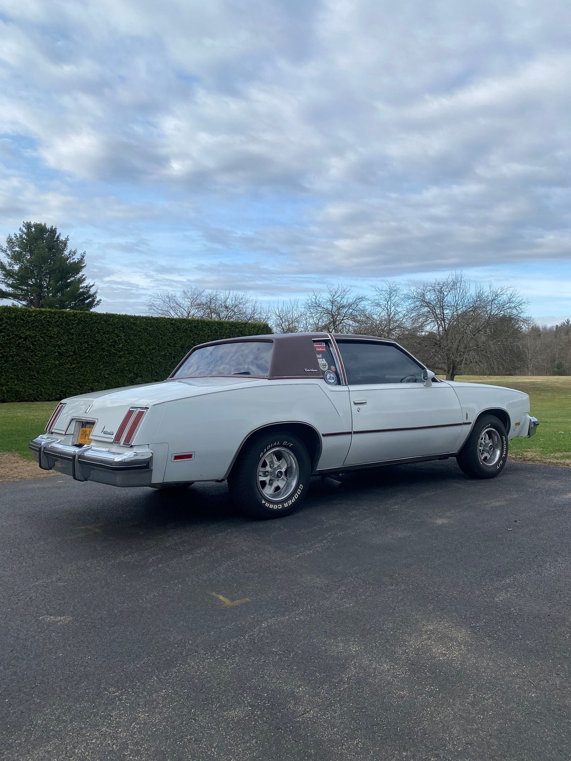

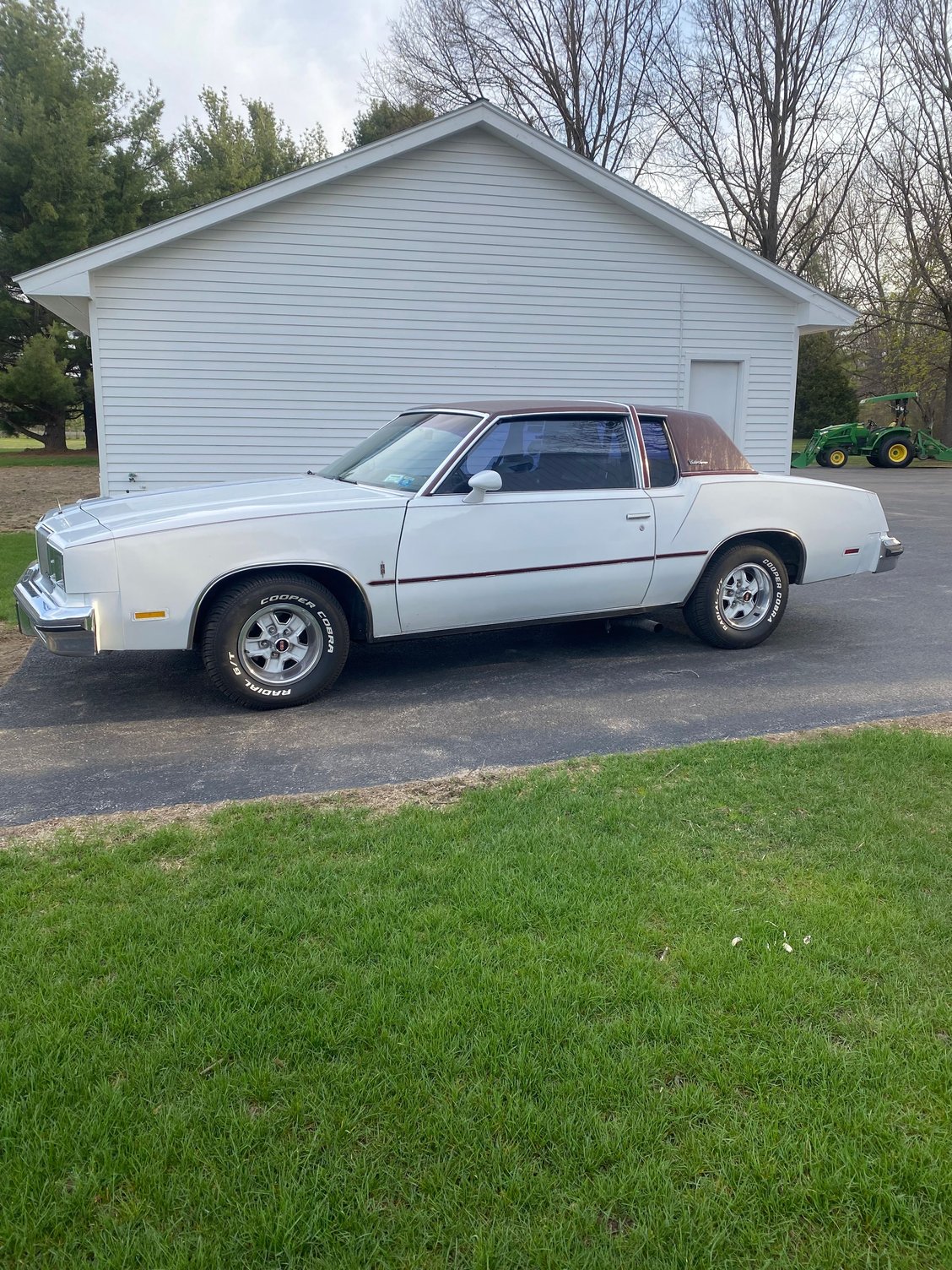

The car looks nice, clean and unassuming!
Are you running 14” rims? What size tires?

Yes these are the factory 14 inch wheels with p225/70r14 tires .

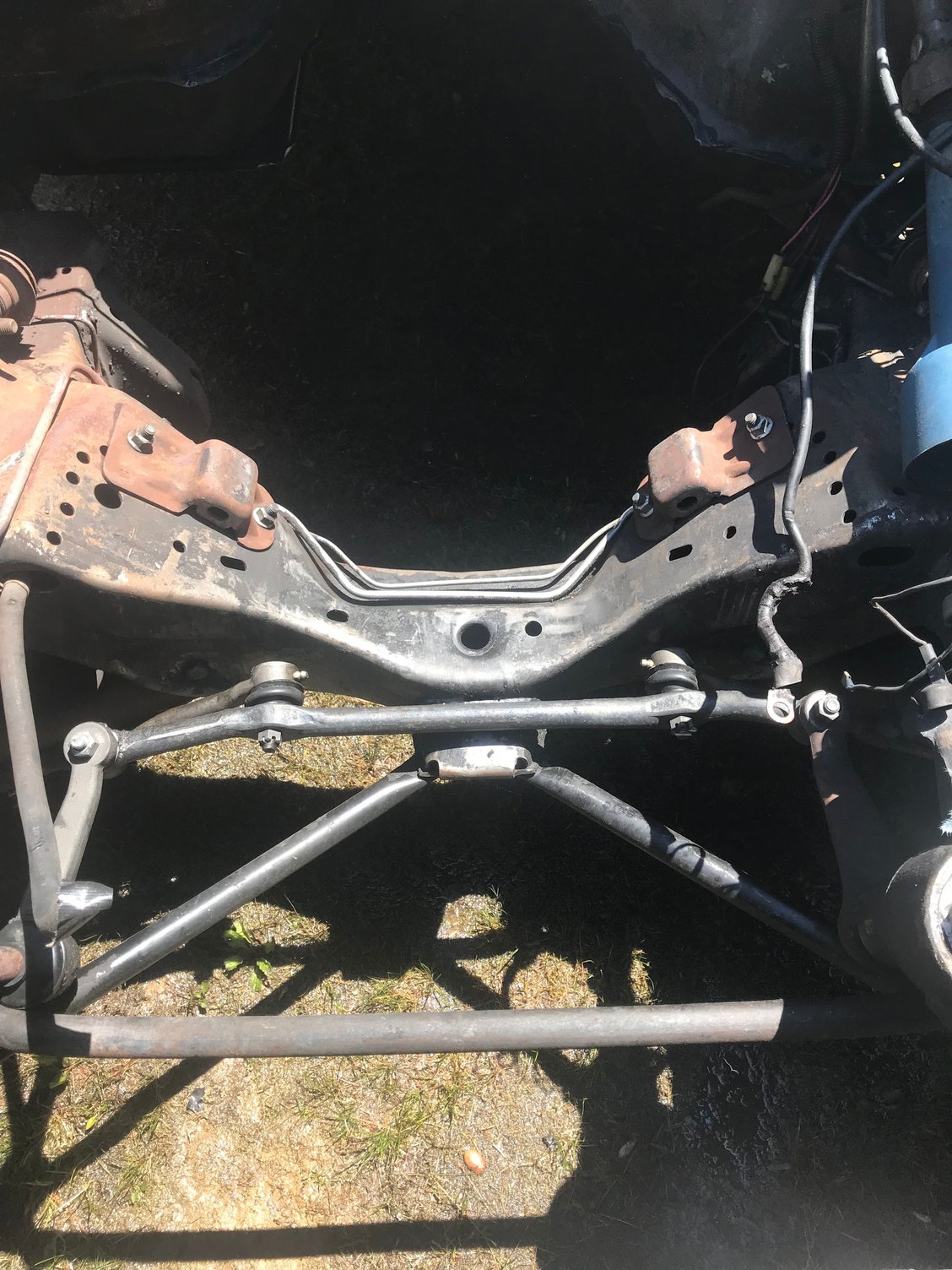

Yes they were the 2328 mounts I got them from rock auto

my frame pads . I’m pretty sure the motor is sitting where it needs to . Just a matter of minimal clearance with the performer intake . Question , is there a test I can do to figure out if my air cleaner is restricting flow ?
