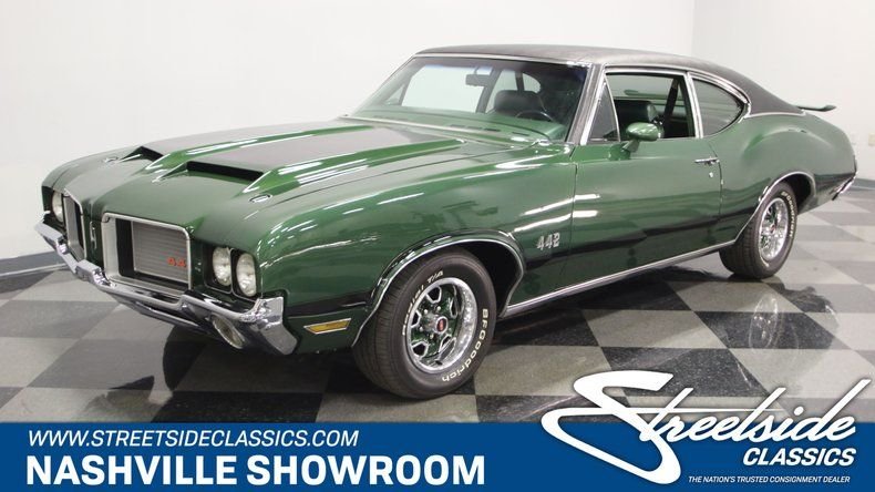

There were 4,141 Cutlass S Sport Coupes built in the 1972 model year. I don't have the numbers for how many came with the 442 option from the factory, but today pretty much all of them are now Faux Four Twos. For example, this one is a fake. The stainless trim on the rockers was included with the Cutlass S but was specifically deleted if the W29 442 option was selected. Also the wing was not available in the 1972 model year. While the fiberglass hood was an available option, the fakeness of this car suggests it too is a repro.
