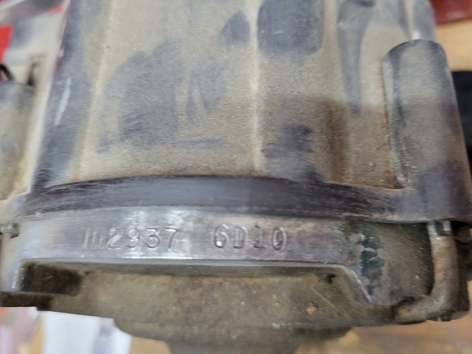

Need help with the codes on this so I can figure out what it came out of. Thanks guys.

This site shows 1976 Olds 455 engine.
http://www.gmpartswiki.com/getpage?pageid=179599
And the Olds wiki says 1975 455 engine as well:
http://theoldsfaq.outrightolds.com/ofign.html

Thank you. Not what I thought it was but at least from a 455.

Sure thing. My 350 is sporting an HEI distributor from a 1977-1979 403 engine.
Since the distributor is interchangeable between all second generation Olds engines, all you need to do is tailor the initial advance, the mechanical advance, and the vacuum advance for your specific application.
