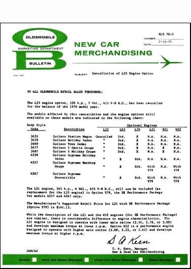

The SX was dropped in 1972 because the 455 became available in any Supreme that year. For 1970-71, the L33 2bbl 455 was only offered in Cutlii until it was cancelled in Feb 1970. For the rest of the 70 model year and all of 71, the 350 was the only engine option except with the SX package.

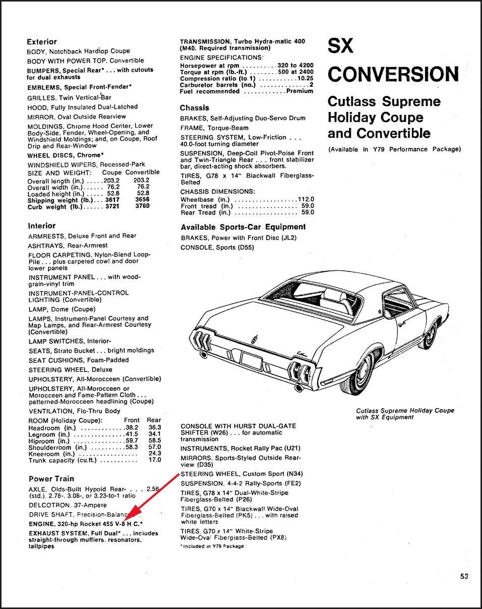

Generally, besides the engine, the only difference aside from badging would have been fender braces on hardtops, and cutout bumpers with trumpets with W&Z manifolds as standard equipment. SX cars often had a lot of the “fun stuff” found on the 344 variants, but not always. I’ve seen non console, bench, tan on brown with hubcaps. (Very Jim Rockford inspired) Most had very tall gear sets and standard 2 barrel carburetor.

All 1969-72 Olds A-body cars with 455s got W/Z manifolds. Supreme, Vista, whatever. Supreme 2drs came with bucket seats as standard equipment since the 1967 model year. The A65 sport bench seat with armrest was an option. The console was an option. The floor shifter was an option. Good point on the cutout back bumper and trumpets, however.

From above:
For the beginning of the 1970 model year the L33 320 HP 2bbl 455 was available in lesser Cutlii (Jerry Wilson of OCA had his L33 Cutlass at the Dayton OCA Nationals). It was discontinued on Feb 24, 1970. There were no 455s available in 1971 Cutlii expect in Vistas, SX cars, or 442s.

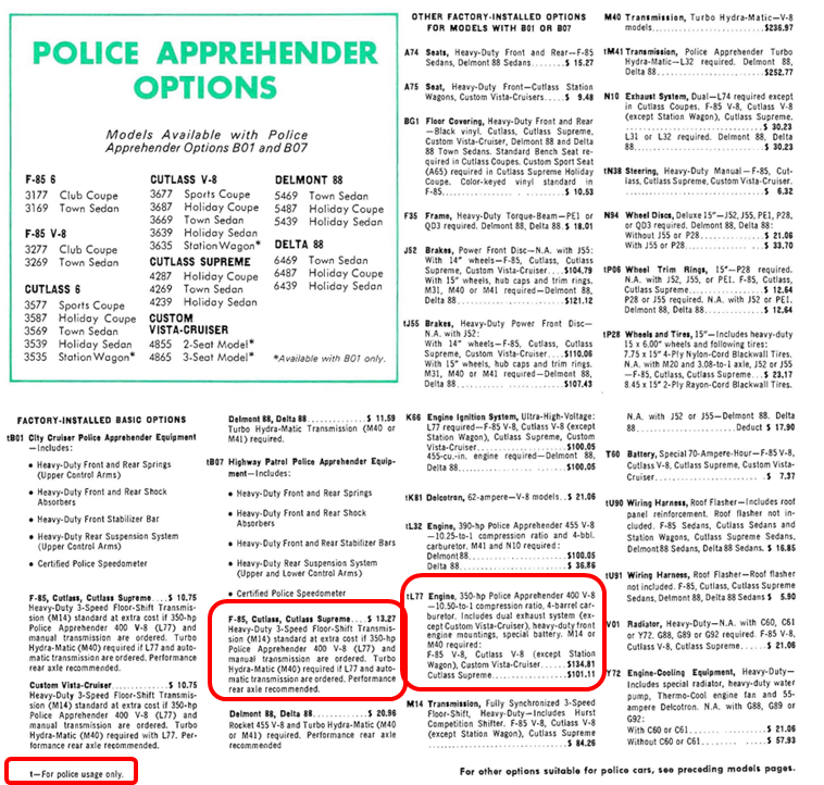

Same as it is in every world - getting stuff that isn't on the order form. The example I like to use is the 1968 Cutlass S that Motor Trend tested that had the L77 400 Police Apprehender package. The big block wasn't factory-available to the public in the Cutlass line in 1968, but it WAS an option to police agencies (who were supposedly the only authorized buyers). Kind if like the 9C1 Nova package in the late 1970s, the B07 package with L77 was basically a 442 in Cutlass clothing. With the right salesman connections, one could order this. Note, by the way, that the L77 was the 350 HP manual trans version, not the 325 HP AT version.

Good answer. So, basically, it was stuff that was there, but not available to normal people, usually.
That would have been an interesting sleeper, the 68 S with the MT 442 powertrain.
