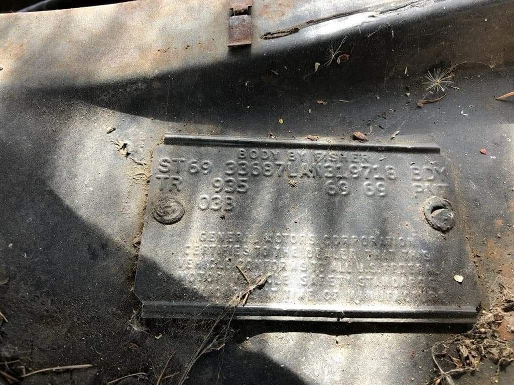

Hey guys any help on this tag would help. Any way to tell if this is a factory 4 speed car?

Look at the trans ID numbers. It should have the VIN derivative on it if OEM. Of course, it could have been swapped out even if it was originally a 4speed. Look at all the linkage and the hole cut into the floor.
Original paperwork is usually definitive.
ST69 = 1969
33687 = is Cutlass S holiday coupe
3 = Oldsmobile division
36 = Cutlass S Note: This can also be the tag numbers on a legit 442 for 1968 and 1969.
87 = Holiday Coupe 2 door HT
LAN = Lansing plant. So paperwork inside the car is not likely.
319718 = the consecutive build number of the body at Fisher
TR935= Dark red gut buckets
69 69 = roof and body-color, platinum silver
033???
Very desirable color combo IMO.

Nothing on that tag will tell you anything about the drivetrain.
Old Feb 16, 2020 | 12:10 PM
033???
That's 03B, built second week of March, 1969

Thanks guys for all info. Got some off line but not all . any way this could be a 442? Painted 442 decals on bottom of car. But cutlass emblem and no cut outs on bumper. But claims to be factory 4 speed. Sad part motor long gone and a 400 Pontiac in its place. Can't load link but it is at facebook market place colorado springs

Can't tell from the cowl tag, since Olds used Cutlass cowl tags on 68 and 69 442s. Post the VIN, that will tell you for sure. Lots of Cutlii came with four speeds.

No 69s came with painted or applied decal type 442 callouts on the body. A 1976 or 77 would have that along the bottom. Like Joe suggest the VIN will solve it. 344 as the first 3 characters = 442, anything else is Cutlass or F85.
WIth a Pontiac hacked into it the value is quite a bit less than a Cut or 442. If the body/frame is super clean then it's a nice base for a resto or driver.
