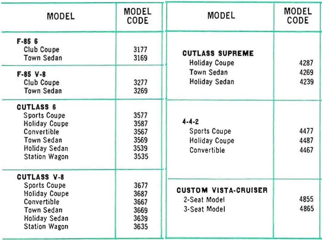

In the 1969 model year, the Cutlass S and Supreme were the same basic car. Differences were in the standard equipment that was included in the base price, the upholstery pattern, and the trim. These two pages from the SPECS booklet list the standard equipment and options for each. Note, by the way, that the Cutlass S was only offered in two door versions - the more doors were called Cutlass (despite having the same model numbers in the VIN). The Supreme came in both two and four door versions. Also note that the Cutlass and Cutlass S were available with the I6; Supremes were only available with the V8. And while the L74 4bbl 350 was standard in the Supreme, the L65 2bbl 350 was also available. The three speed column shifted manual trans was base equipment for both lines. Also note standard and optional drivetrain availability.

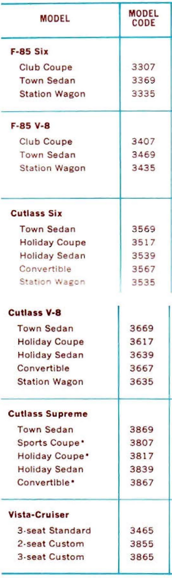

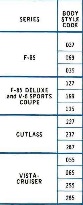

The three-level marketing concept was (and remains) common in the industry. Olds nameplates underwent "grade inflation" over the years. Even back with the Y-body cars in 1961, Olds offered the F85, F85 Deluxe, and Cutlass trim levels. In 1964, the 30xx cars were F85s, the 31xx were F85 Deluxe, and the 32xx were Cutlass. Note that the Vista was a 30xx F85 and the Custom Vista was a 32xx Cutlass trim level. (The leading "3" is left off on this chart).
For 1967 this became the F85 (33xx/34xx), Cutlass (35xx/36xx) and Cutlass Supreme (38xx). Again note two versions of the Vista, one base with F85 trim and one custom with Supreme trim.

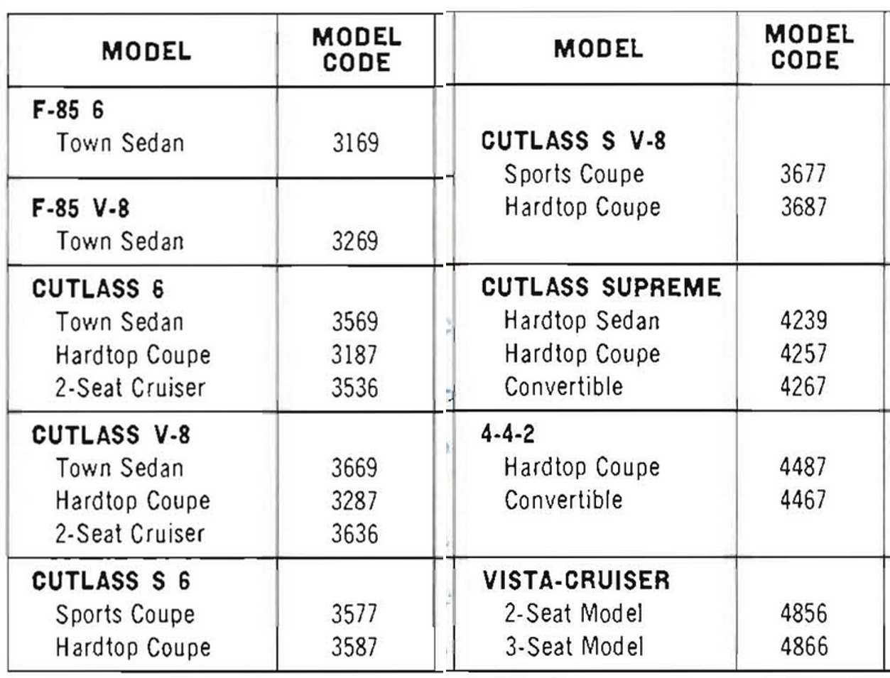

1968 continued with F85 (31xx/32xx), Cutlass (with or without "S") (35xx/36xx), and Supreme (42xx). Note that the "S" was only used to refer to 2 doors, the sans-"S" to 4 doors and wagons, but both retained the same model code 35xx/36xx, depending on I6 of V8. And note that this is the first time that the Vista also has it's own model line (same as the 442 that year) and the low-rent Vista was dropped.
1971 brought a new wrinkle, were the 31xx/32xx models were called F85 if it was a 4door but Cutlass (no "S") if it was a 2 door. The 35xx/36xx cars were called Cutlass as a 4 door/wagon and Cutlass S as a 2 door. Supremes were still 42xx. The names are really irrelevant. It's the model line code that matters.
