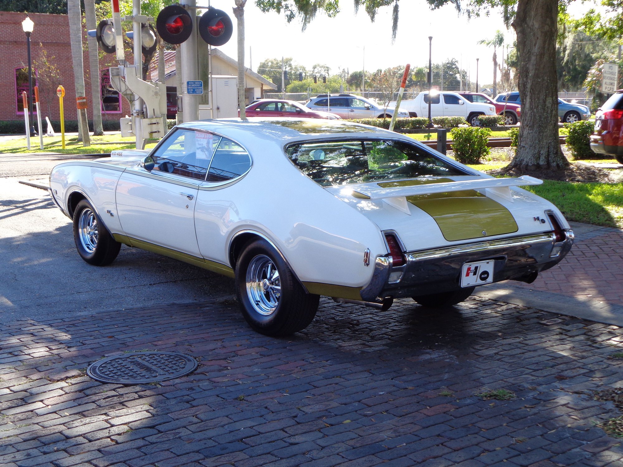

100% correct. These have been on my Chevelle for 22 years, they don't have a spot of rust or any peeling. You have to take care of them. Get the correct size, you will be much happier.
File Type: jpeg
