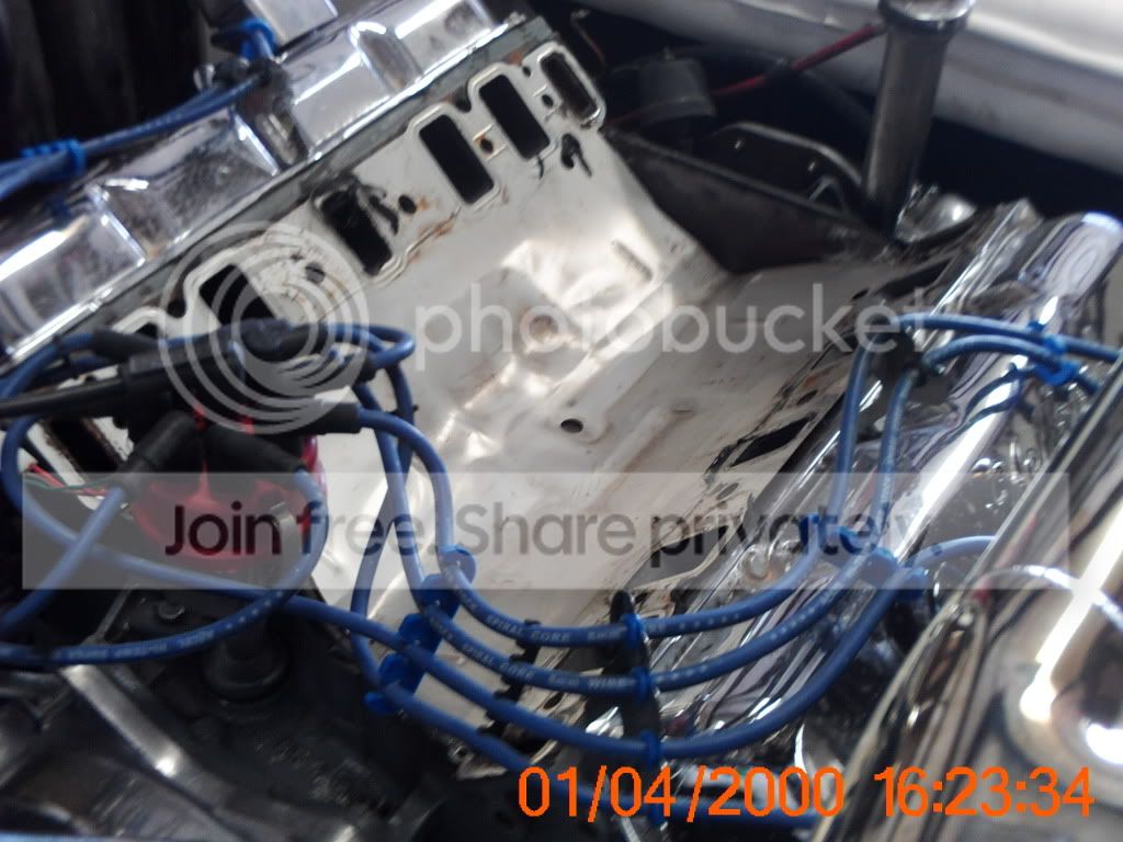

that's the "turkey pan" style gasket. Yes, it covers the entire valley between the heads. and then the intake rests down on top of it.
Don't forget to use the black rubber/neoprene end gaskets too. Not a bad design. Once it's set in place, it pretty much stays there and won't move. I've seen the other ones shift a little during installation causing an intake leak on other engines.
Image here for reference.
http://i980.photobucket.com/albums/a.../PICT00051.jpg
-Jeff

So the entire "turkey pan" goes into the valley, and then the neoprene ends seal the manifold ends...While looking at the front of my engine, I noticed the end seal was half off the machined surface, thus making me buy the intake set to correct it. Thanks for the timely info, and also the great picture.. Man, you guys on this site are super!!! I belong to other sites but this one is great.. Thanks.
