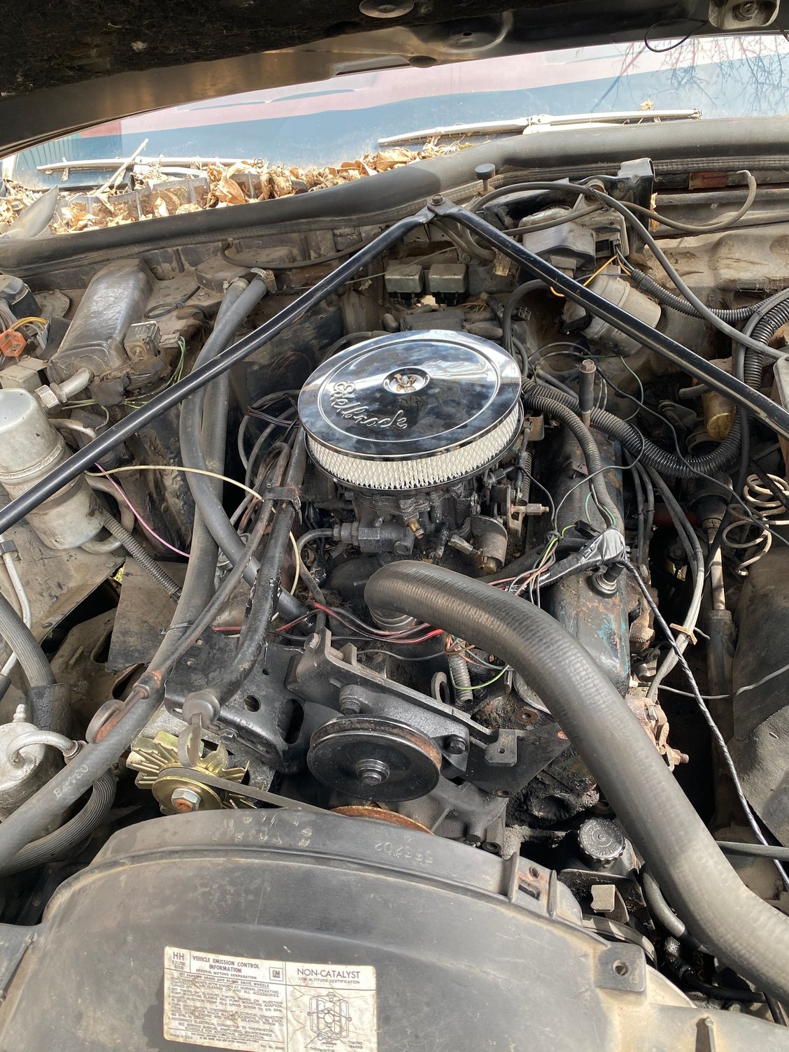

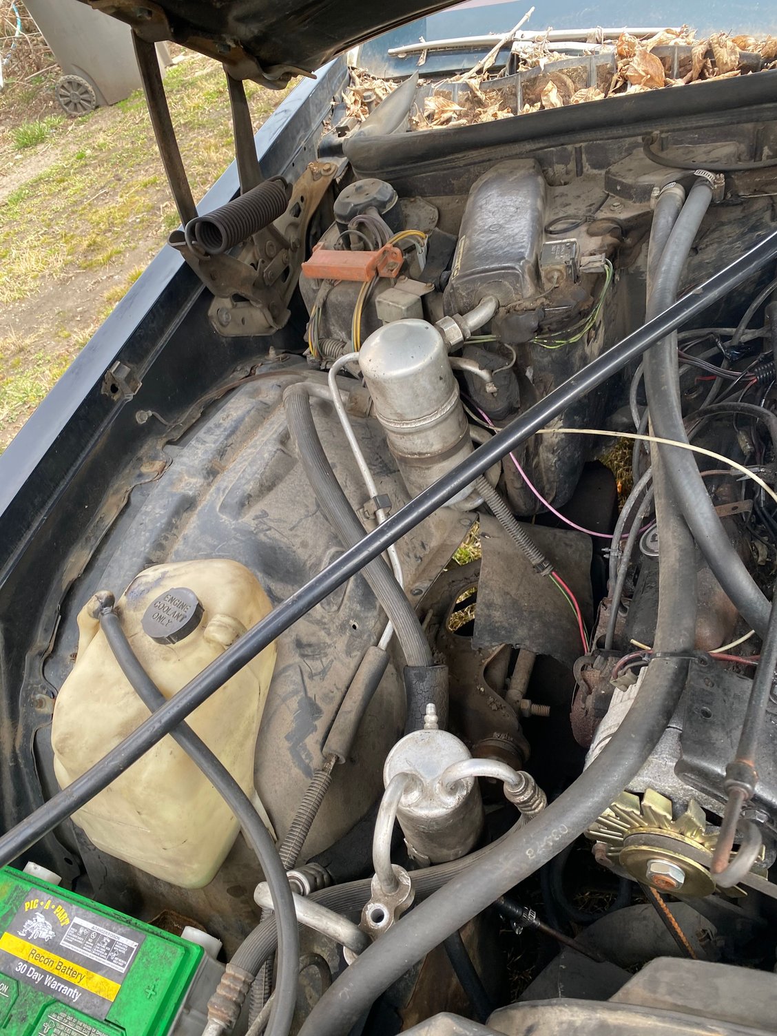

Clean engine bay
Hi all. I am wanting to know if anyone can give me any help I am wanting to clean my engine bay up a bit and reduce some weight and eye sore Can anyone let me know what parts are not mandatory? Thanks 78 delta 88

Warm soapy water and a few different sizes of paint brush to scrub, scrub, scrub. If you take parts off and the engine stops running, you went too far.

You could get rid of the Chevy motor to start

Simple Green works well also. X2 on the Chevy engine. 😁

Looks like he would save 15 pounds by swapping the SBC for an Olds 350. That would be an expensive 15 pounds.

If you're talking get rid of unnecessary stuff, only thing I see that can go is the extra Diesel battery at passenger side front.
Sure you can get rid of AC and cruise, but at the sacrifice of some creature comforts.
The orange ALDL connectors are tied into the car wiring and removal will create all kinds of problems unless removed with near surgical precision.
Any engine degreaser will clean off the grunge especially if you have a pressure washer. Straight blue Dawn dish soap and a scrub brush to get really heavy grease off.

J's car was a Diesel that got converted. I'd rather see an Olds 350 in there too but not gonna knock the Chev lump.

I see what youre saying, i dont recognize some of those components so im glad raider chimed in, but i would guess anything diesel that isnt needed can be removed, many times ac can be taken out and different accesory brackets are used to offera cleaner look to.
At least some of us are not familiar w that engine so it would help to id it. I know summit and jegs etc sell acessory brackets and dress up kits for chevys so that may be a good place to get ideas too.
for a good start tho i would clean up the leaves and sticks etc under the hood not only does that trap moisture and encourage corrosion it can facilitate water leaks and mold and smell. After that as metioned i would clean up all the stuff you have like the fender wells and other parts that are just dirty.
