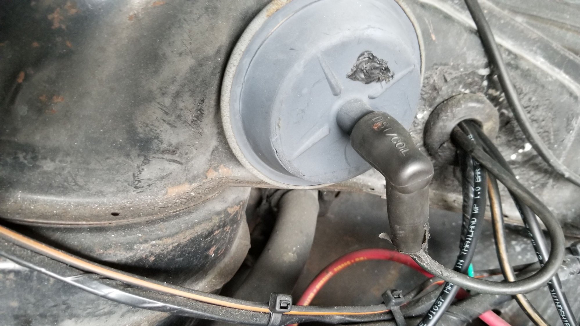

can anyone make sense of what the PO did to my A/C?
From the schematic I have, there are two vac lines coming from the control panel that go into this thing. Looks like someone stuck a distributor wire boot on one with RTV, and I think the other was piped into the vacuum canister. I need a new one of these vaccum actuators (?) because it's cracked all around the edges. What is this part called? Can I buy another one? How hard is it to install?

Looks like a heater/AC vent door actuator. Exactly what car do you have?

Could it be this one: https://www.ebay.com/itm/1964-1965-1...kAAOxyQj9ROzY4
Much better price: https://www.opgi.com/cutlass/C241274...xoCSYkQAvD_BwE
