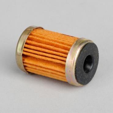

Toss the Morain sintered brass type integral(carb mounted) filter the web page says it comes with, in favor of a paper element, the short GM paper filter, (it should fit, see pic). Pull the rubber valve out of it before installation.
The Morain style filter could be plugged up but letting just enough fuel by to start, idle and run until a greater demand it summoned. They are well known for this.
https://www.holley.com/products/fuel.../parts/162-500
^^^^^^^^^^^^^JUNK IMO^^^^^^^^^^

Ya agreed not fun not trusting your ride. Whatever it is it's likely it didn't self heal.
If it was me I'd pull the carb down for a look but I can do carbs in my sleep and I'm not ever satisfied until I solve the problem(I'm sure you can relate).
Check that inlet filter at minimum. That's basic quick n easy.
What Id suggest is make a list of troubleshooting steps from this email chain 1-10, most important to least.
Have some spare parts on hand, Fender covers, RTV, rags, hand cleaner, coveralls etc...the usual roadside bag of tricks. Put all of this and a well-equipped road box in the trunk with a makeshift creeper and drive it. If it occurs out on the road you'll be prepared with hopefully the right info and tools to find it and get it home. All this will at least make you feel better.
I run with one of those modern manual type bottle jacks with a folding crank handle too. Never use a bumper jack for safety and cosmetics on the bumpers.
Make sure you have FLATBED towing service on your insurance or AAA policies. Don't want anyone hooking an old school wrecker to a 68-69 bumper. (any bumper for that matter).
