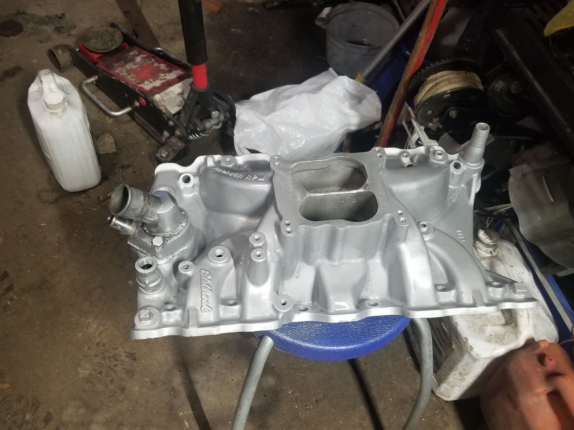

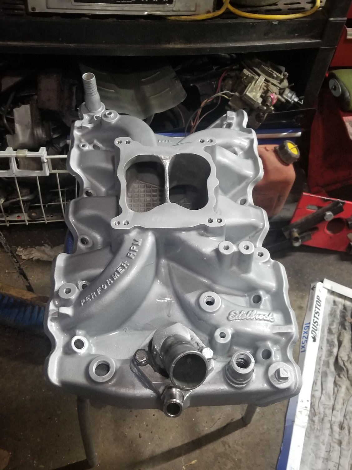

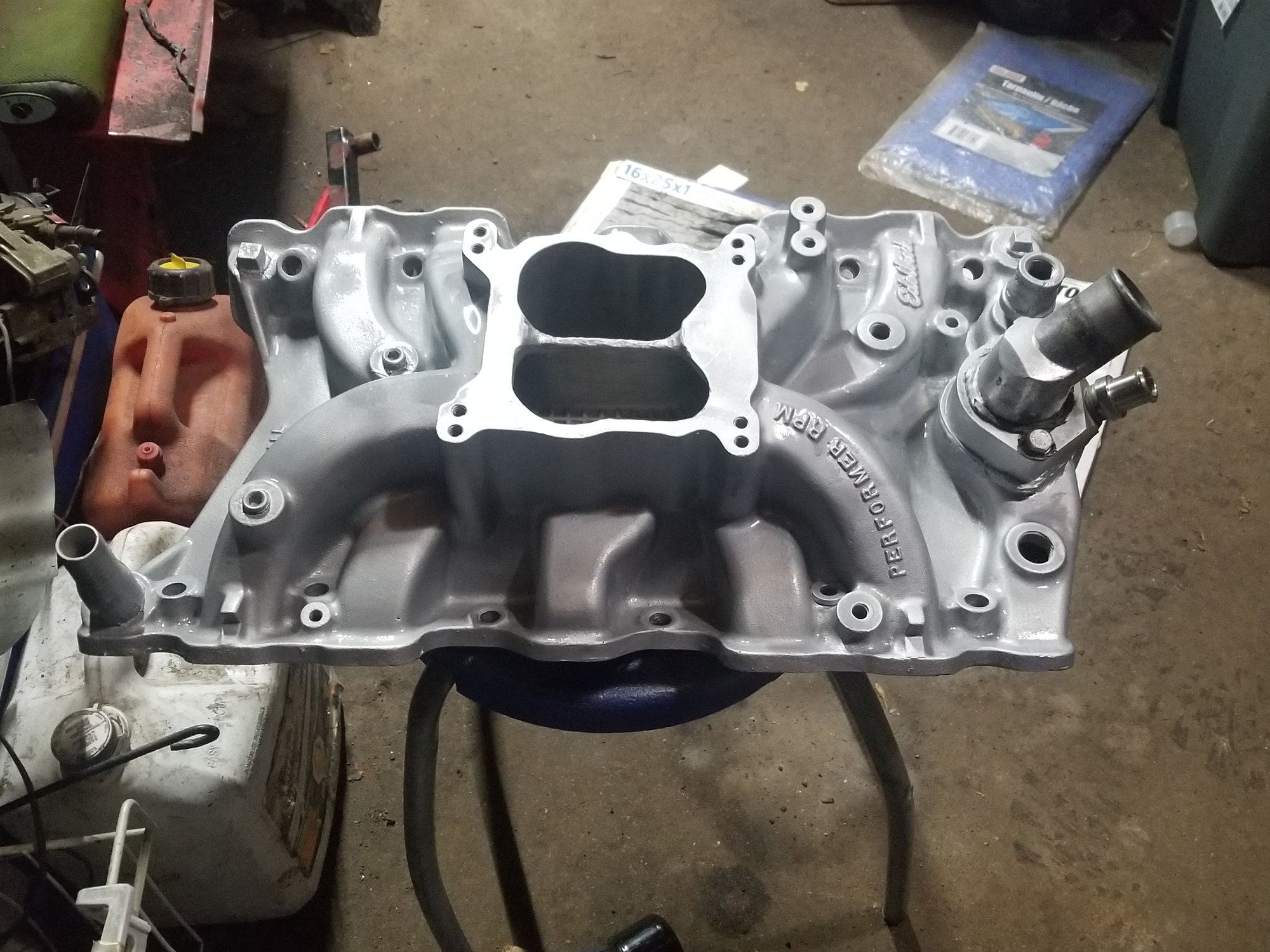

I used the glass, it took about 8 hoppers worth. It flies everywhere compared to the aluminum oxide. This was the final outcome. I am going to paint it with VHT high temp aluminum.

With some VHT high temp aluminum.

Turned out good

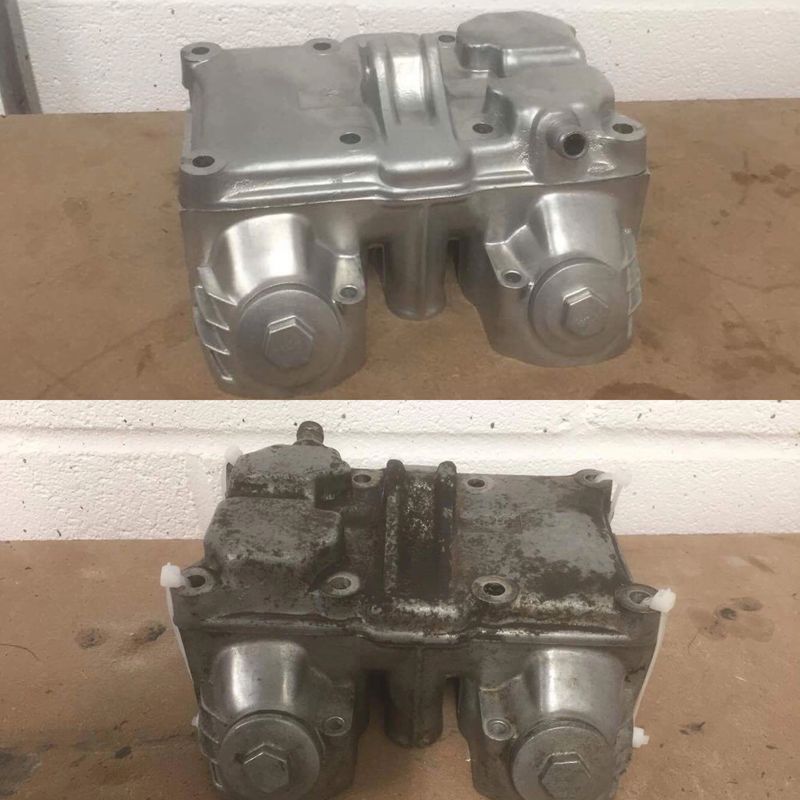

Soda blasting aluminum parts look the best. A lot of guys use it on old aluminum motorcycle and snowmobile motors.

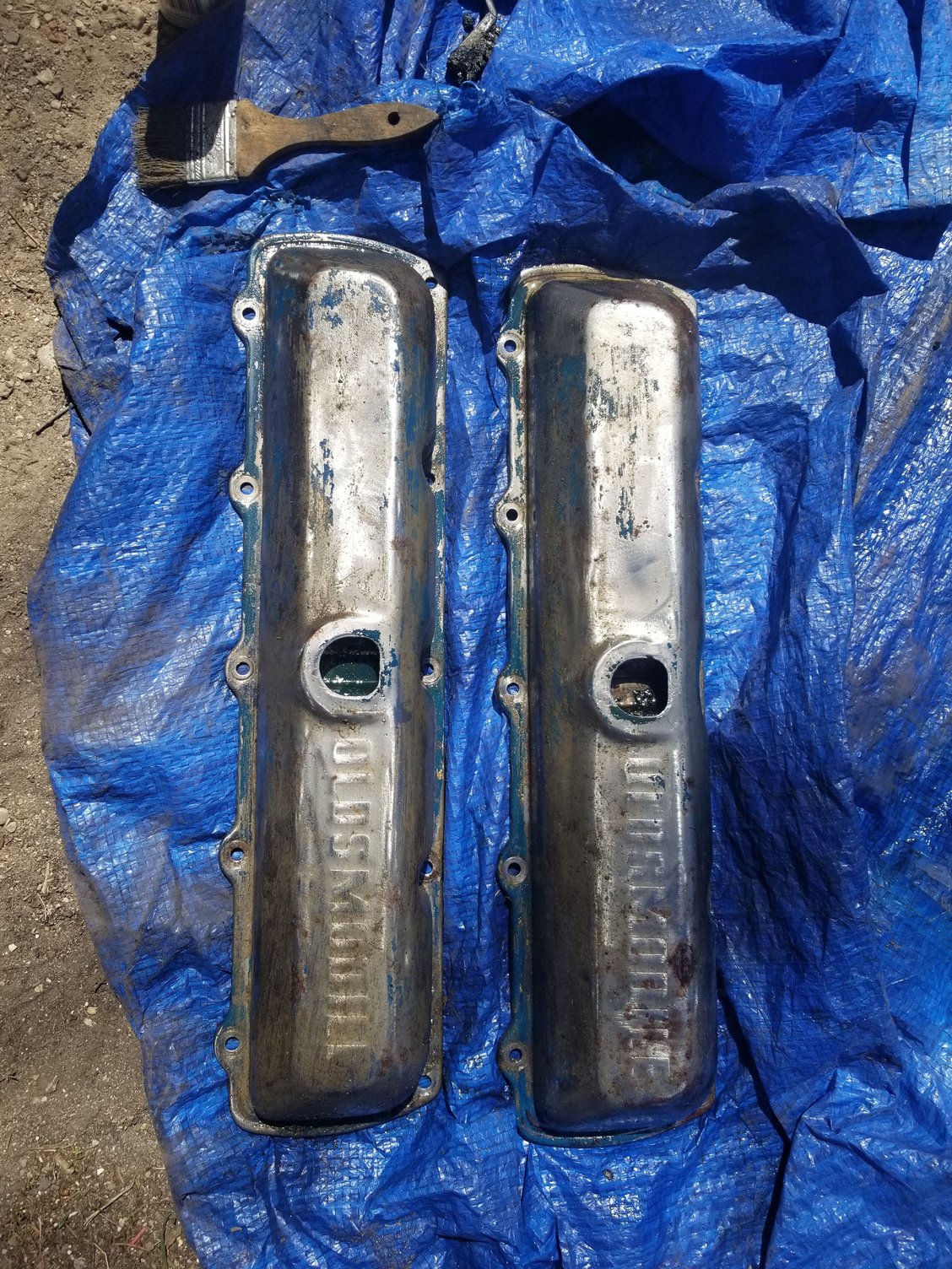

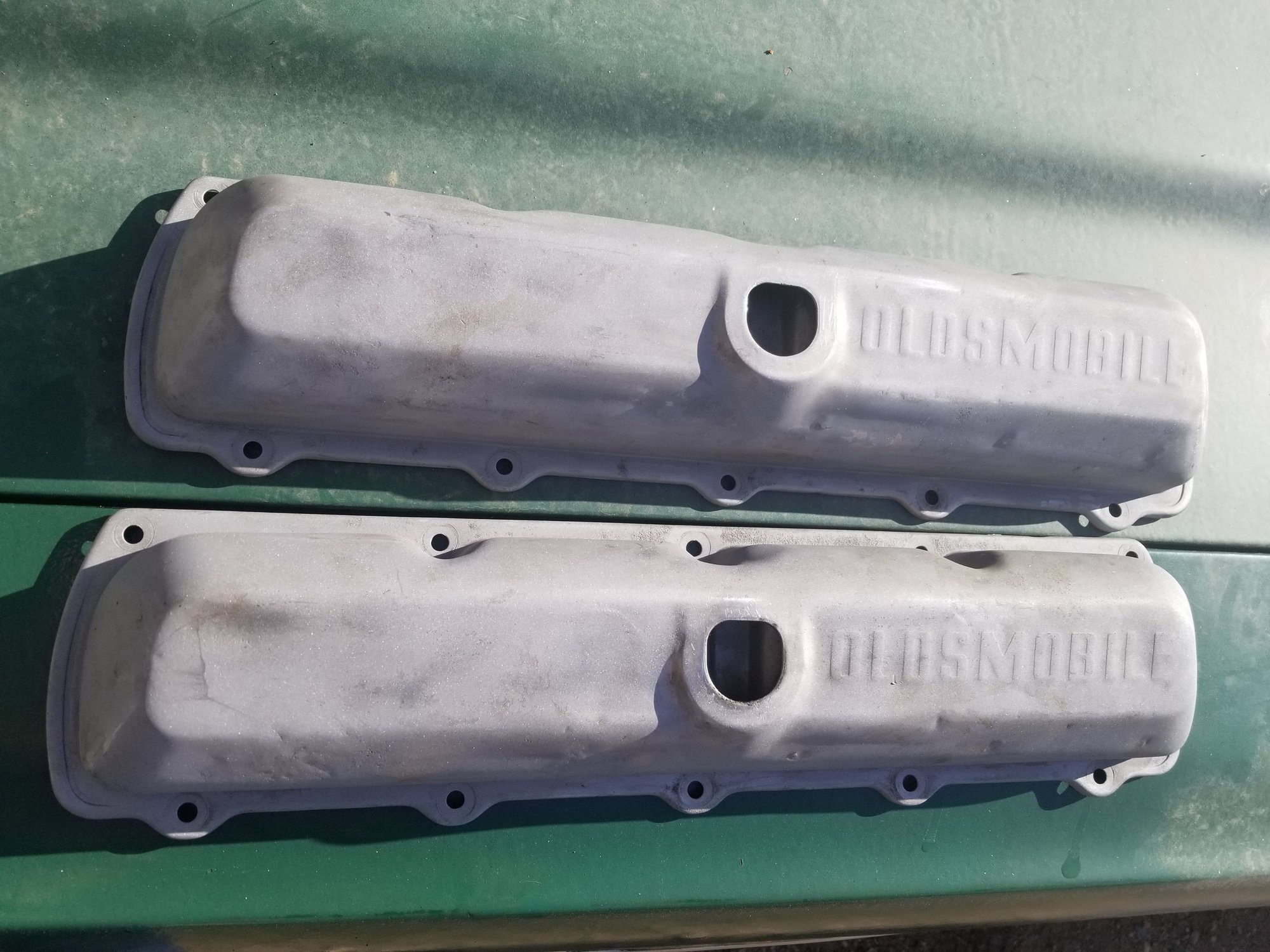

And 73 valve covers!
