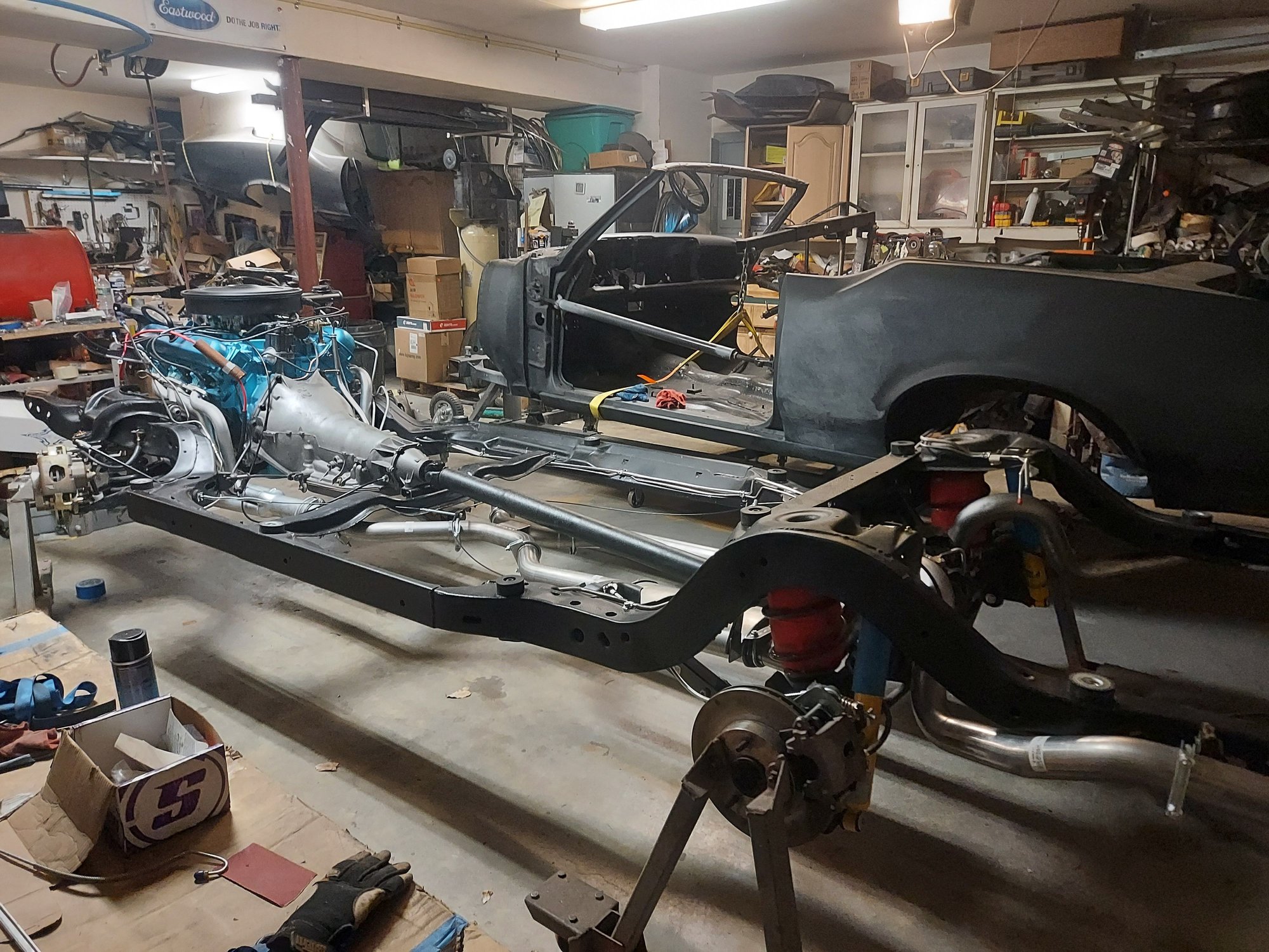

Before I put the body on
Old Dec 30, 2021 | 06:02 PM
tkcutlass's Avatar
Joined: Jan 2020
Posts: 1,277
From: CT
I should install:
Suspension
Fuel lines
Brake lines
Parking brake cable.
Torque to spec
Everything except:
Control arm bushings
Steering/ ball joints etc?
Engine?
Transmission?
Drive Shaft?

Personally I would do every single thing you can before you drop the body. So so much easier. Just do it right. I know you will. So much easier to put all that in while you have nothing in the way. Then you can drop the body down and you are set.

Do every thing you can that doesnt reqire the body to be in place.

Fuel and brake lines, and rear suspension. The rest after the body is on and some after the engine and transmission is installed.

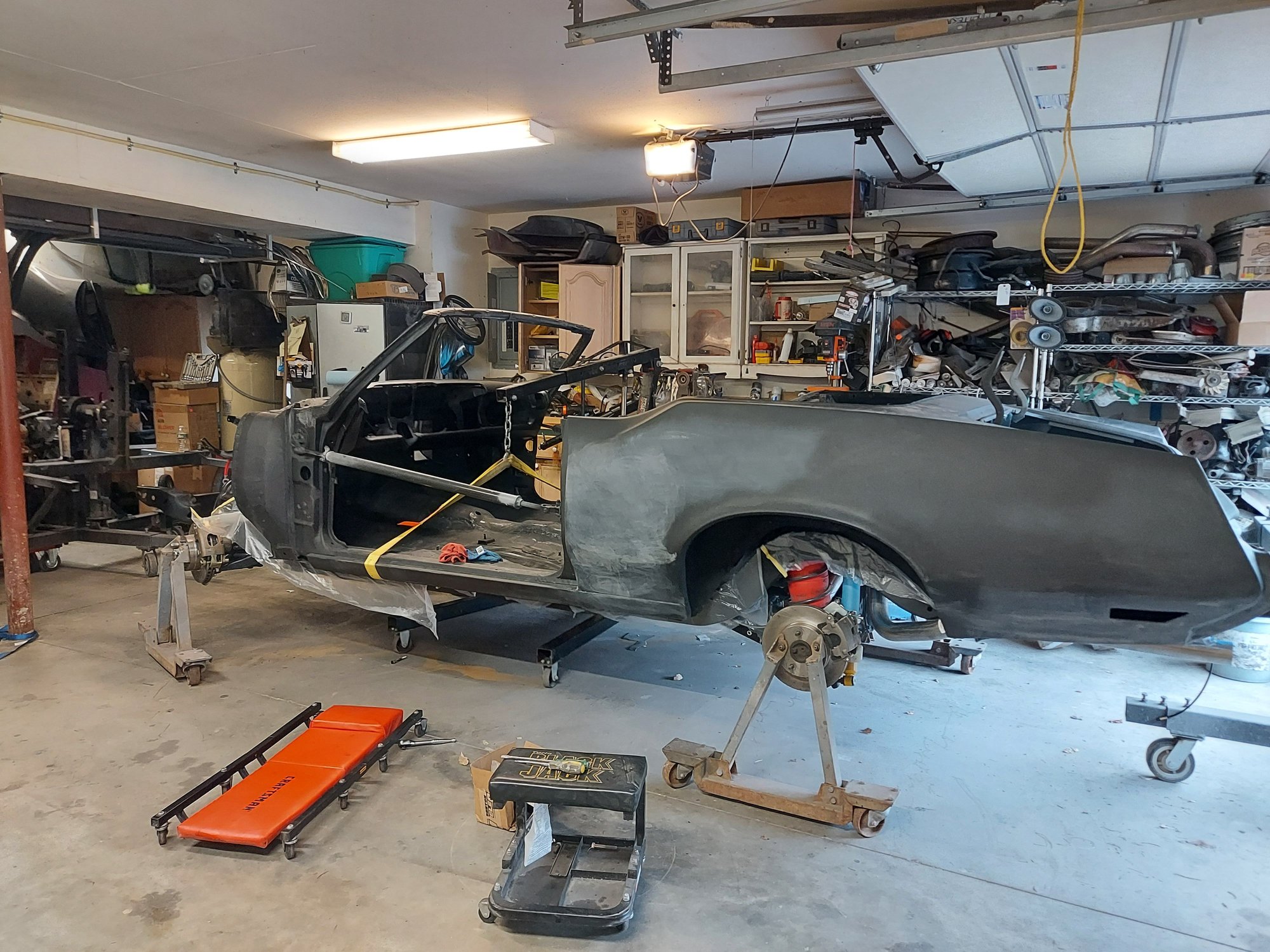

Old Dec 31, 2021 | 08:30 AM
tkcutlass's Avatar
Joined: Jan 2020
Posts: 1,277
From: CT
What a nice way to do it, I love those dollies, do they work with the full weight of the car? Neat!
Yes, the dollies work with the full weight, an old-timer let me borrow them, gonna try to buy them off him.
Decent working height. without tires in the way.

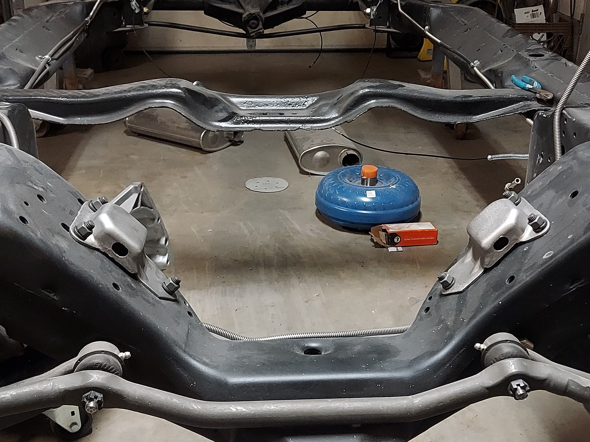

Put the metal motor pads back on the frame while the arms are out or else it'll be a bit more difficult to maneuver. As others have mentioned, put the engine, trans, driveshaft, brake lines, fuel lines, exhaust, etc. back in before the body. I'd recommend the e-brake cables, too. Loosen the suspension at the front and leave it that way for now; do not torque the suspension until you have all the weight. I'd also double check your spring location to ensure everything is seated properly. Good luck.

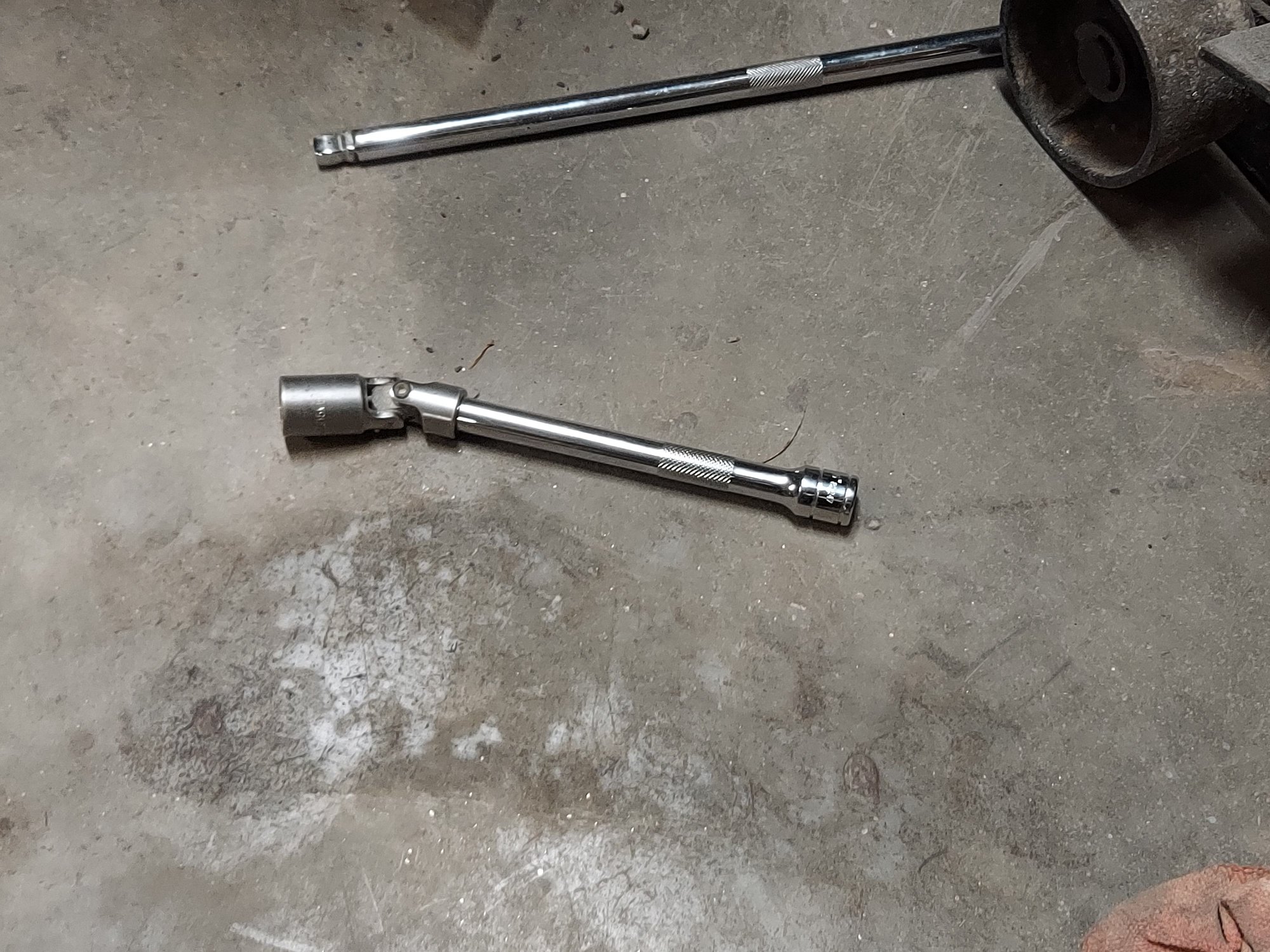

I already had the control arms and springs installed before installing the engine mounting pads.
I managed to get them in with the use of a universal joint socket wasn't too bad less than a half-hour to get all six bolts in.
The bolt kit I got did not have the flat washers that the assembly manual shows.
Is that going to be a problem not having them?

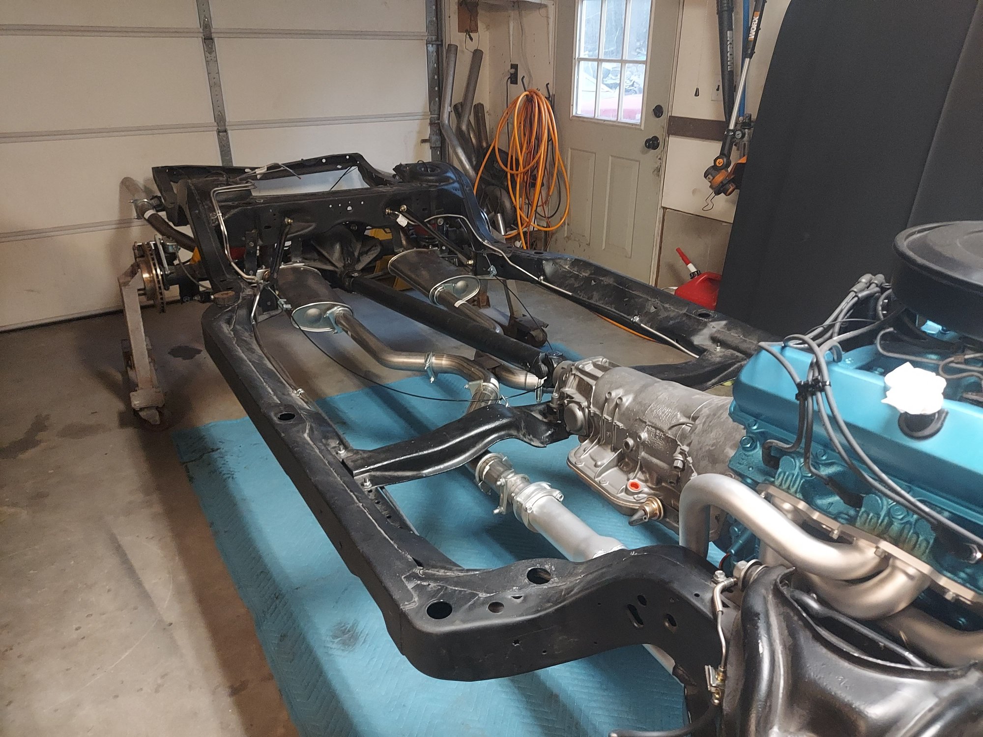

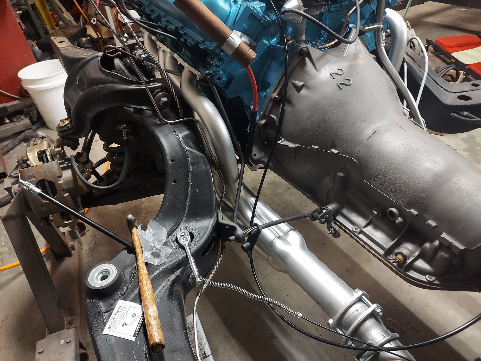

Exhaust and engine are in.
Not sure how much else is best to do before I put the body on.
Old Mar 26, 2022 | 03:29 PM
Loaded68W34's Avatar
Joined: Jul 2020
Posts: 1,942
From: Pennsylvania
A few suggestions:
Install trans dipstick tube
Install brake distribution block and brake lines that go up to the master cylinder
I know the engine is painted, but with factory A/C and Power Disc Brakes, installing BBO notched valve covers would be highly recommended

Install metal line for transmission modulator.
Transmission cooler lines.
Maybe battery tube and positive battery cable to starter.
Maybe speed-o cable
Lube all grease fittings.
Cotter pins in tie rod nuts.

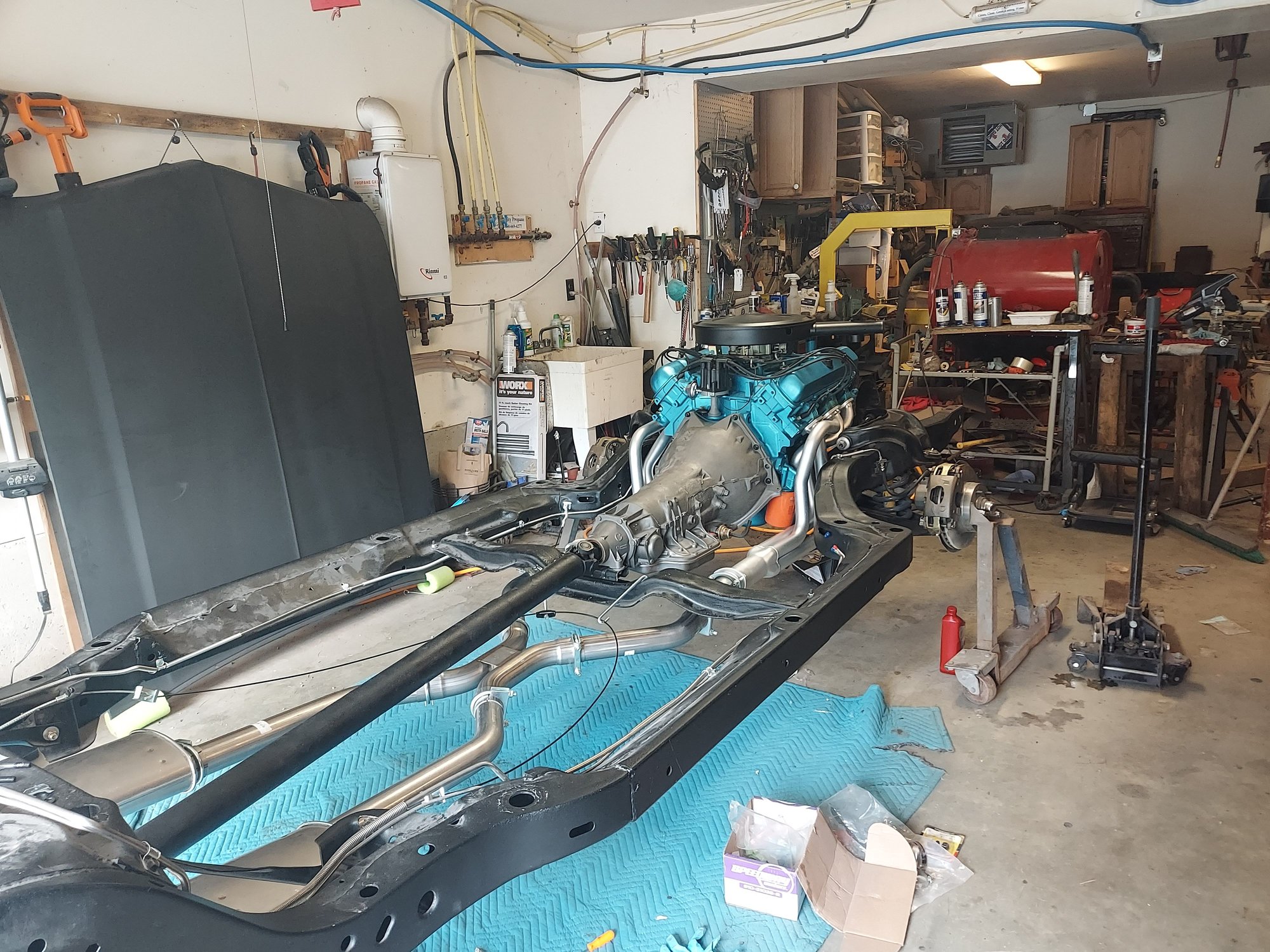

I think I got everything ready to put the body on.
Perhaps some transmission linkage and column lockout should be done first.

Personally, I like to fire them up and run them before the body is on. This way if there is a leak, you can fix it without having to lean over new fenders. This was mine

Tim,
what exhaust did you go with?
also I see new torque converter, any specs…
Old Apr 17, 2022 | 08:29 AM
tkcutlass's Avatar
Joined: Jan 2020
Posts: 1,277
From: CT
Originally Posted by herkguy
Tim,
Herkguy
Pypes PYPE-SGA42 for the exhaust.
1800 Stall converter.

Nice - a lot of good progress. It will be a great milestone once you re-unite the body with the frame!
You might want to try adjusting those transmission lines. I realize that the radiator side isn't hooked up but it looks like the lines are in contact with the headers in a couple of spots.
If you can't tweak them now make a note to take another look at them in the future when the body, fender well and radiator are installed.
Also make sure speedometer cable is routed away from the header once the body goes on.

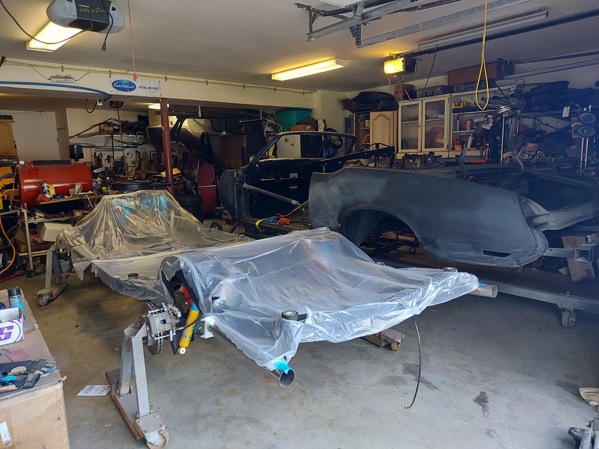

Perhaps consider paint masking right before you drop the body on like something over the frame with holes at the motor mounts that you can tear away after paint.

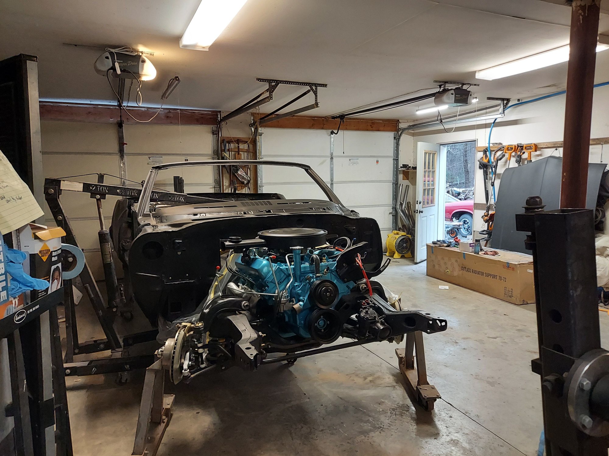

Well, the body is on!
I left the hoists in place in case I have to tweak it a little.
I stopped by autobody specialty and picked up some cage nuts.
probably easier to just use hex nuts on the front cowl.
