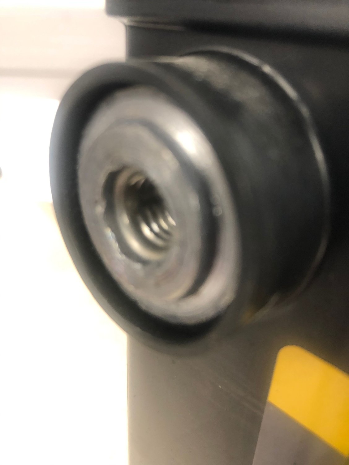

I bought a battery for my car last week, finally got some time to install it. I noticed the threads for the bolt are recessed fairly deep into the hole. So deep, there is at most 2-3 turns of thread engagement. I planned to returned that battery, only to find every battery is like that. Is this the way they are making them now?? I don’t remember the old battery being like this.

The terminal should have a circle extrusion that locates in the plastic hole for locating your bolt to the hole. It sort of sits in there, and you can hold it while you start the bolt. The front contour of the metal contact is a little weird on this one.
There is not a lot of threads in the hole, and they're coarse. It is quite easy to go from not tight, to barely holding in there, to too many threads on the bolt and you land on the bottom before the clamp force is there. Sometimes, a lock washer to back the bolt out a bit to avoid landing prematurely helps.

That’s my concern as well. The cables need to be tight enough to ensure good electrical connection, but with the soft lead batter posts, combined with limited thread engagement, it’s a fine line between tight enough and pulled threads.

I like to take the bolt out, put it in and bottom out without the terminal, and see how much there is between the bottom of the bolt head and the battery. That should be less than the thickness of the terminal, but not by much. If it's a lot less, the bolt's too short, and if it's more, you'll be loose; time for a washer.
