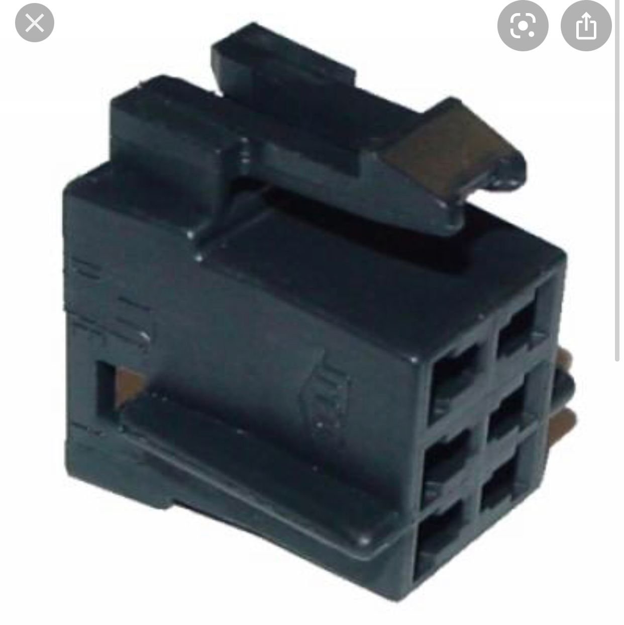

Problem #3: the connector for the drivers door switch won’t fit thru the factory conduit. I solved that problem by disassembling the connector, and removing the terminals. Once the wire is thru the conduit, I installed the terminals back into the connector and reassembled it. I’m thinking about installing a 8 way Metri-Pac 280 connector in the kick panel, that way if I ever need to remove a door, it’s easy to unplug, the connector body will fit thru the conduit, and that eliminates all the extra wire coiled up in the kick panel.
Something like this

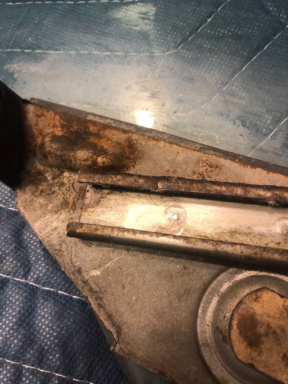

Problem #4, and by far the biggest problem, the quarter window rollers keep falling out of the track once the window goes up completely.
You can see where the roller from the original manual regulator stopped. With the window all the way up, the roller is almost completely out of the track. When you put the window down, the roller falls out, and am the glass slides down the window guide
I had this happen on the passenger side yesterday. I called Auto City Classic and explained the problem, I was told to slot the regulator mounting holes. I argued that if the parts are made correctly, I shouldn’t HAVE to make the car fit the parts.
I decided to try the drivers quarter window before modifying anything. Sure enough, exact same problem. It seems to me that either the regulator arm is too long, or the roller is too far back on the regulator arm. When I asked about that possibility, I was told that the arms are stamped to copy original parts, and they have been selling this kit for 20 years. If so, maybe their dies are worn out??
I told the tech advisor that their is no way the guys on the assembly line lovingly elongated and filed the cars to get these parts to fit. Seeing how far back the roller is positioned, I’d have to slot the holes a half inch.
Obviously, nothing is going to happen until Monday. My question: have I overlooked something?? Have I assembled something wrong? I’d like to make sure I have covered the obvious issues before bitching Monday morning. Until I get the regulator and window to stay together thru the full range of motion, I can’t adjust the glass. Right now, the bolts are tighten in the original position. That should be close enough I would think.

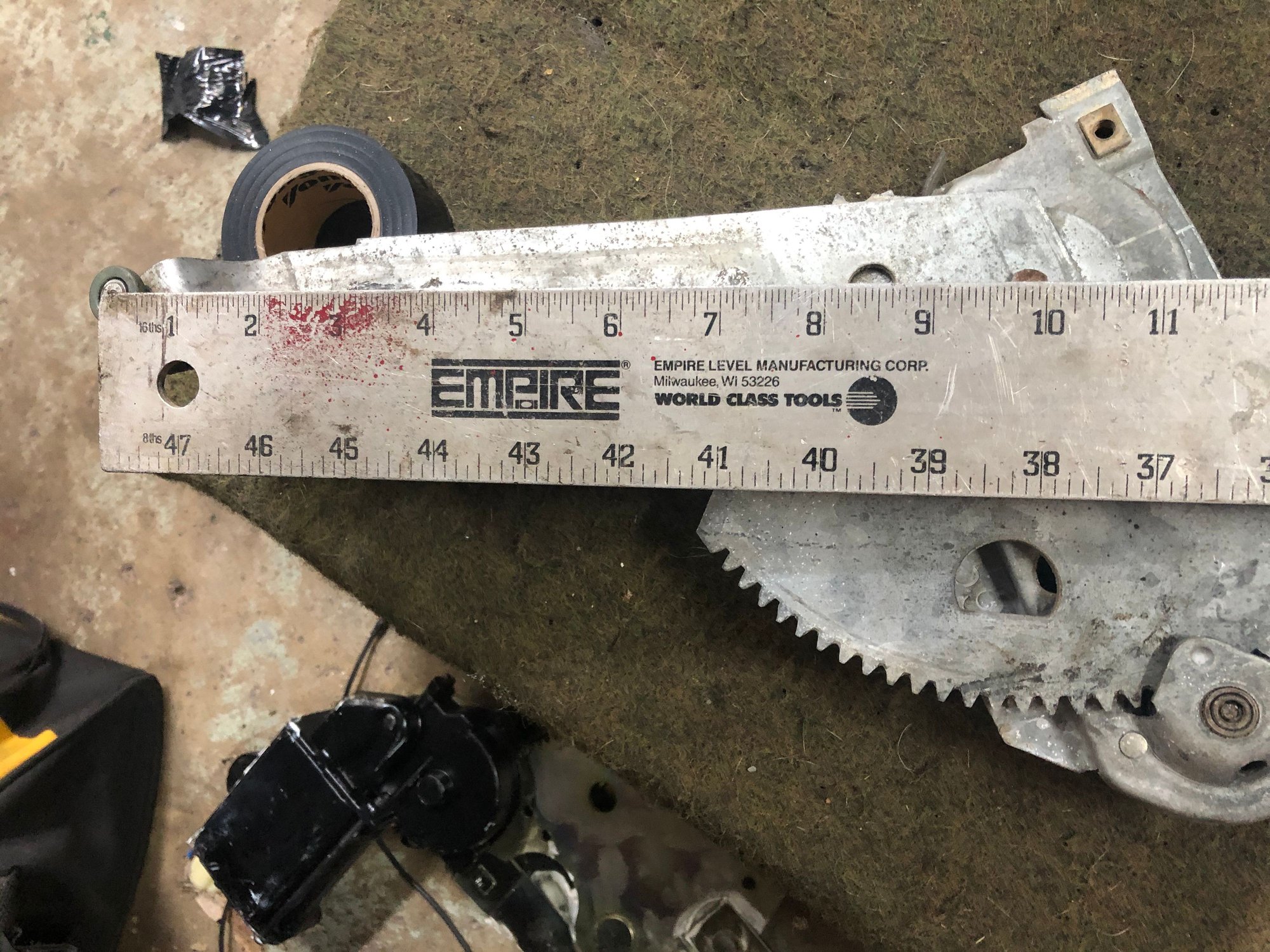

The arm on my convert regulator is 11 1/2" from the centre of the rivet to the centre of the roller. Might be able to get a hard-top measure tomorrow.

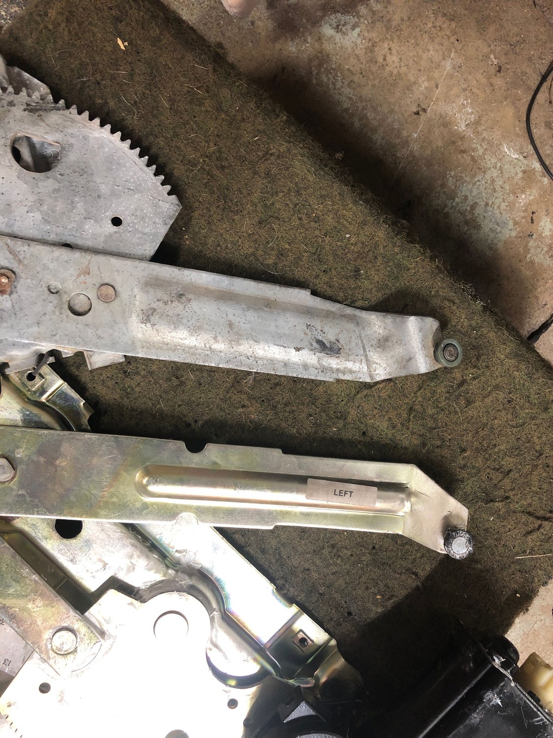

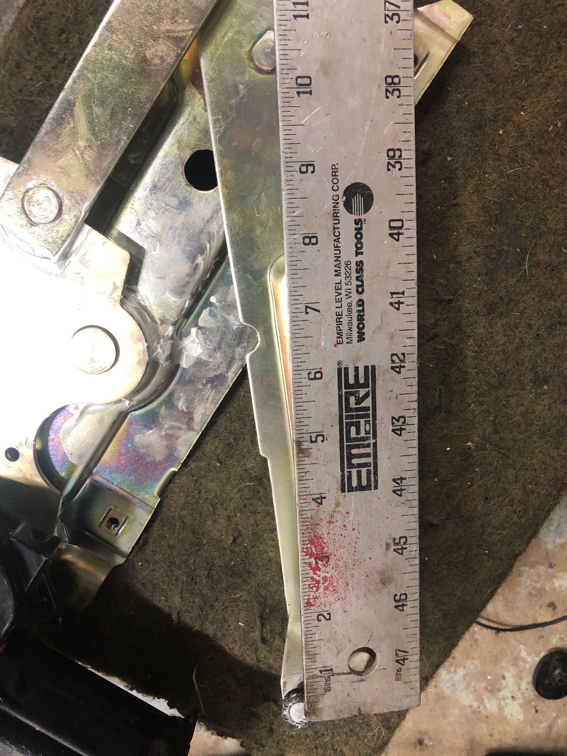

I removed the drivers side quarter regulator and compared it to the none power regulator. I’m guessing the pivot point for the lift arm would be identical between the 2, however I would appreciate it if someone has a 69 power window regulator to verify my measurements.
This is the power regulator. About 10.5 inches from the center of the pivot, to the center of the roller.
Non power regulator. About 9 3/4 inches from center to center.
Here are the 2 regulators side by side. Definitely a difference

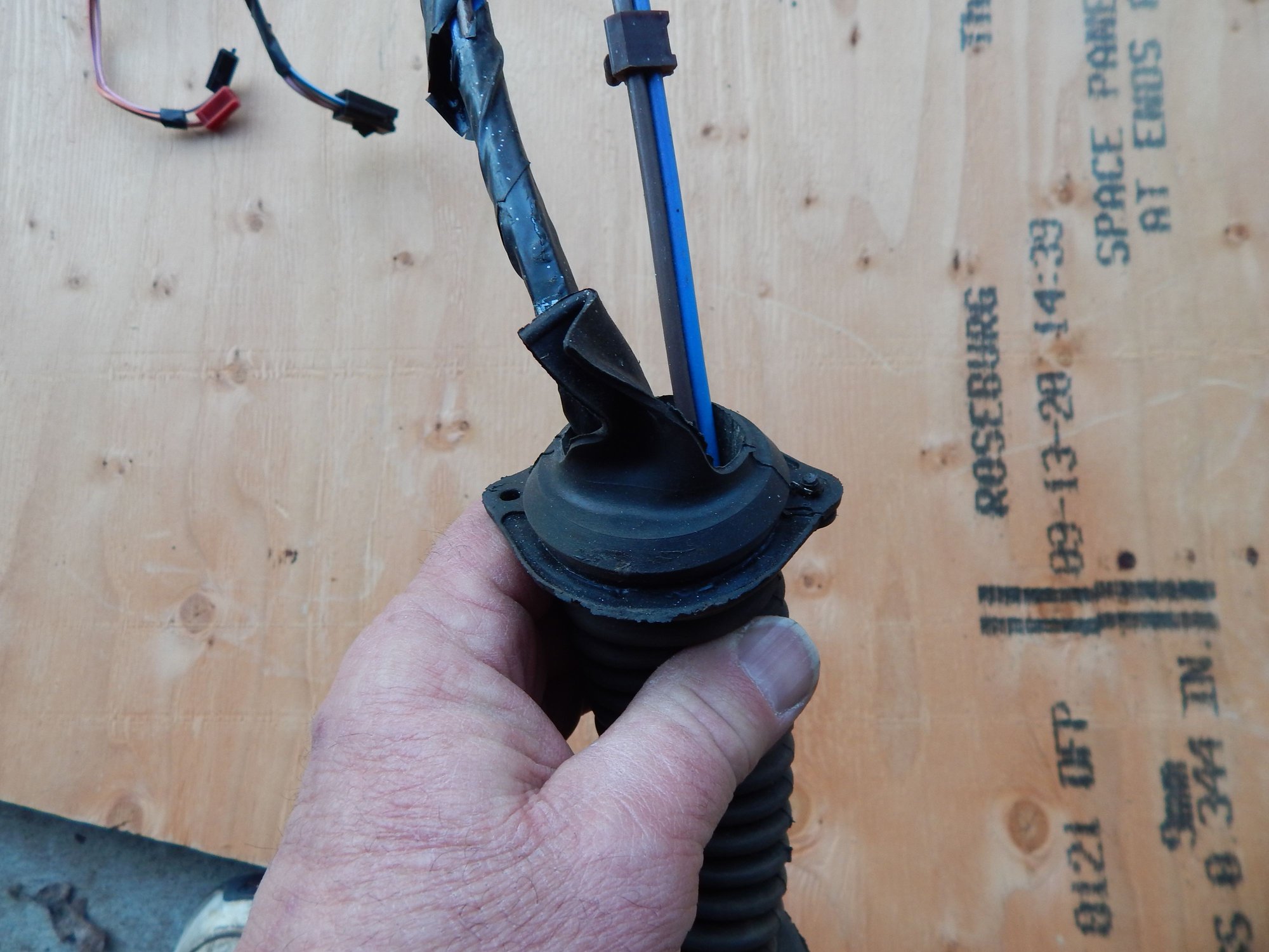

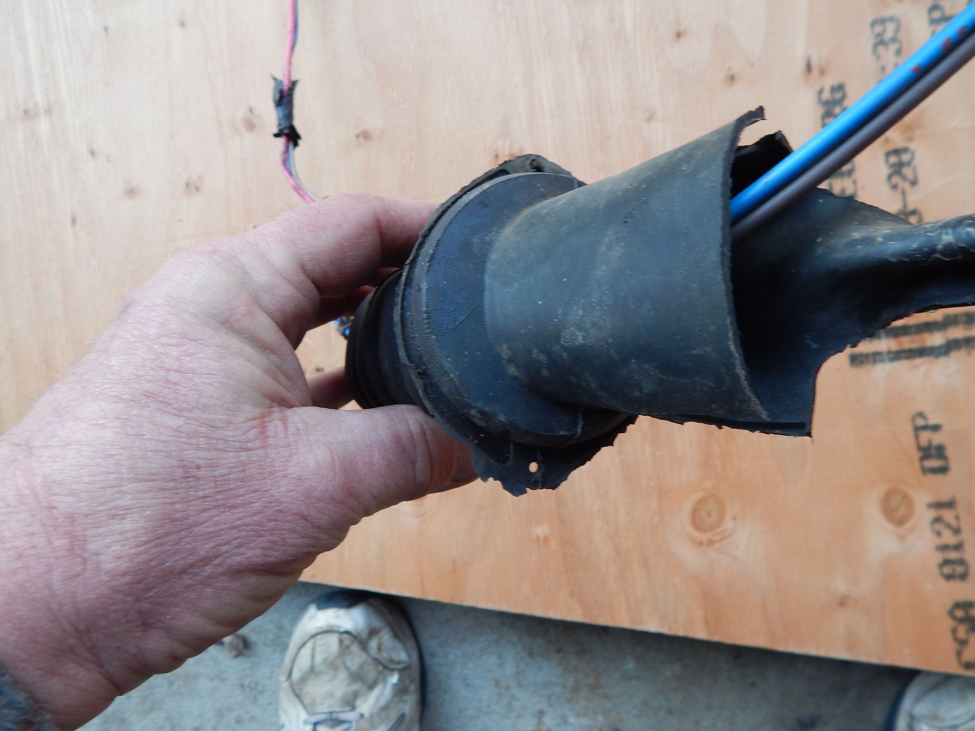

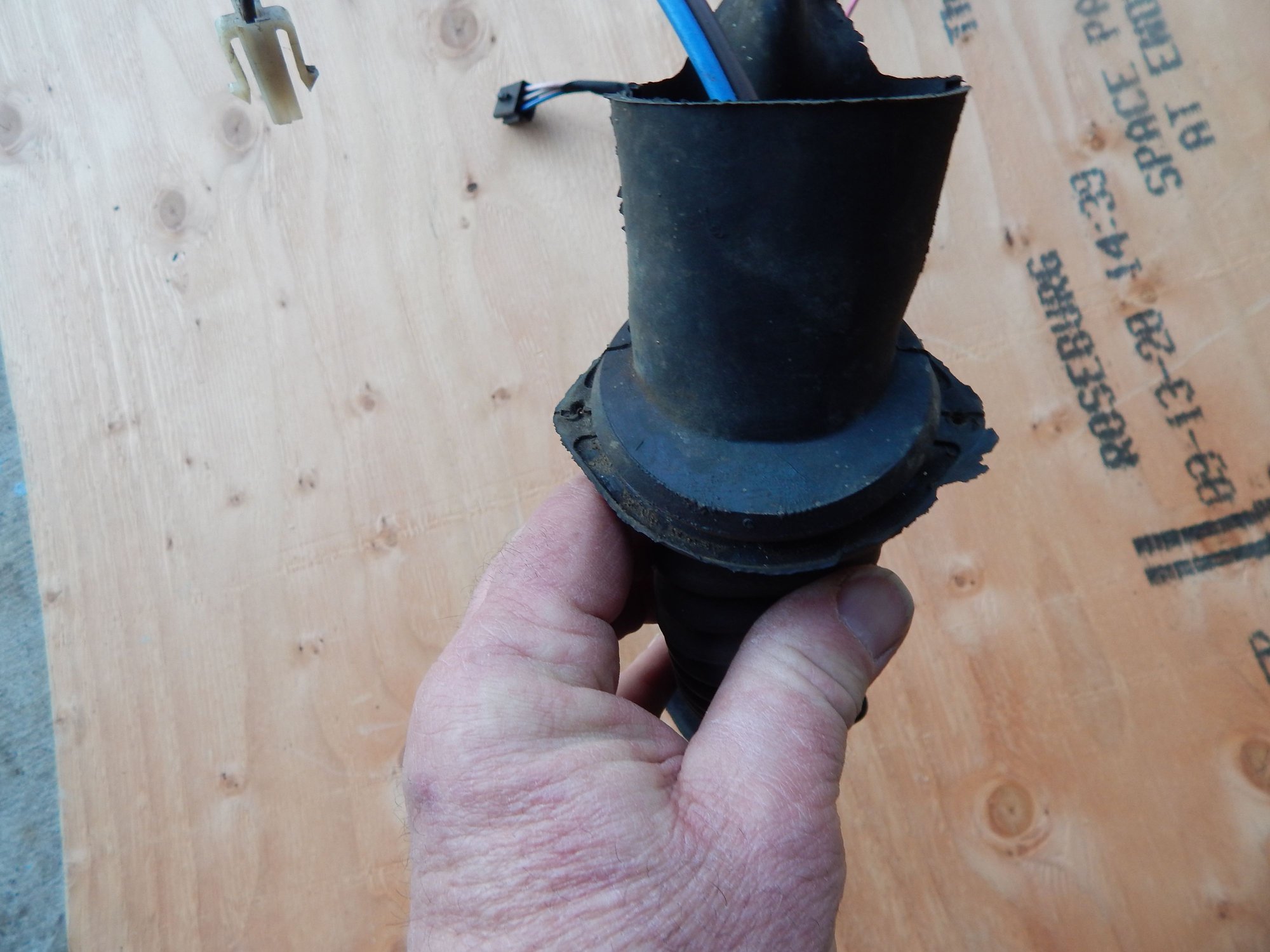

The '68 conduit is a moulded piece with little tabs on each end for black tape to hold the wires in place. The conduit is not split. The wires are put through without connectors on. It would be a hell of a lot easier to explain if I had a cell with data. Pencil crayons just will not cut it.

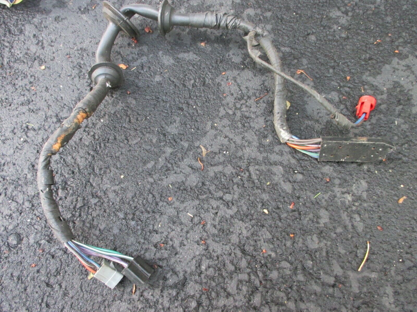

Yellowstatue, this is from the 1978 Toronado but I believe its similar to what your describing.
Old Feb 6, 2021 | 07:27 PM
Posts: 6,105
That looks exactly what’s in my car now. I have no clue what I got them out of.

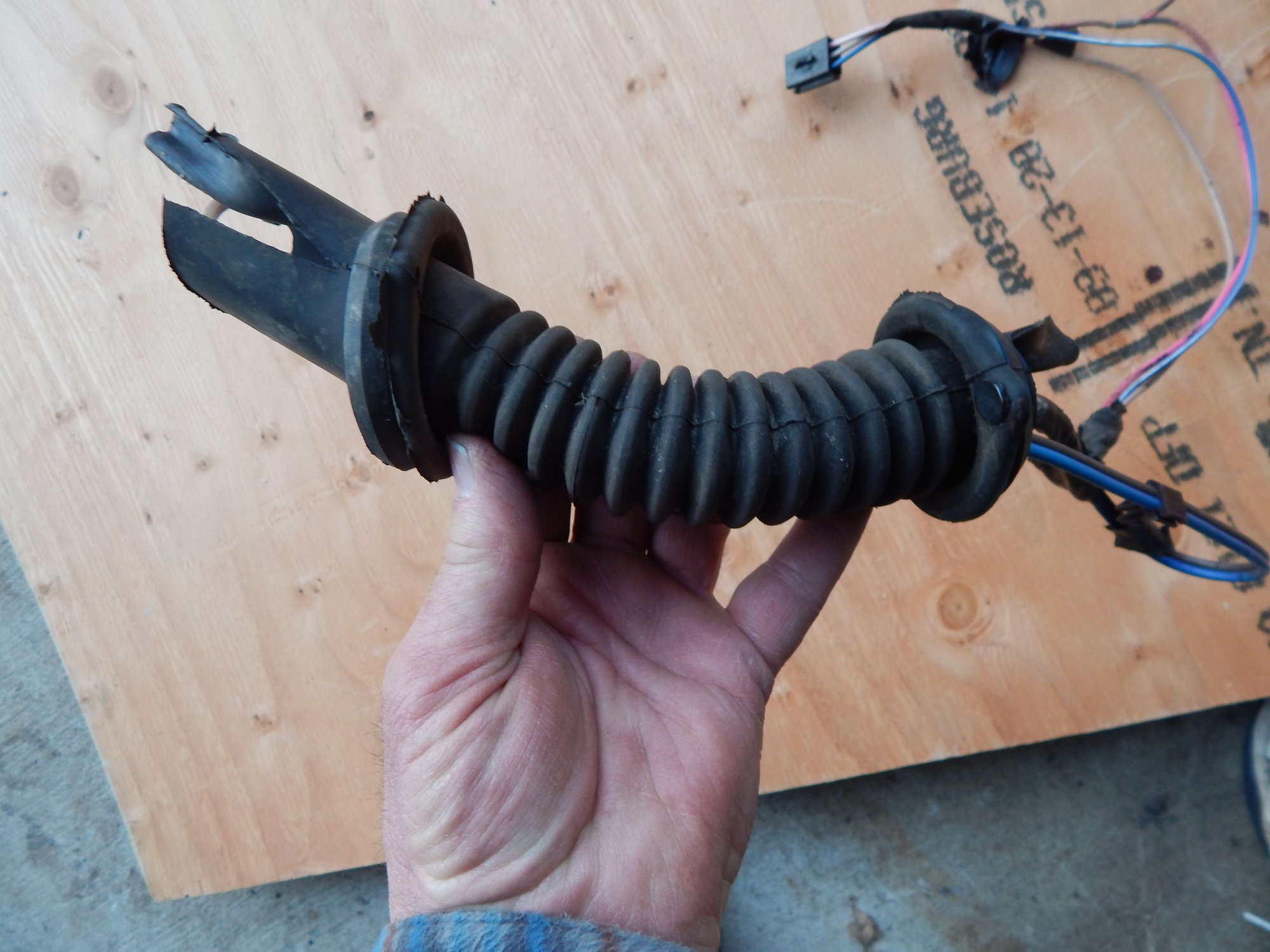

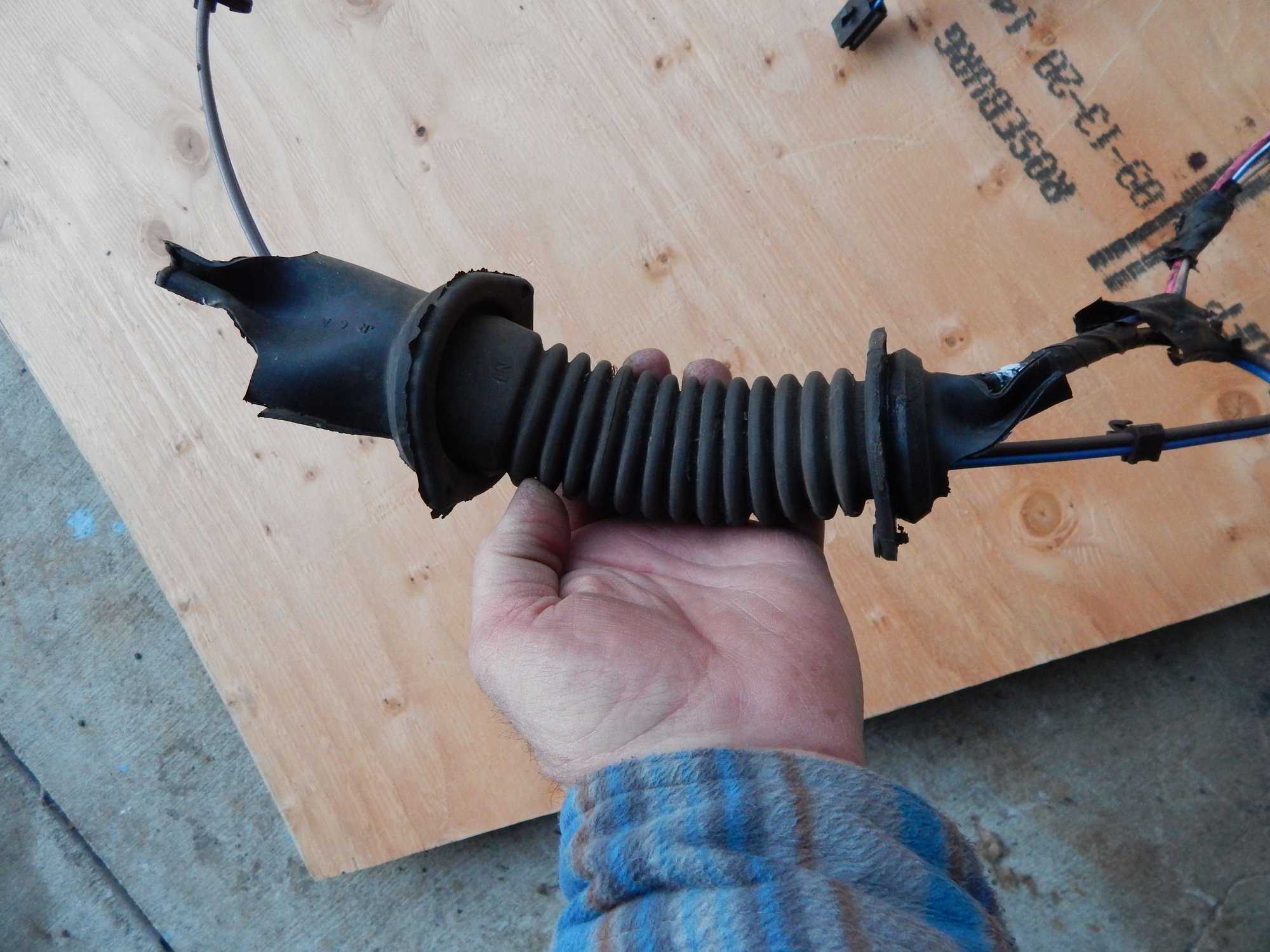

The boots on a '69 harness I have looks the same as the '78 Toro, with the little tabs on the ends to tape the wires. But a '68 boot looks like the one in post one, a thin smooth tube with a large grommet at one end and a small grommet at the other end with the same little tabs on the end to secure the wires with tape, moulded as one piece. The '69 boot is an improvement over '68. Imagine running vacuum hoses through that tube for power locks.

Here's a couple pictures of something similar on ebay:
And then a repop one. Yellowstatue, do either of these look like the 1968 Cutlass?

That looks like '68 Cutlass BUT, There are only two gromets, one large on the body end and one small on the door end, all moulded, as one piece. Long ago I ordered a replacement boot from Fusick's and what I received was what is in Matt's first post. Obviously wrong.
