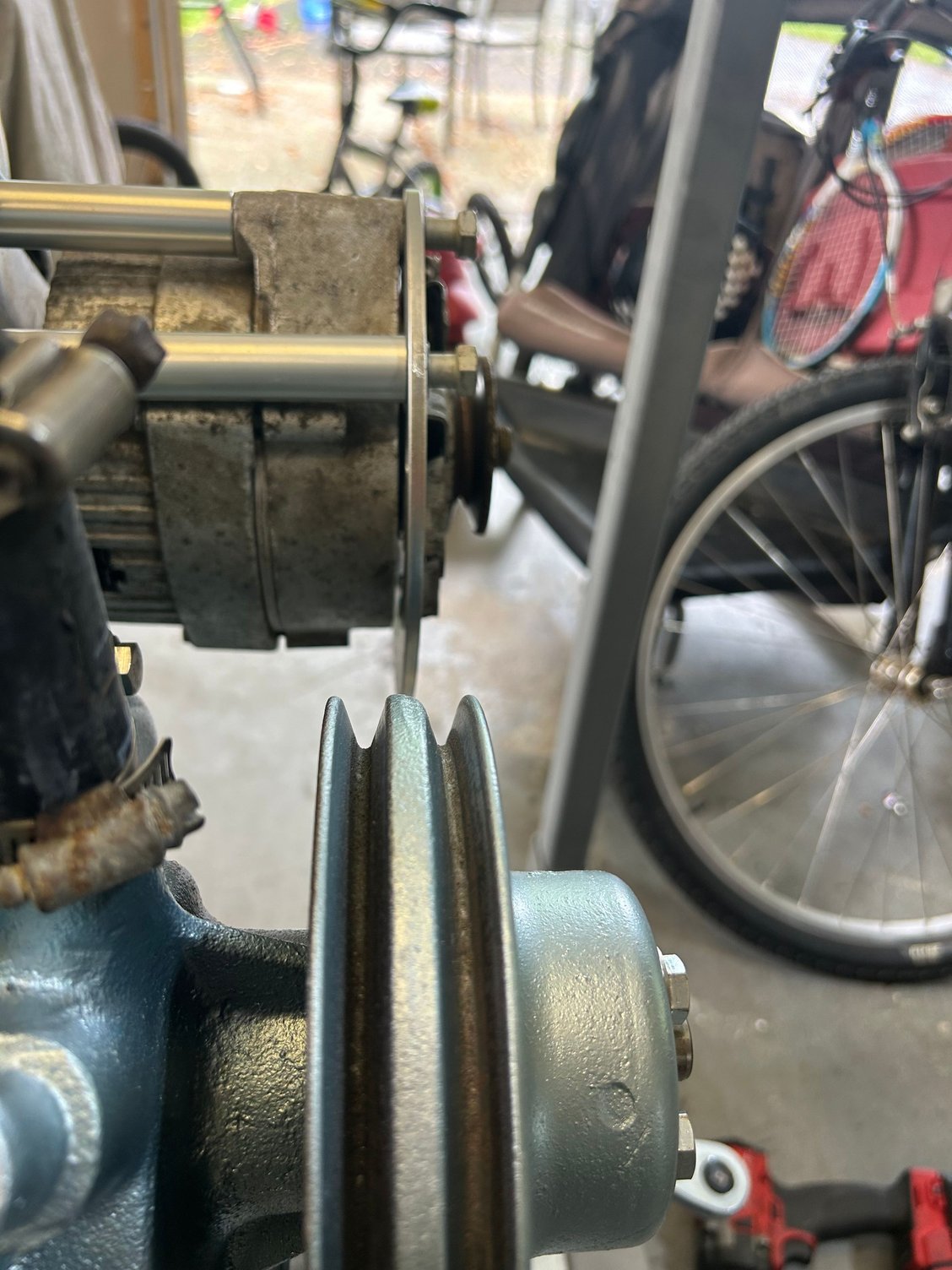

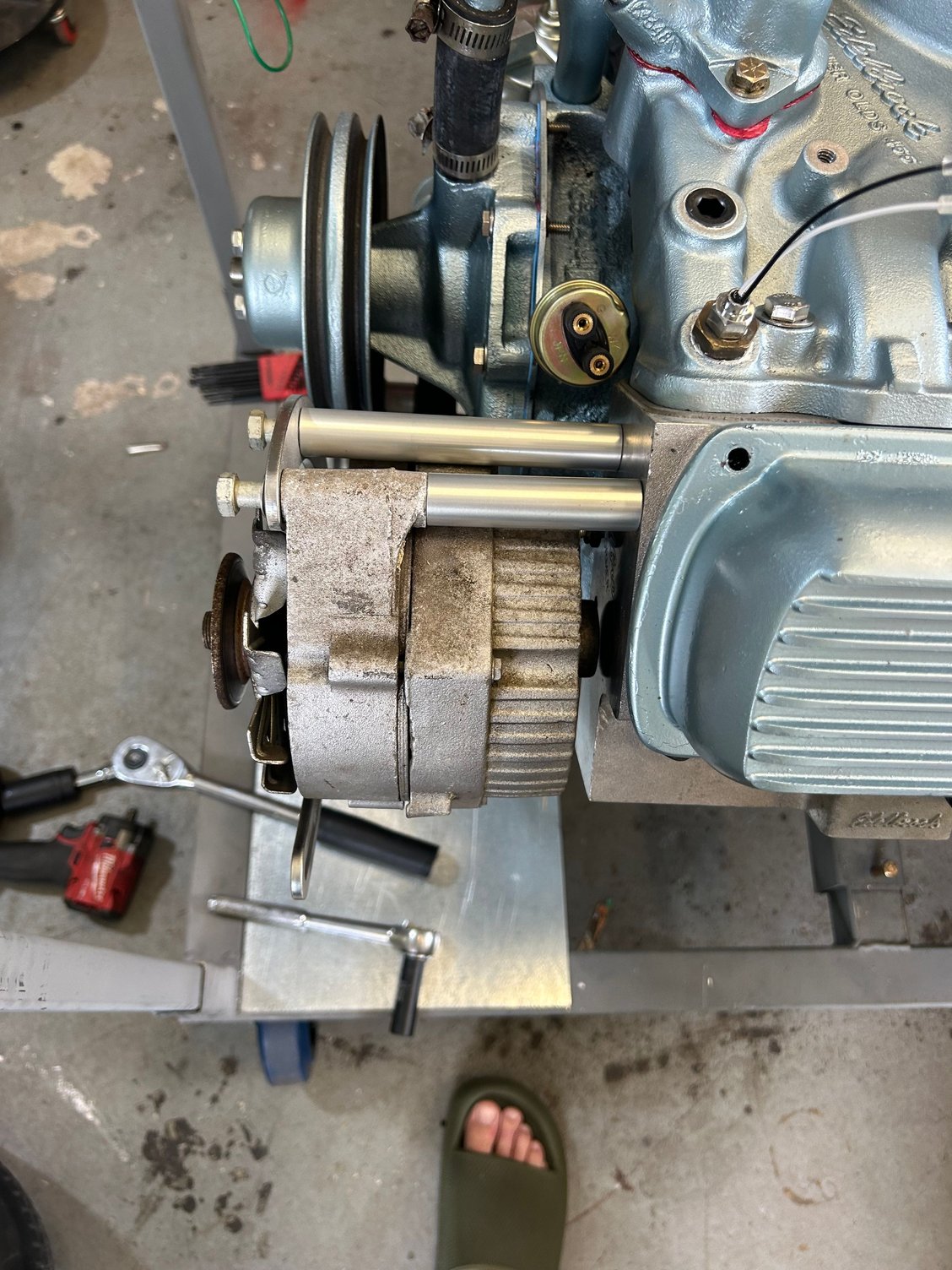

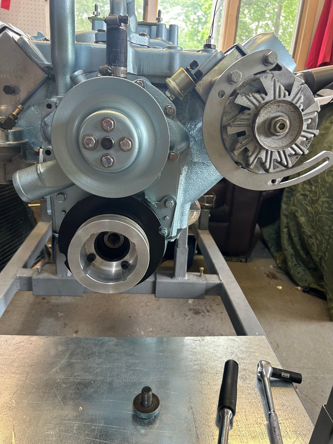

BOP engineering bracket. what’s up with this alignment? Alternator sits too far forward of other pulleys. No room behind alternator even if I cut some off the spacers. Any advice

I think you have it upside down.

What length water pump do you have on the engine? Maybe, BOP Engineering designed that bracket for the 6" water pump.
Which harmonic balancer are you using?
Have you contacted them?
