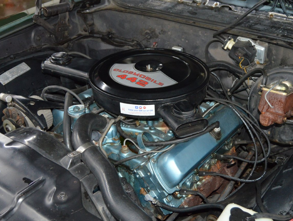

Hi all,
is this air cleaner ok for a 71 442 with no induction hood ?
I see single snorkel also, are they for 2 bbl engines ?
Thanks

Yes, this is the correct air cleaner for a 1971 442 without outside air induction. What's the two letter code on the decal?

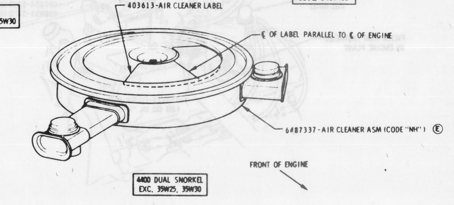

For anyone wanting to know the 71 non-ram-air air cleaner letter code, it was "NH". I rememember this only because it's the same code the 84-85 VIN 9 307 dual snorkel air cleaners used. I got one in the shop but can't recall if it still has the label on it.
(And 69 H/O air cleaner code was "OW" for those that care).

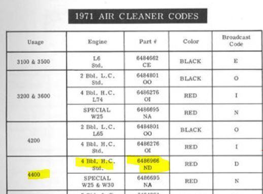

@joe_padavano Did the code on the 1971 Non-OAI air cleaner change during the year?
The inspectors guide lists a different code: "ND".

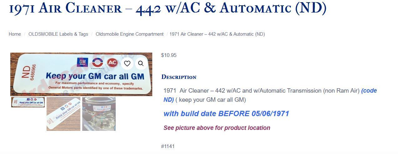

And as another point of reference (non Oldsmobile) "Dr. Decal" lists the two different codes. Code ND for a build date BEFORE 05/06/1971 and Code NH for a build date AFTER 04/29/1971. Don't know where this info came from and why there's a gap.

The PIM shows Note E that documents a change to the part number for that air cleaner on 4/28/71, so yeah something changed.

The 1973 and 1975 parts manual lists two different air cleaners between 71 and 72 with the change occurring 4/28/71.
So more than likely ND would be 6486966 and NH is 6487337

The revision on the engineering drawing was for the 1971 model year
I was speaking about the above.
