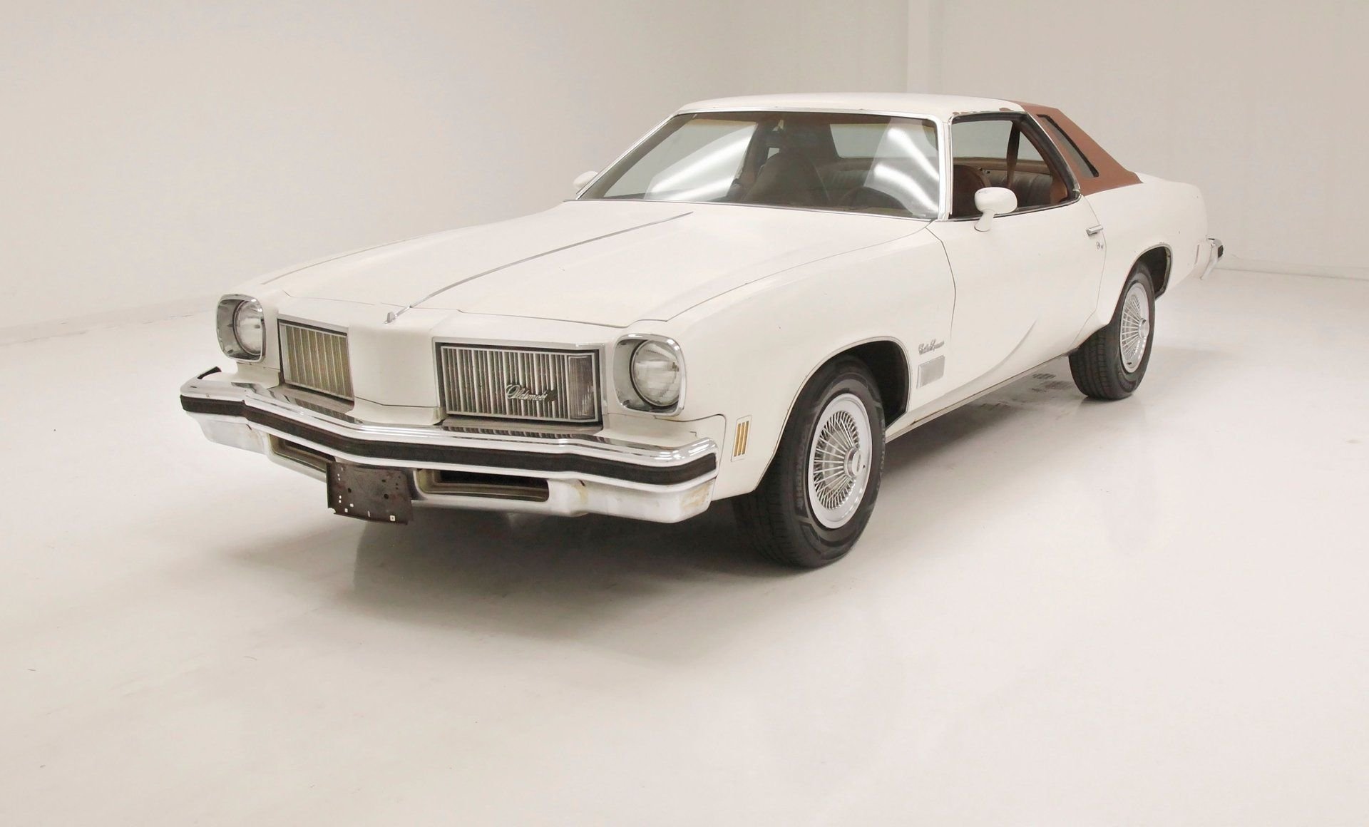

All should fit 73 and 74, though may not be 'correct'... not sure if any of them would fit 76-77, though the rear glass might.
I'm no expert, although I have a '74 (74 and 75 almost exactly the same except for grill and trim tweaks, and unleaded-only).
Some of the gurus will prob chime in..
There is a parts book here that should be able to confirm interchangability for those years.
the glass might also fit the buick regal/century. but not sure.

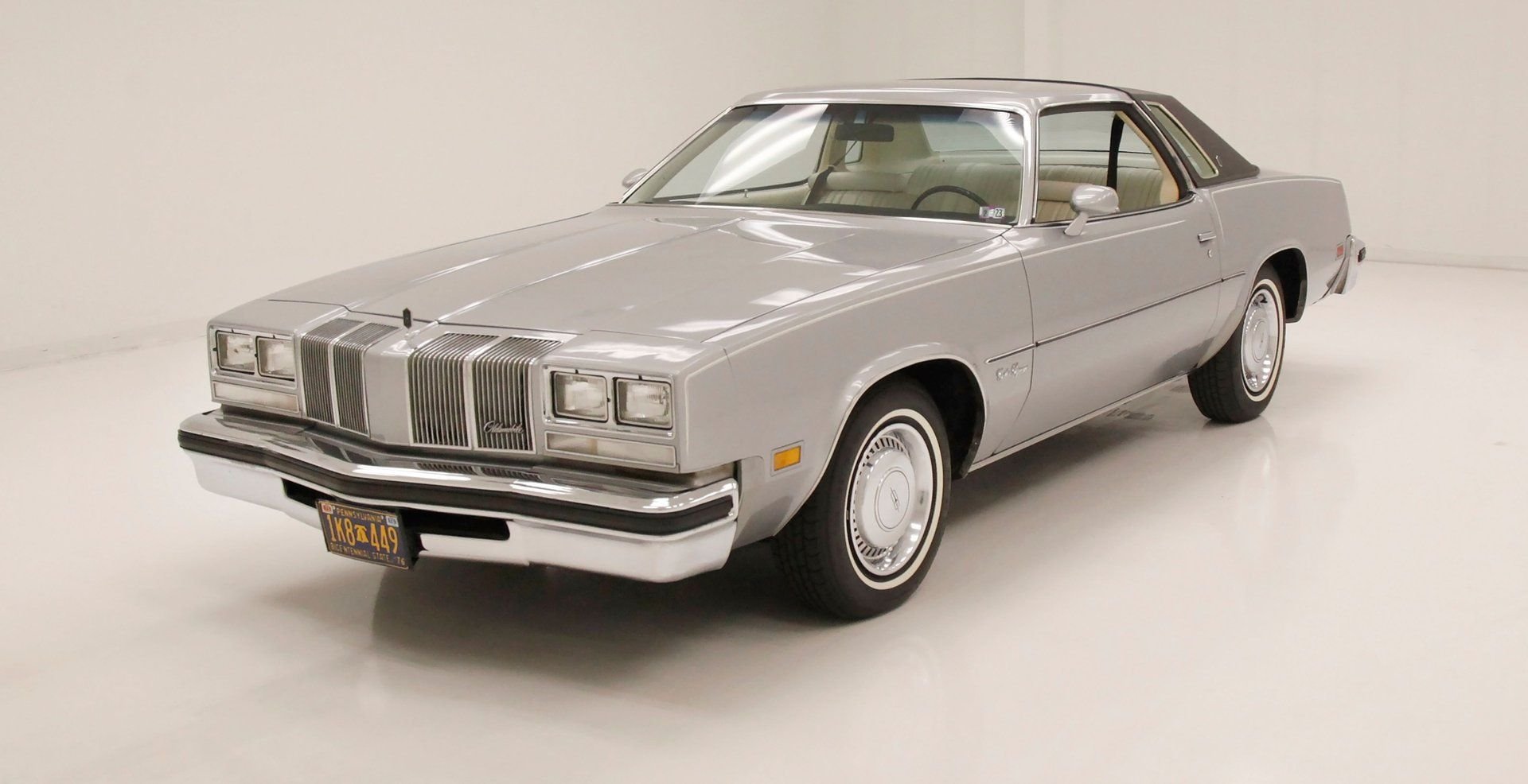

76-77 2drs use completely different sheet metal from the 73-75 cars.

Joe, so I understand, roof , doors, trunk , hood rear glass all different for 76-77 supremes than from a 75?
Old Apr 19, 2025 | 05:49 PM
Google Images is your friend. The 76-77 cars have COMPLETELY different sheet metal below the beltline. Roof may interchange.
