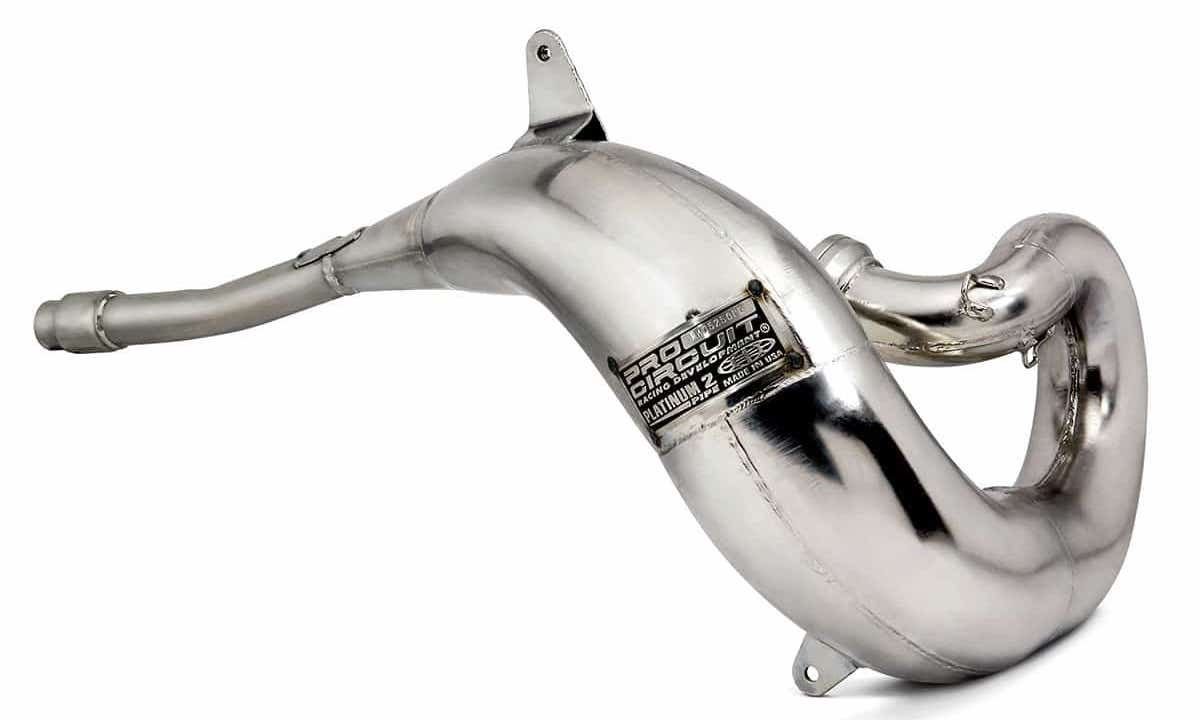

Unless it's in a land yacht, I know nothing about boat motors. I will say that two stroke motors DO take advantage of tuned exhaust systems, but that is essentially what real headers do for a V8. The pipes under your car are not tuned like this.
