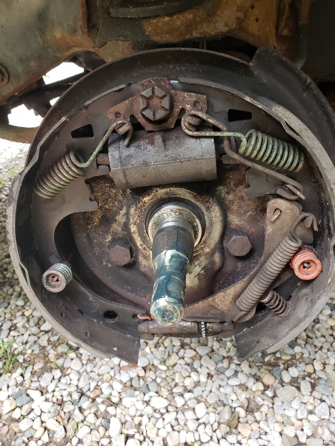

Recently changed my shoes on the front (will eventually switch to rotors but first thing was to get this baby on the road).
since the HUB is pressed into the drum, and there's no way she's coming apart without a lot of heat and pounding, I just pulled the whole thing off by yanking the bearings.
Noticed discolouration on the FL outer bearing so ordered a new one, and also replaced the seal on the rear of the the hub.
Just rebuilt my rodchester2c as well, and went to an HEI distributor, so - so finally got her purring like a kitten.
Went for a road test.
Ran good - but a couple issues
- Tires need to be balanced
- FL wheel had some smell and notices a small amount of blue smoke coming from it.
I pulled the drum off and checked it. Everything looks OK.
- Cylinder is NOT linking - looks OK there.
- Bearing looks OK.
- Rear seal is NOT tight against he rear bearing race though maybe that's the issue?
Thinking may shoes are a bit tight - pulls a bit to left when I brake - so I'll back them off a bit. The wheel seemed a bit warm in comparison to the other side.
I've attached the pics,
Everything looks OK - so did I have the bearing too tight? I basically tightened the nut up until I had no play, then a quarter turn in after - so I don't think so.
Appreciate anybody's thoughts on this.

It all looks fine to me. Did you change the race along with the bearing? The drum is held on by the wheel studs, I don't see a reason to change it unless there is not enough metal to cut it if you feel a vibration. You may have had some residual grease or contaminant on the shoes, they may have been adjusted too tight, and you may have your bearings adjusted too tight.

I would STRONGLY suggest that you get a factory service manual and read it before applying heat and pounding to anything. The drum is retained to the hub with the wheel studs. You have to press the studs out and then the hub and drum come apart easily. You're SUPPOSED to take the drum and hub off the spindle as an assembly to service the brakes, as instructed in the CSM.

I read on SKF website - think I was tightening to the hole vs loosen to align with the hole.
Also backed off the brakes in a bit.
Joe - yeah was not going to press it out. No need to muck with it anyways,
I'll take it for another run tomorrow - hopefully we are good to go.
Thanks for replying guys, I just wanted to know if I missed something stupid.

"I read on SKF website - think I was tightening to the hole vs loosen to align with the hole."
I don't understand what you mean, could you explain please.
Old Sep 1, 2019 | 03:10 PM
Sugar Bear's Avatar
Posts: 4,110
Tightening to align the castle nut with the hole in the spindle for the cotter vs. loosening to get the hole to line up.
Old Sep 1, 2019 | 03:11 PM
Posts: 50,806
I'm guessing he meant that he adjusted the wheel bearings then TIGHTENED the spindle nut further until he could get the cotter pin installed. The correct way is to loosen to get the cotter pin installed.
Old Sep 1, 2019 | 04:36 PM
pappyl's Avatar
Joined: Jul 2013
Posts: 48
Yep, exactly.
