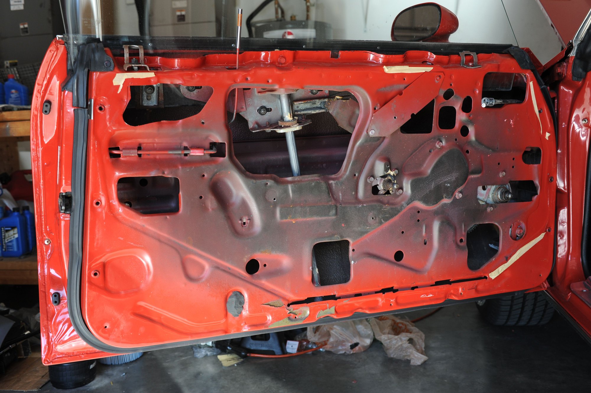

My ragtop is a code 57 Baroque CS which was rotisserie painted 'resale' red sometime during the 90's by a prior owner - found original color still shaded on the interior doors behind the panels tho.

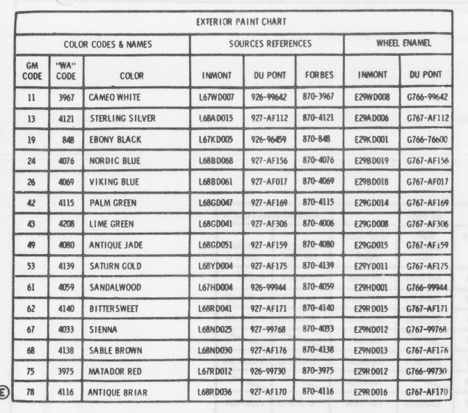

Is Saturn Gold a "Special Order" for 1971?
Old Apr 28, 2026 | 02:23 PM
Posts: 50,802
Apparently not.
