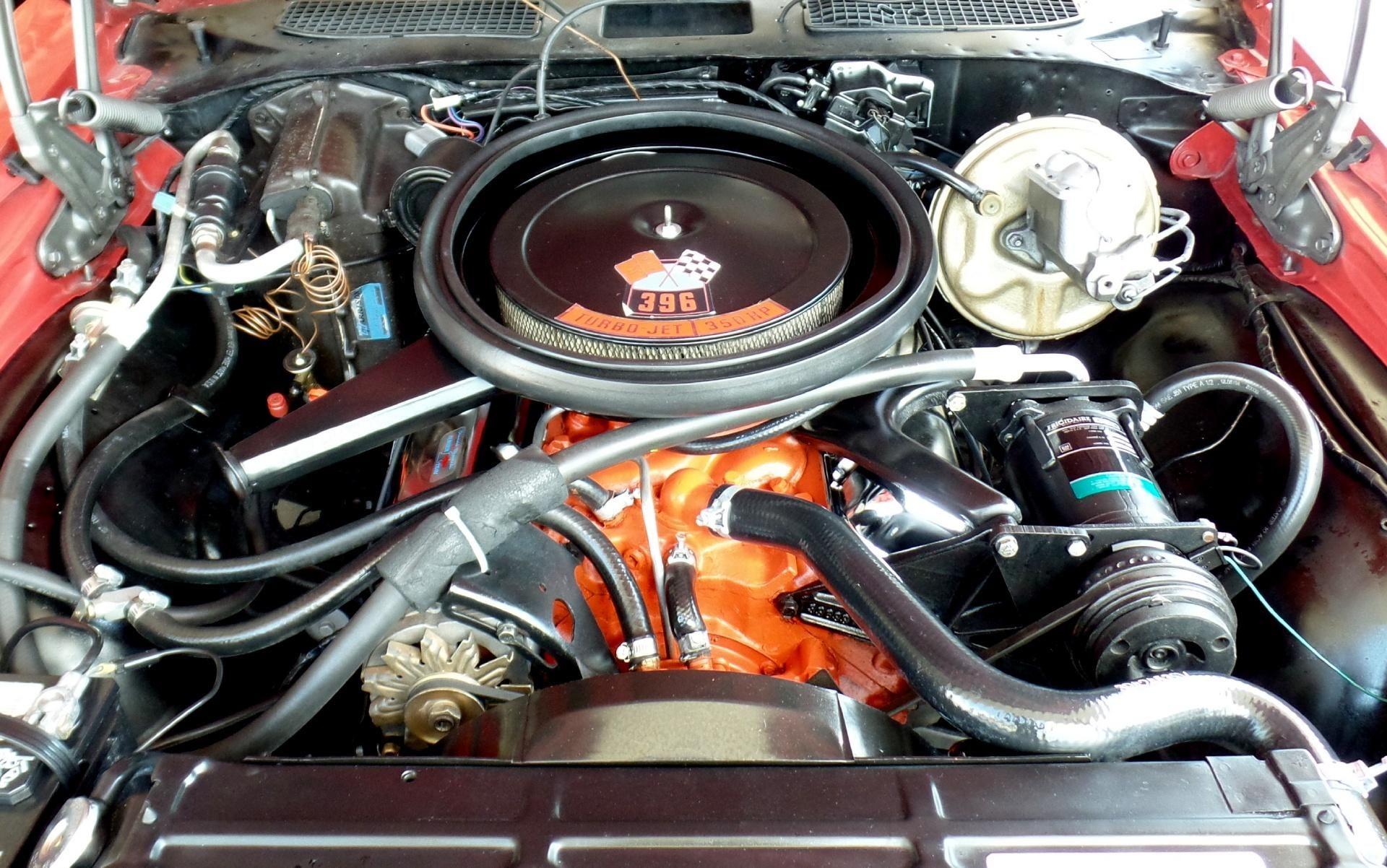

The hardest part of the change will likely be correcting the hoses. Will you be doing the work, or will a shop be moving the compressor? While it is certainly odd in a cutlass, keep in mind that 69-72 chevelle (along with a bunch of other chevys) did use a driver side compressor/ passenger side Alt set-up from the factory.
Old Nov 8, 2022 | 04:46 AM
I've seen a lot of aftermarket A/C systems that leave the alternator on the passenger side and just bolt the new bracket on the driver side. As shown, that's how Chevies came from the factory (and I've never understood why you wanted the longer hose runs). For the aftermarket, it avoided needing to source the factory driver side alternator brackets, lengthening the harness, etc. All the A/C hardware was new anyway for the kit, so this was probably the lowest-impact way to do it.

The 442 I'm trying to see (possibly tomorrow) looks pretty similar to the Chevy pictured above except that there are two a/c hoses crossing over the front of the engine instead of just one. It looks like one of the Chevy hoses is dropping down and crossing over somewhere down below or behind the engine? Pretty much the same set up, though. I don't know why you would want the longer hose runs, either. I like tidy, and that looks more cluttered. Hopefully, I can see the car tomorrow, take lots of pictures, and try to get some posted. As far as making any changes, I would try to do it myself unless I run into something that goes beyond my limited scope of knowledge. I'm pretty handy with tools, like to work on things that I think I can do, have a fair amount of common sense, but I do have limitations in work space and specialized tools. I'm, definitely, not an expert at working on older cars. Thanks for the input thus far.
