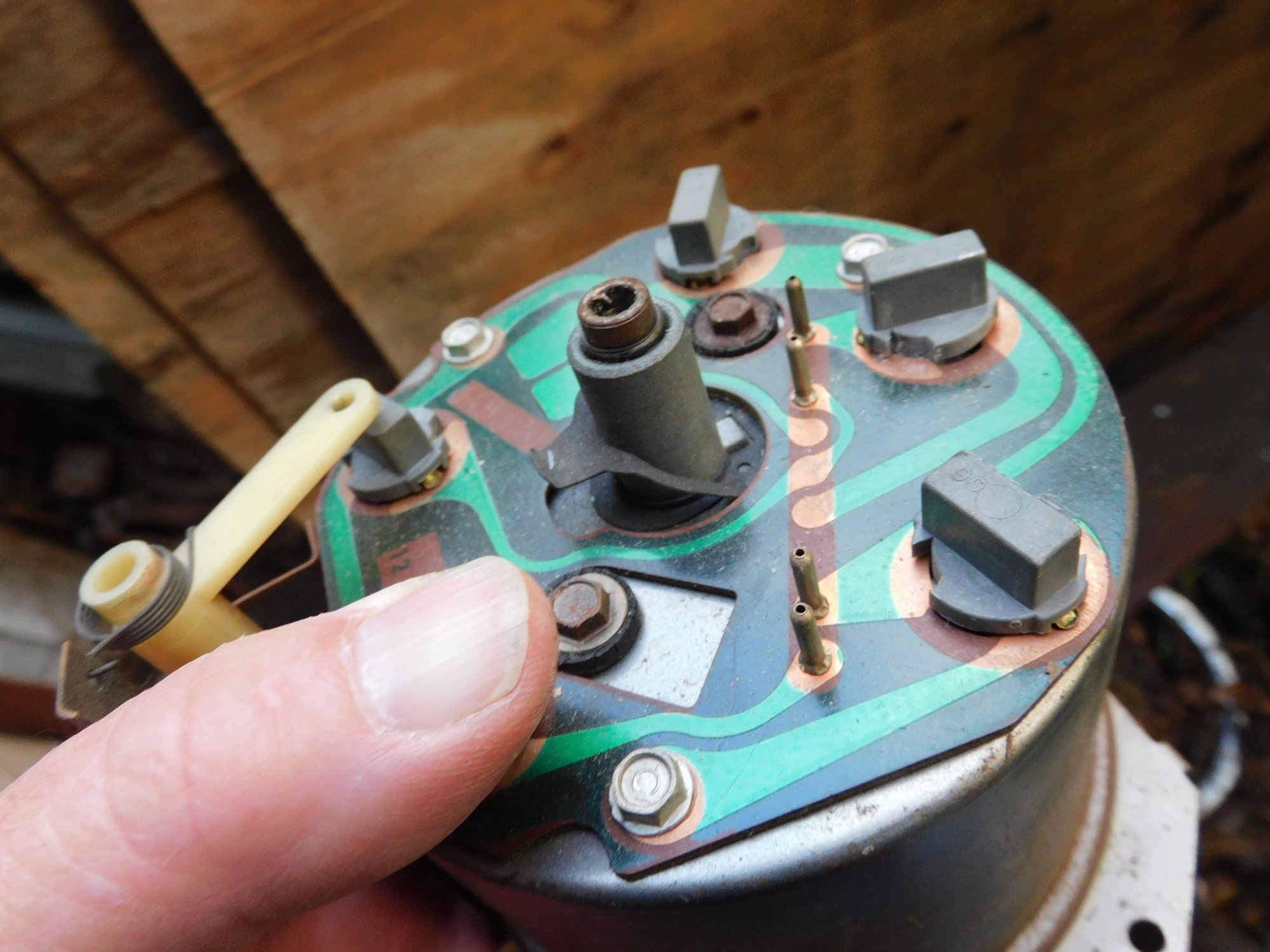

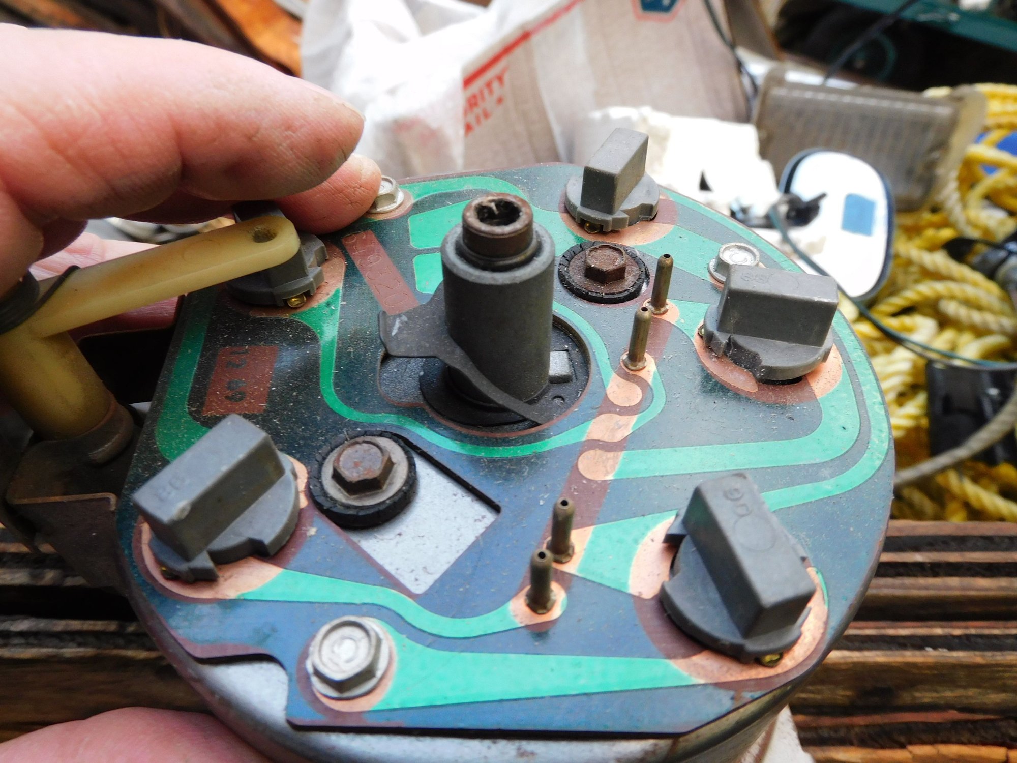

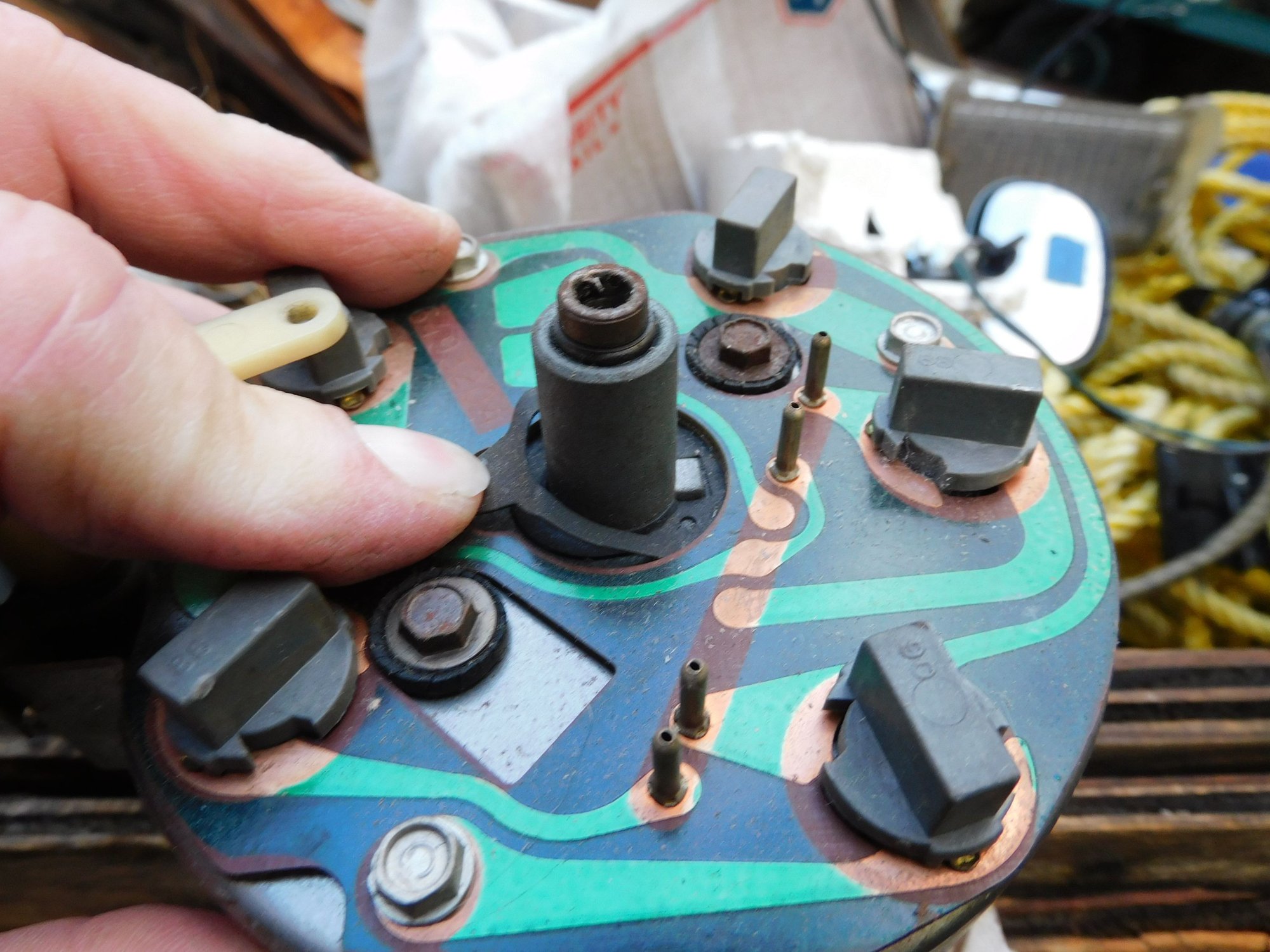

Yes. You have to stand on your head to look up under the dash to the back of the instrument panel. I don't think you have to move anything, but if you have small hands that will help! The back of the speedometer head on the 1968 has a fitting on the cable housing that threads onto it. I believe the 1969 was the first year that it has a clip that you need to depress with your fingers then pull the cable off.

I'm pretty sure 1969 was the first year the A-body used the clip rather than threaded speedometer cable housing. Joe, if I have that wrong please speak up! But here's a few photos of a 1970 speedometer with the same clip. You need to depress it before you can pull the speedometer cable & housing off. Let us know if you have any questions after checking out the photos. John

You are correct John. 1969 was the first use of the clip-in speedo cable.
