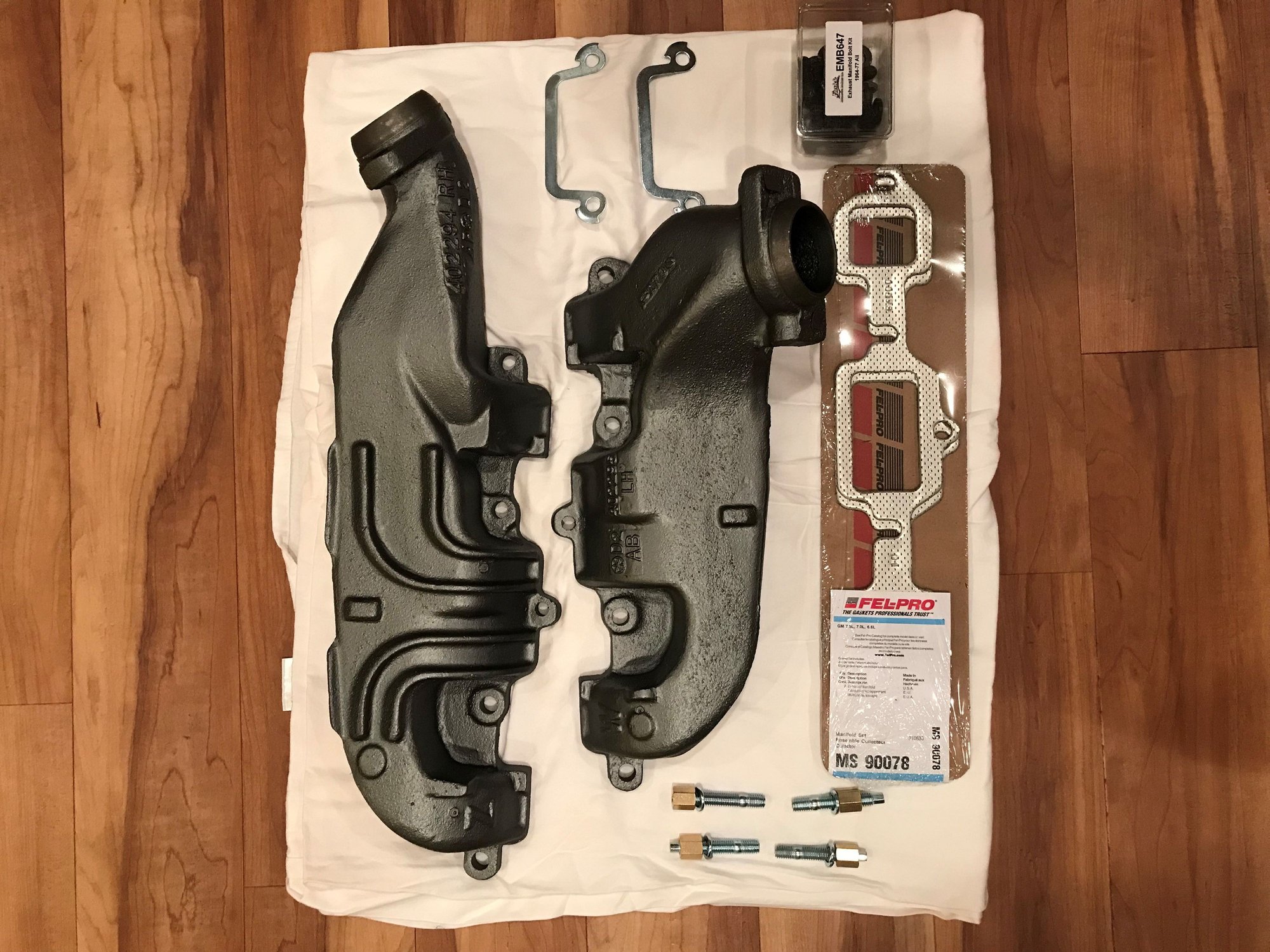

Ready to go on, painted with Eastwood factory gray manifold paint. CSM says torque for mainfold bolts is 25 foot pounds, do you use anti sease on the studs?
Thanks!
Old May 27, 2022 | 02:56 PM
442Harv's Avatar
Posts: 1,735
From: Tracy Ca
Yes I would
