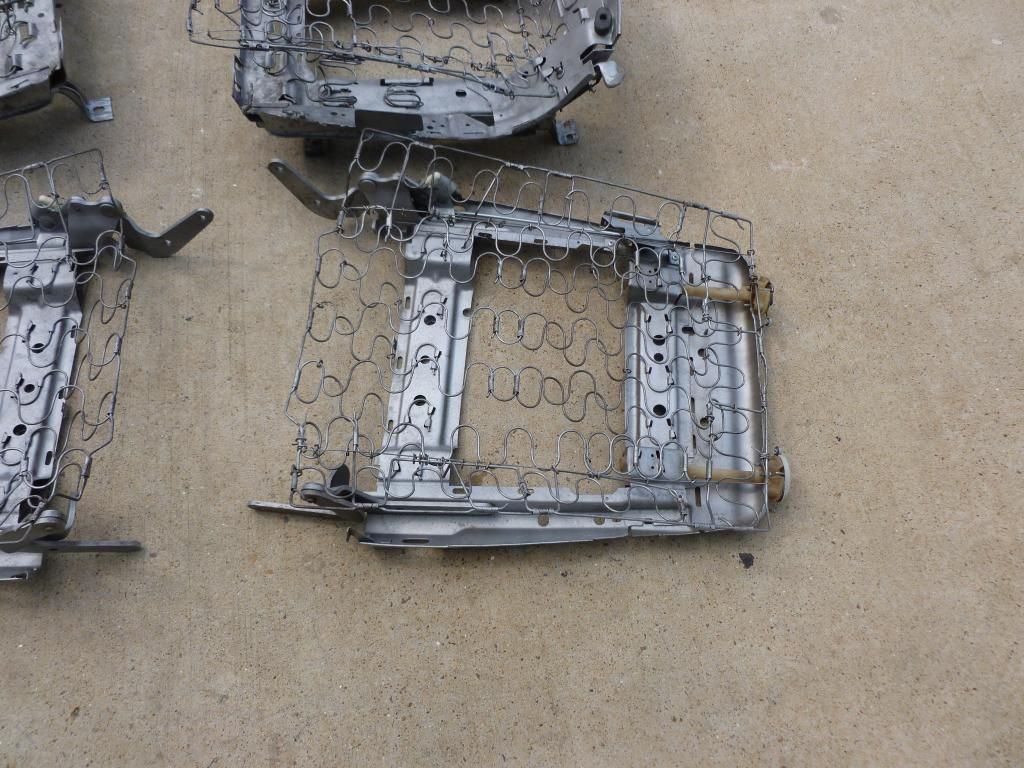

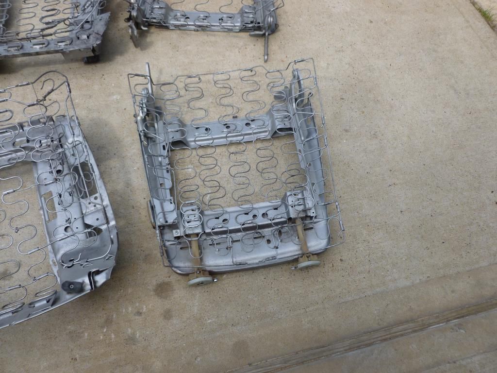

Did some digging in my photo archives and found some pics of interest....
1968 Upper Frame, headrest tube opening
1969-72 upper Frame, headrest tube opening
69-72 Headrest tube- underside of the "head" showing what needs to fit through the frame
Cool diagram showing the 3 styles of headrest locks/bezels (not mine, cant recall who sent it to me)
Also- Incase you ever see them at a swapmeet and are confused- The 68 only headrest bezels are not chrome like the others, they are seat colored, and textured plastic like the seatback/side panels.
Cheers!
Ben

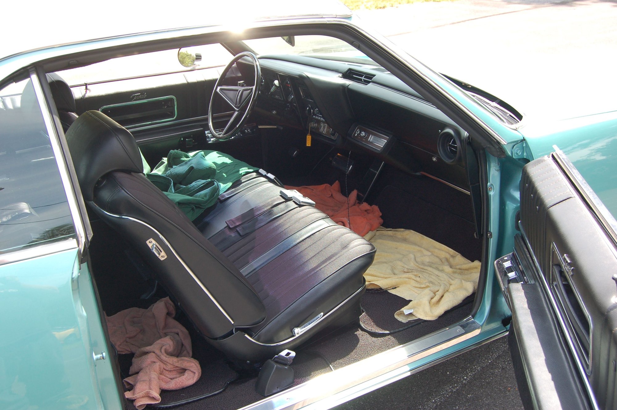

This is the best pic that I have on hand of the head rests and locks on my toro. You can just make out the right side lock plate cover under the headrest.

Forgot, i had some more.... a friend back in Iowa stumbled across a set of 68 upper cushions (and only the upper cushions, weird) that had the correct headrests & bezels still in them...
If you look at the pic with the headrest tubes you can see they have the "key" shape going all the way down the tube, not just at the head like the 69-72 ones)

Old Mar 17, 2021 | 08:36 AM
Posts: 12,764
That is the rarely seen strato-bench, I believe.
Old Mar 17, 2021 | 09:01 AM
Posts: 50,770
Yes, but the seatbacks are the same as on the buckets.
Old Mar 17, 2021 | 10:13 AM
Loaded68W34's Avatar
Joined: Jul 2020
Posts: 1,938
From: Pennsylvania
Correct. The only difference is the inner hinge on both sides where the seat back bolts on the the seat bottom. The outboard hinges are identical to bucket seats, the inboard hinges bolt to the seat base from the top rather than from the side.
