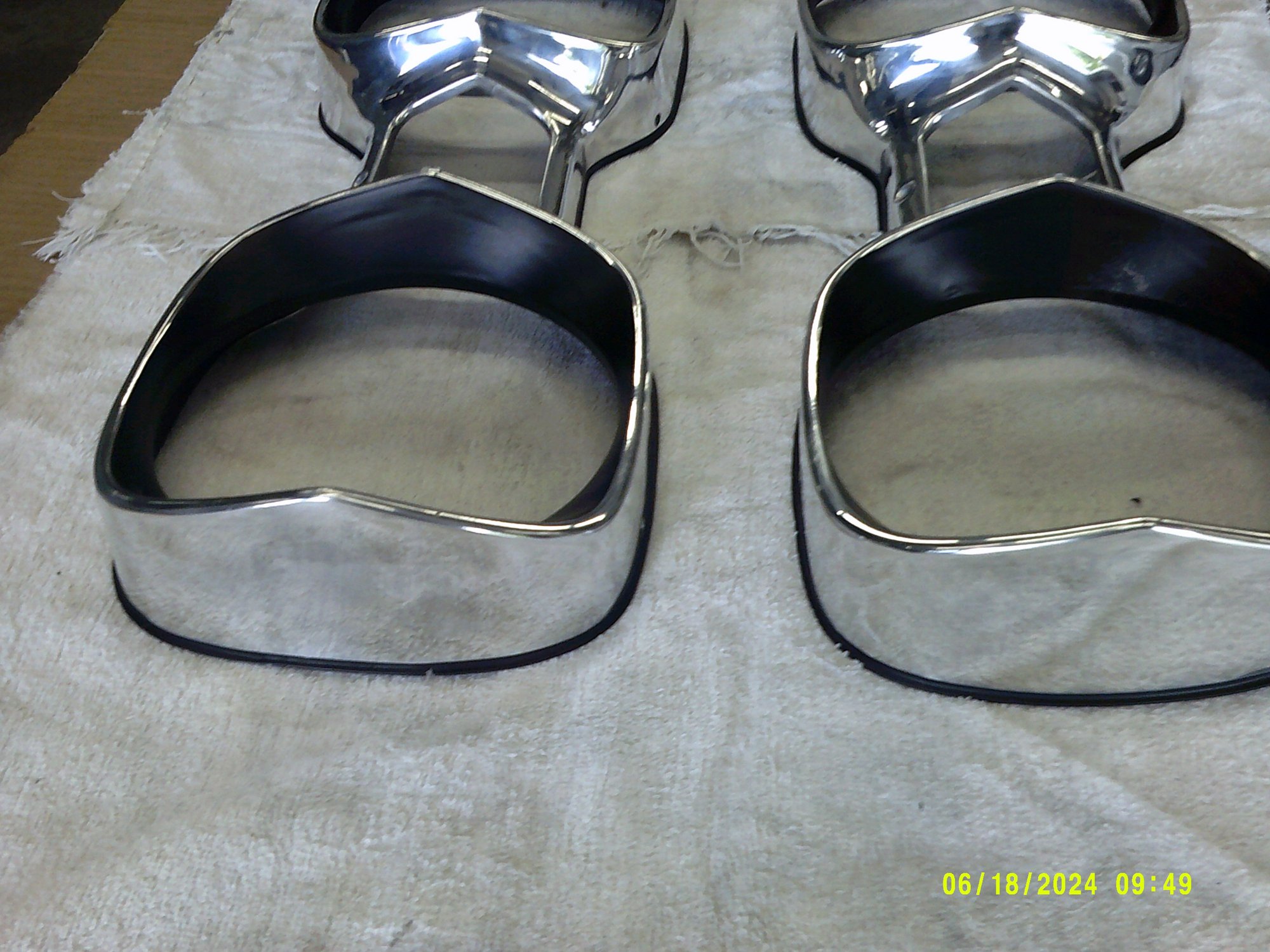

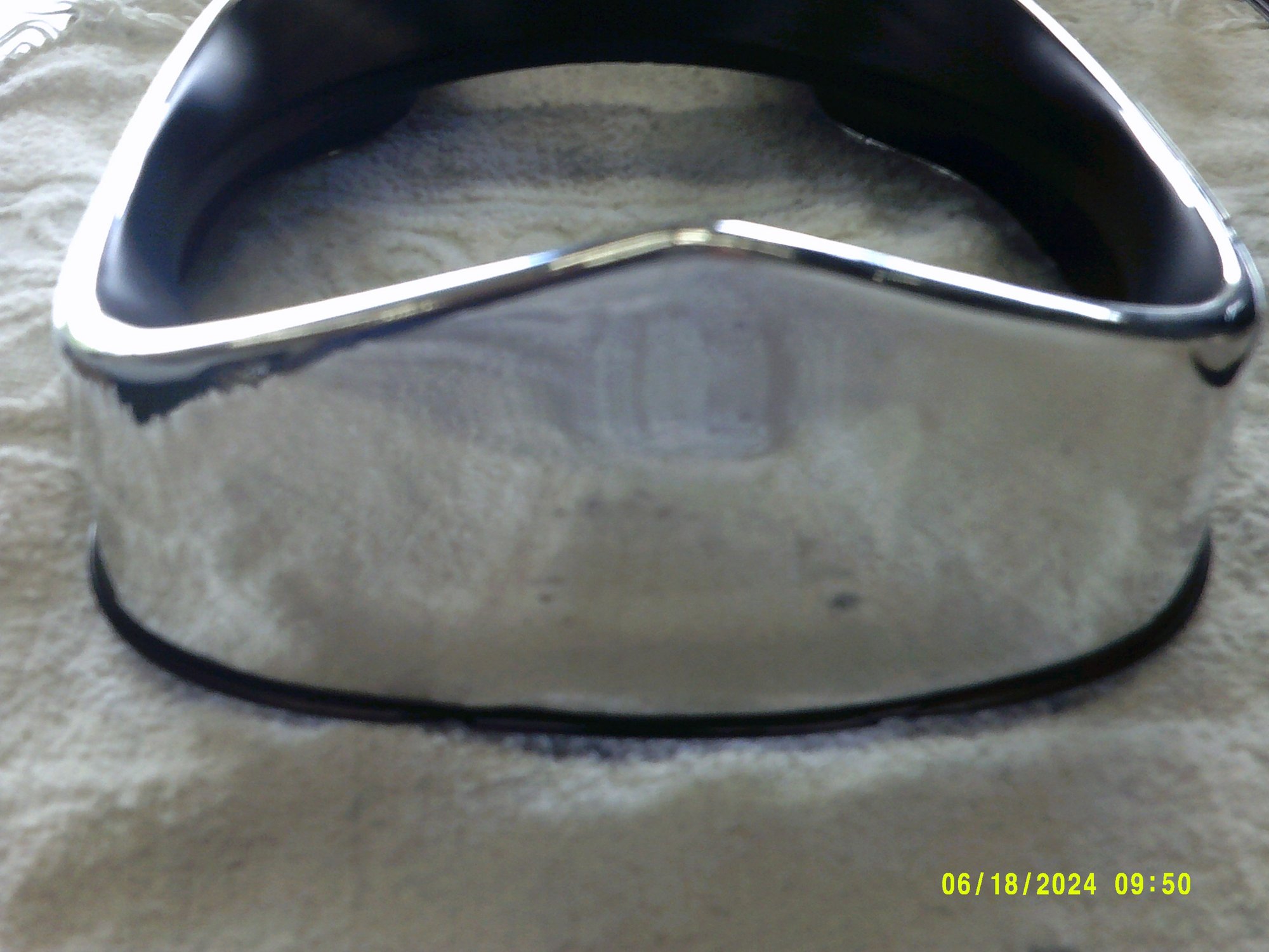

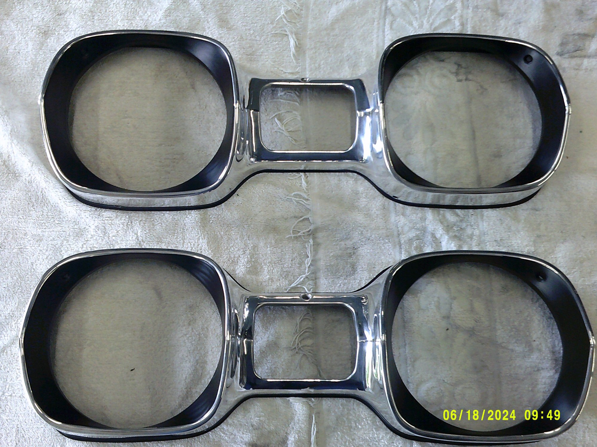

I'll try to make anything if it's not available. That's the case with bezels for a 1967 442. I took a pair of Cutlass bezels with the notch and welded them in and had them re-anodized. They turned out pretty good except for the welds which are a little cloudy.

The obvious welds separate them from originals. There are no high quality originals out there to price against and that's the reason I tried this.
