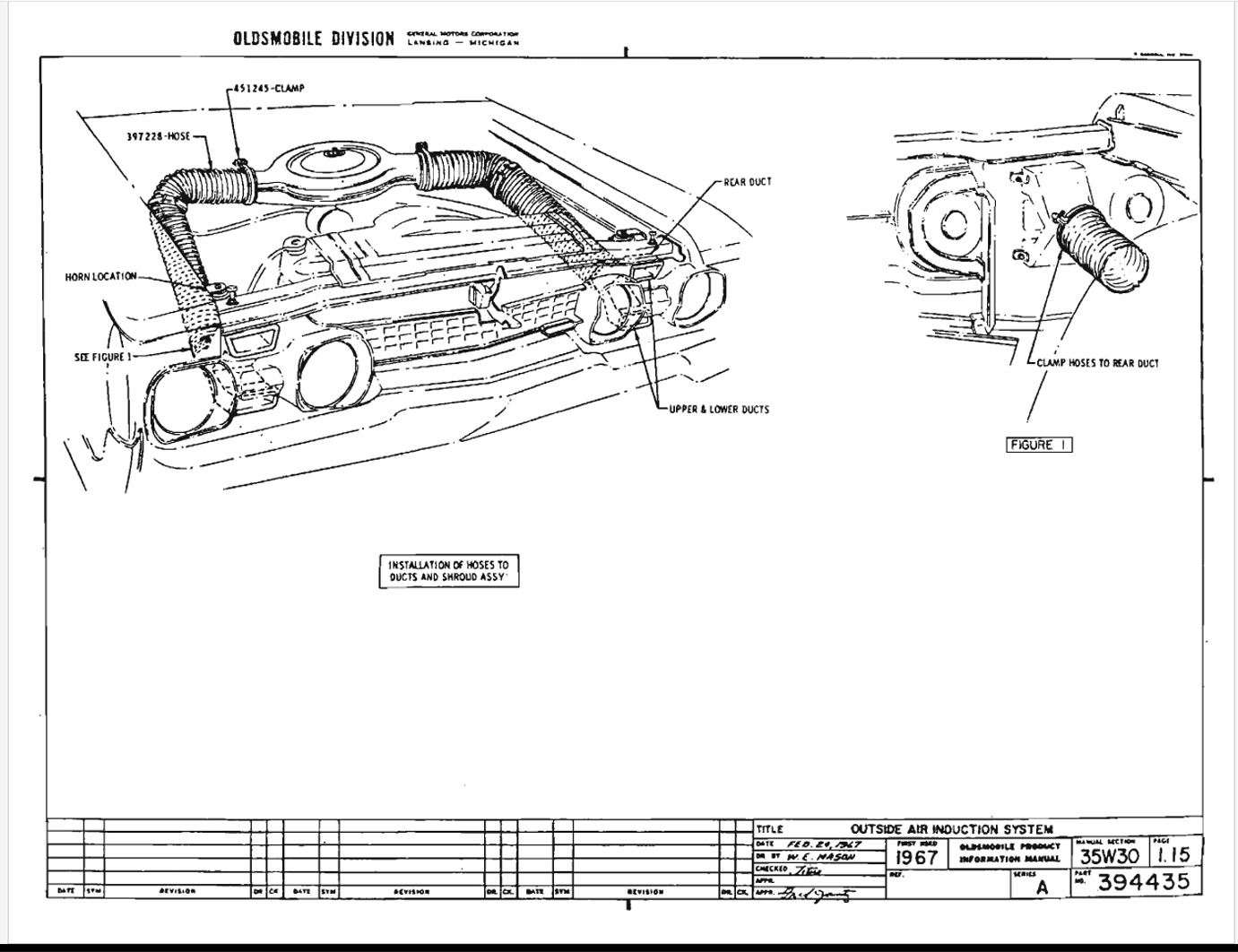

Hey Joe,, as usual u are correct. I did not look close enough, should that have power brakes with the w-30 option ??? also where in hell does the outside intake runners go to on the 67. Mine as you know are in the front bumper for the 66 ??

The ducts are above and below the turn signal housings in the grill.

I knew you would know that question..you must be the guy to go to on this site ... This does not look as efficient as the 66 models does it. does the w31 option have power brakes ???
