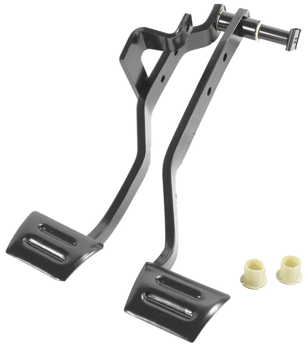

Will these work for the 68-72 A bodies
as a bolt up and go as a complete setup
from the firewall?
Using the 68-72 brake booster, column and such?

Nope, sorry. The 64-67 clutch pedal is different from the 68-72 pedal.
64-67 pedals:
68-72 pedals:
64-67 pedals:
68-72 pedals:
Actually 64-66 are the same but 67 is different. The 67 pedals use a bolt unlike the pin style used on the 64-66 pedals. The 67 clutch rod is also different from 64-66.
