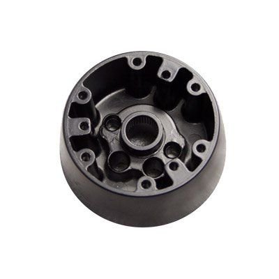

I want to replace steering wheel on my 64 F85 . I recently saw a 64 442 with a ralley style steering wheel from a 70 up car at Mecum Indy auction televised . I don,t Know whats involved in the swap . Anyone tried doing it ? I want a nice quality wheel with functional horn and would be ok with a aftermarket

You need the hub from a 1964-66 Chevy with the two spoke steering wheel. The Olds four spoke bolts right to it.

And use the horn parts and button for the ralley steering wheel ?

Yes use sport steering wheel parts for horn.

I got my wheel off a Corvette site $200 and 68 442 hub will work $42
Joe if you use a 3 spoke wheel the 68 hub is needed its stepped.

Yes, but the OP is asking about a four spoke 1970-later wheel, which does not require or want the extra notch. The hub that I posted is flat and works correctly with the four spoke wheel.

Thanks for info ... Now I am lookin for a nice Blue or Black Ralley wheel

FYI, the 15 1/2" four spoke wheels used in the A-body cars were only made in black. The 14 1/2" versions used in the 1975-80 Starfire came in colors.
