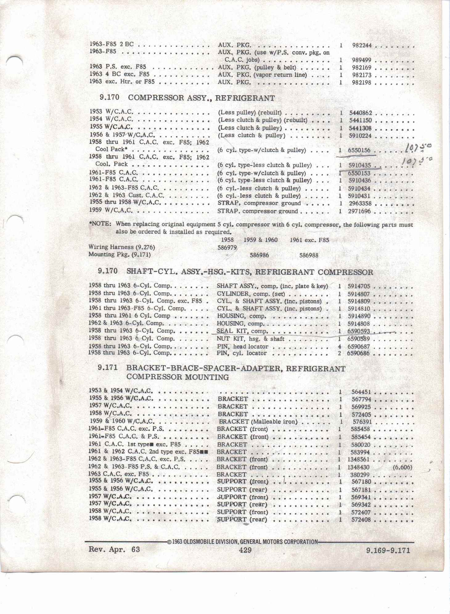

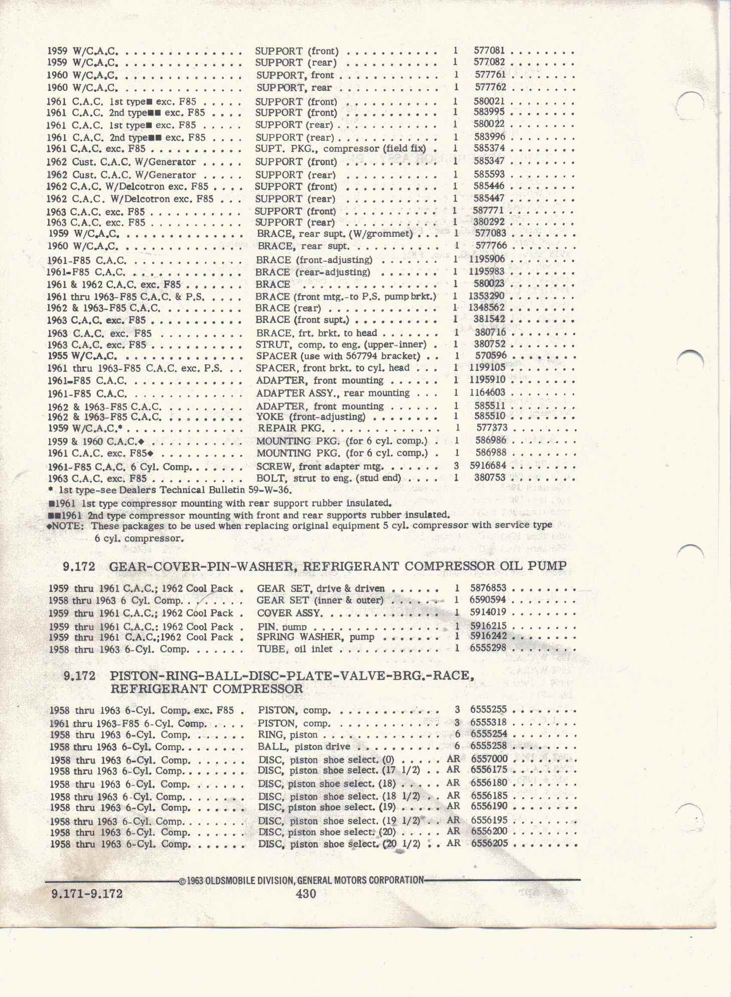

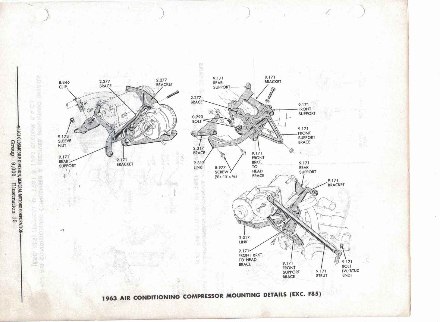

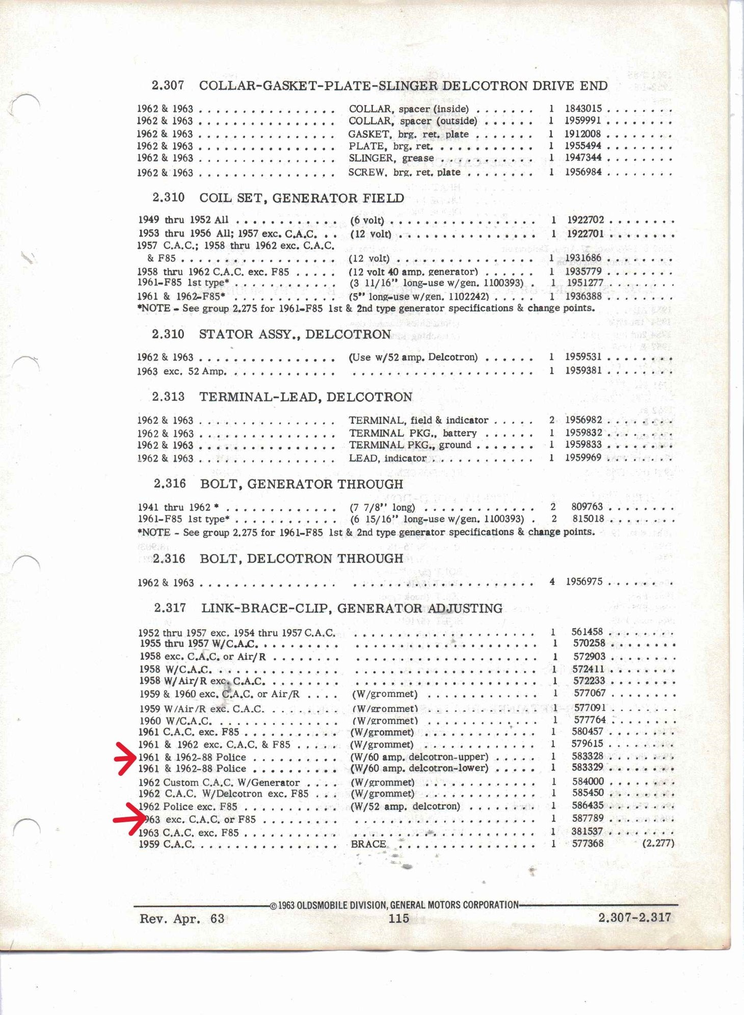

Assuming this is a 394, the following illustrations and parts lists may help.
The is no guarantee that any of these items will fit on a 1958 engine however.
In fact, I would bet against it.

Thanks for the assist for sure. I'll digest and see what I can learn. Very much appreciated. My hope is that , since block on the 394 and my 371 are similar, and accessory drive all keeps spinning items in same basic spots, that I can use the 62 stuff along with custom brackets where needed. Not sure I'll get that lucky but it appears I have little choice unless I scrap the AC entirely.

The key is in group 9.171. They made packages to update from 5 cylinder to 6 cylinder compressors, but only for '59, '60 and '61.
https://oldsobsolete.com/products-pa...986/#gsc.tab=0
https://oldsobsolete.com/products-pa...988/#gsc.tab=0
Looking at those pictures, it looks like that " kit " could be made by someone talented at metalwork,

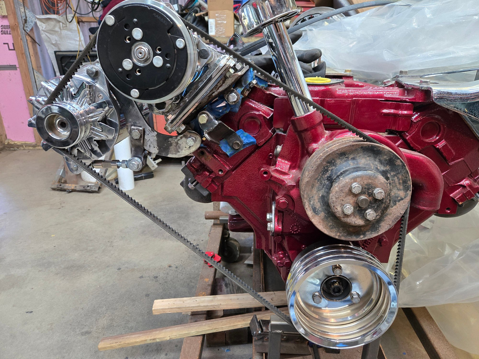

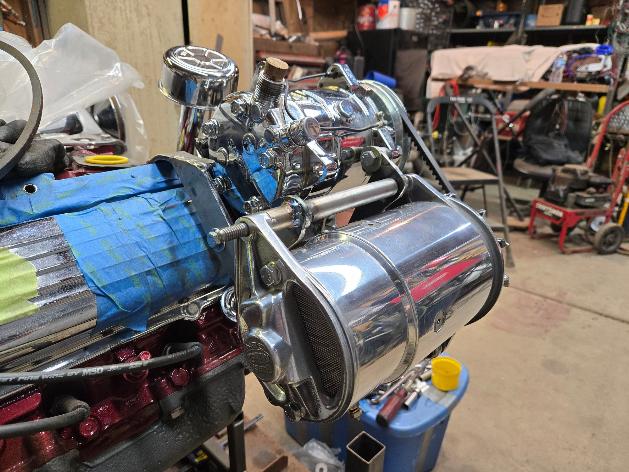

62 Starfire ac brackets
I made my own because the original brackets would not fit newer compressors.

Old Aug 10, 2025 | 06:55 PM
377rickspina's Avatar
58 heather 88
Joined: Sep 2022
Posts: 20
From: Michigan
Nicely done!!! gives me a road map!
