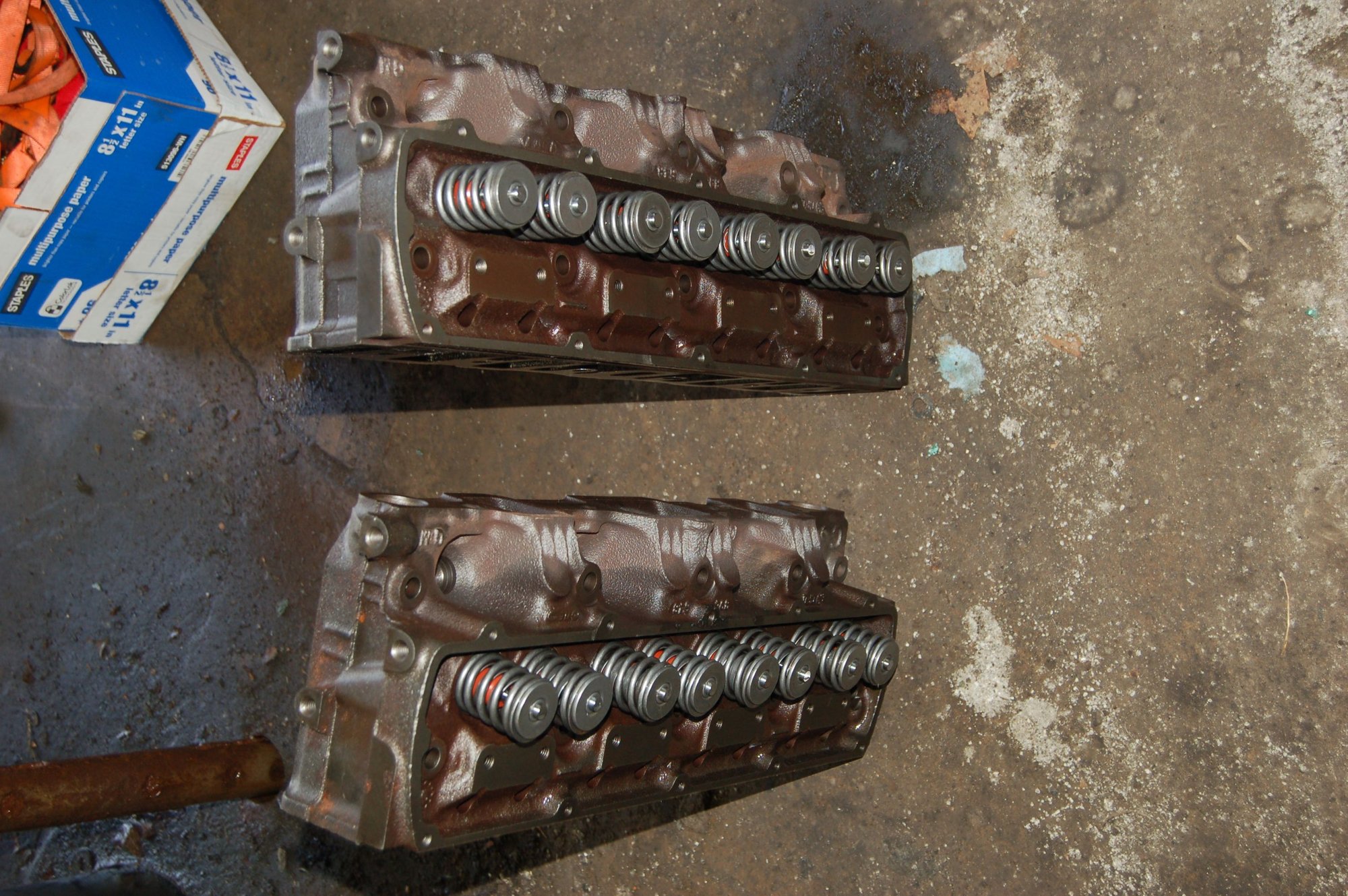

I think 3500 for a rebuild is wishful thinking especially knowing the motor is stuck. I just dealt with a stuck motor and it wasn't pretty . My 455 build came in around 6000 and i did a lot of the work myself. The machine work in my neck of the woods is pricey.whatever your decision i hope it works out well for you.
