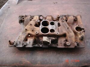

On my intake manifold I have 7 ports on each side, the end ones are water ports, the next two from either end are fuel inlet ports, but what is the middle port? is this another water port?
Old Oct 1, 2020 | 04:09 AM
The center port is an exhaust crossover port. It is designed to heat the carb pad.
