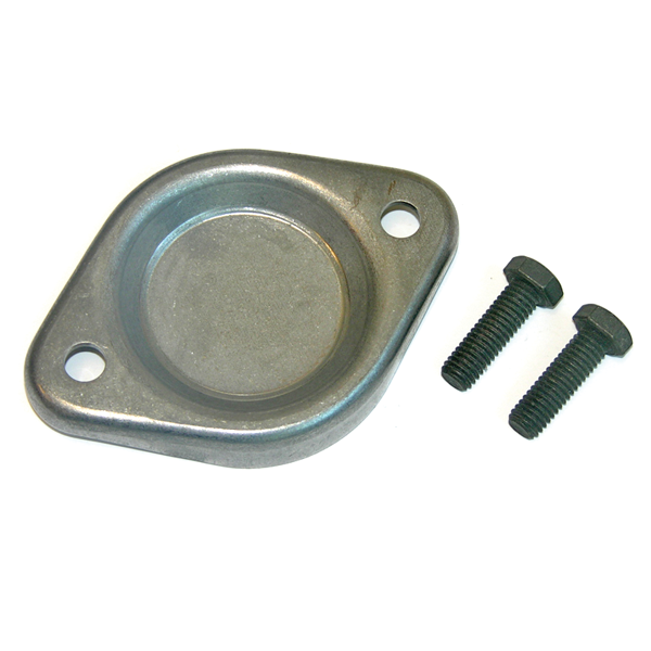

The block off plate looks like this. It blocks off the outlet that feeds the opposite exhaust manifold to run duals. Any muffler shop can also fabricate one inexpensively.
Old Sep 19, 2014 | 06:45 AM
Posts: 50,802
This is how the factory did dual exhausts on the small block (including the W-31s). The factory block-off plate was heavy stamped steel. Repros are available from all the usual sources.
Eric... and Joe.... Forgive My ignorance. Block off plate? Will these installed allow Me to run headers for My 330? I'm in headers 101 class here!
