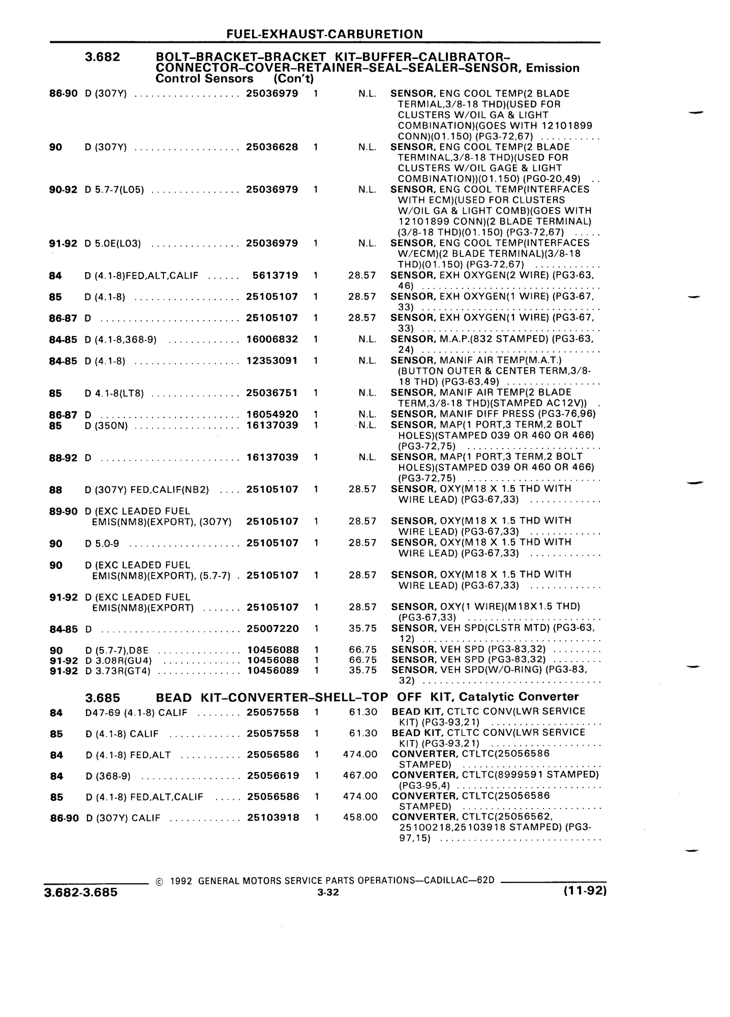

Originally Posted by 87Brougham307
So now you made me curious, i dont know about a DP sensor, on my Brougham the MAP and BAP sensor are the same but i never heard of a DP sensor.
One of the issues is that many people call the sensor a MAP sensor no matter what it actually is or does. Since they all look similar. So it can get confusing.
You have an 87 Caddy Brougham with a 307 V8, right? Back in 1992, GM listed the part number for your 87 D/P sensor as 16054920.
Again, other GM part numbers for the correct D/P sensor according to the parts information is 16006834 and 16231141.
See here in the 1992 parts book. Part#
16054920. About 1/2 way down the page. 86-87 used the D/P sensor. Not saying this is the issue, but if you put a MAP sensor in it, that MAY be the issue as they work backwards in voltage than a D/P sensor. As stated, all those sensors, MAP, Baro, and D/P, look almost identical from the outside. I've never swapped them so I don't know what would happen, but there's a reason they're the way they are.
And here's one on ebay, erroneously listed as a MAP sensor. It's actually a D/P sensor.
NEW OEM GM 16054920 Acdelco Manifold Pressure MAP Barometric Sensor 1980-1995 | eBay
