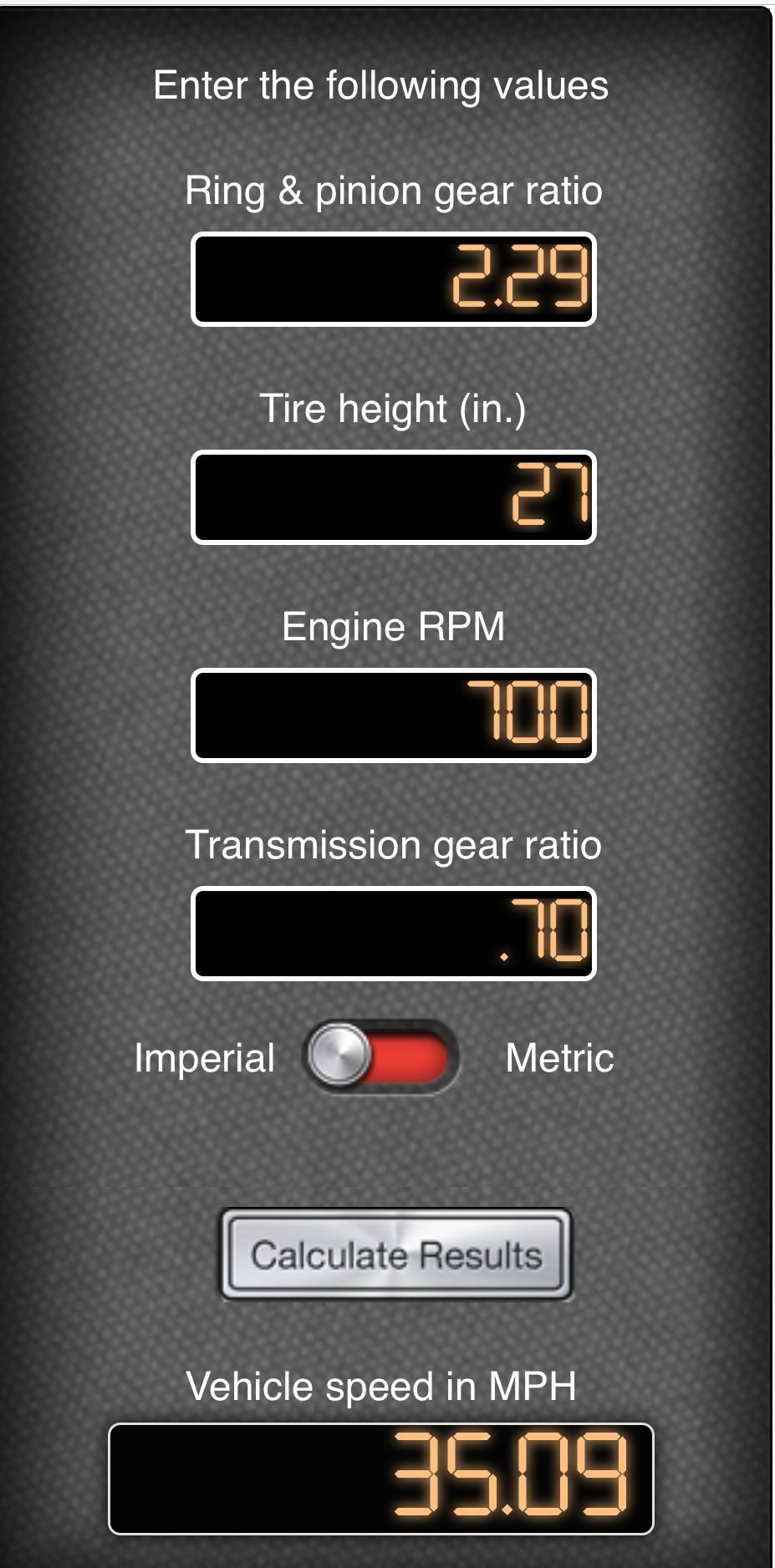

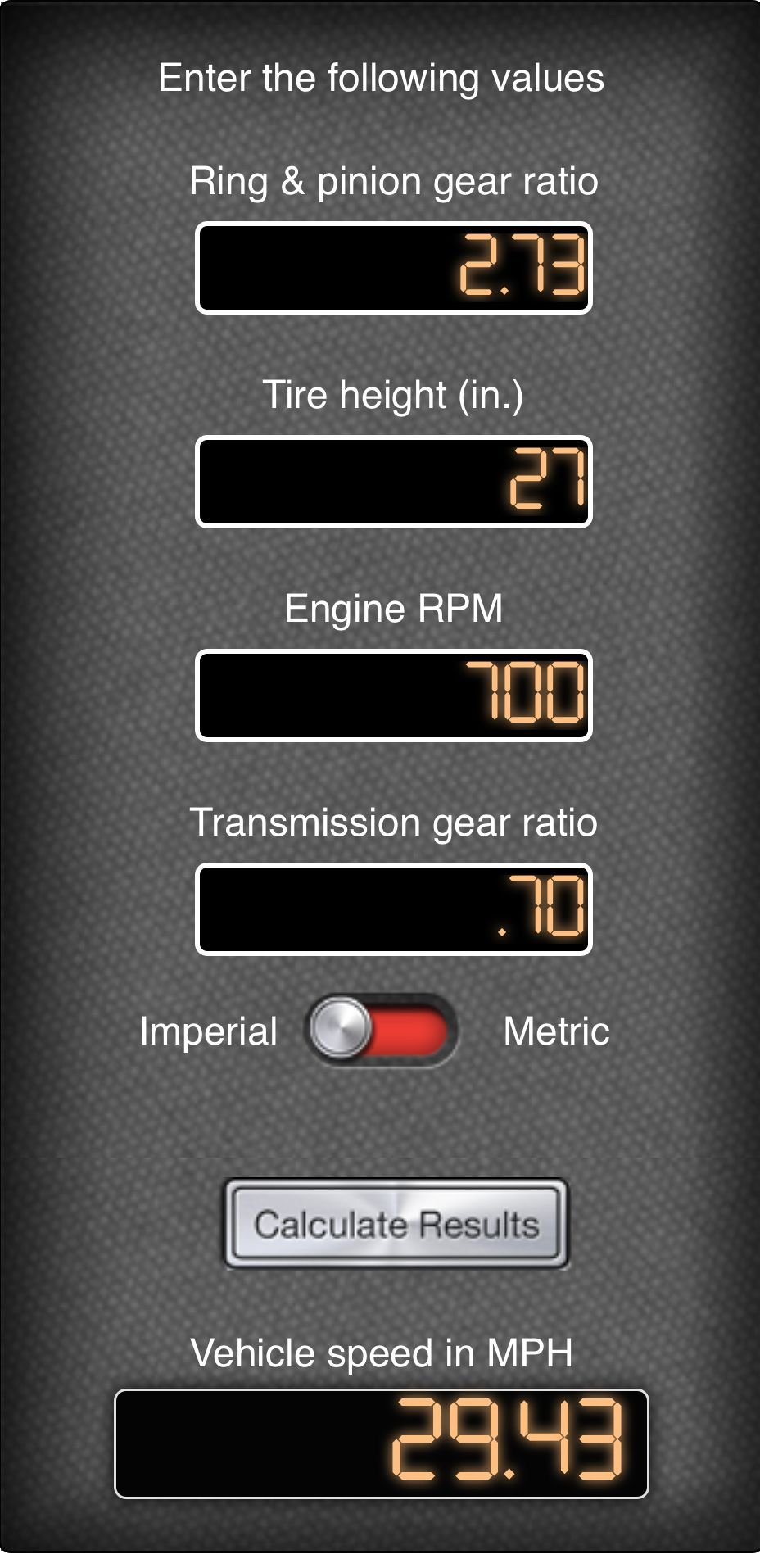

I guess lugging isnt the word I should have used. I suppose you could run a highway gear with overdrive, but the engine would be barely above idle at highway speed. Having the transmission downshift with the slightest headwind or hill would get annoying.
Ill say again, unless your willing to gear the car to be able to effectively use a overdrive trans, what’s the point? What’s the point in having a 4 speed trans if your only using 3 of them 90% of the time?
My my wife had a Chrysler 200 with the 9 speed trans. It wouldn’t shift into 9th gear until about 70mph. It also shifted about 3 times crossing an intersection. Obviously, there was absolutely nothing wrong with the car or the way it drove, it was just a big adjustment from my 69, and my 06 Ram diesel with its “primitive” 4 speed trans.
Im including a snapshot of a gear ratio/speed calculator. Note the 2.29 gear ratio, a 700 rpm engine speed (typical hot idle speed) common 27 inch diameter tires, and .70 high gear of a 4L60, or 2004R. With those parameters, idling at 35 mph isn’t practical.
