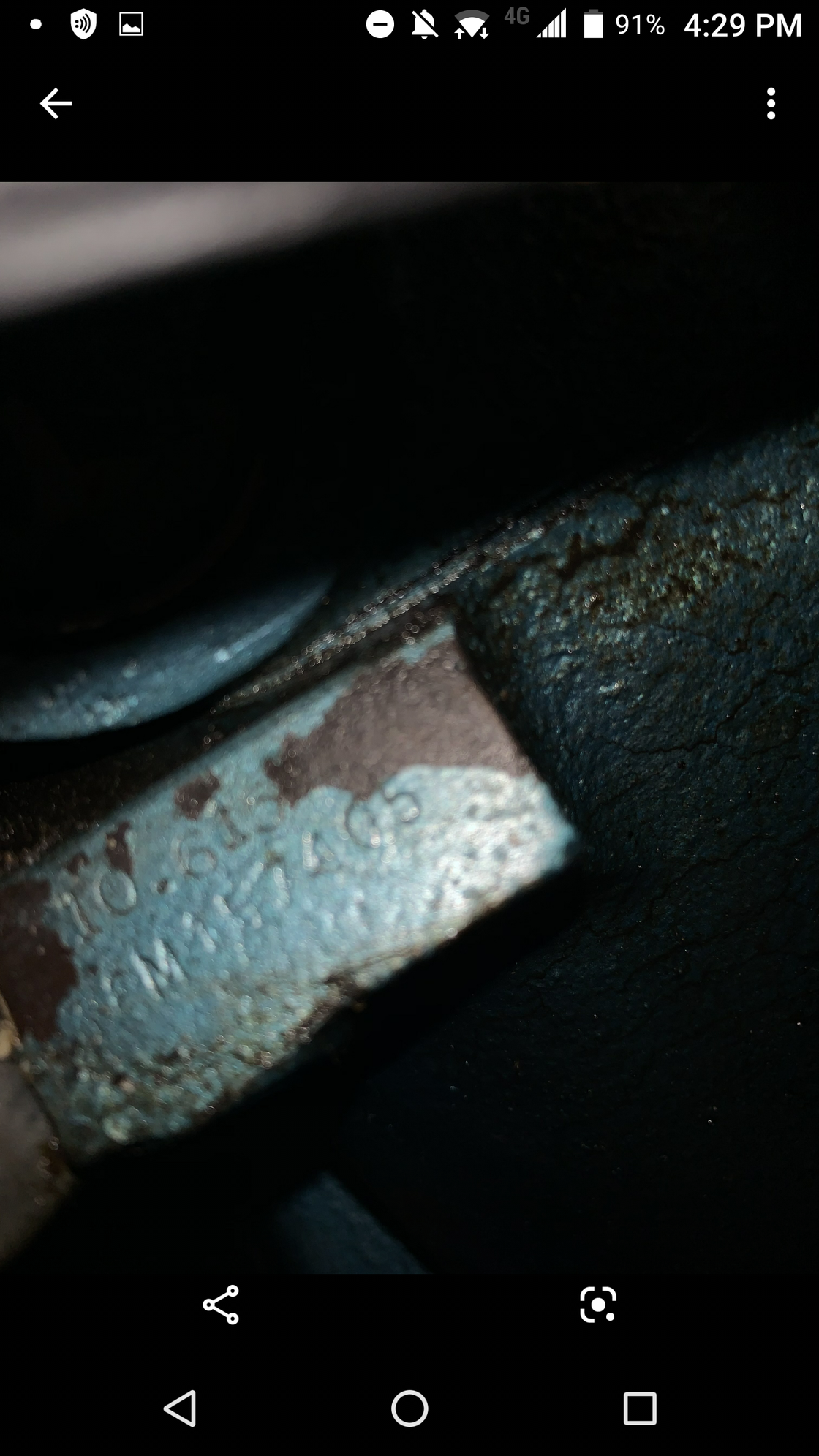

I am attaching photographs of the '72 with the"442 appearance option." The photographs show the car in the "original triple black.". The car was originally #57 baroque gold, black top and black interior. The current color is white.
You will see 442, not Cutlass Supreme on the glovebox.
According to the seller, this photograph depicts the car in it's "original triple black" paint.
Another photograph of the car in it's "original triple black" paint.
Photograph of the trim tag. Please note the paint code 57.
Photograph of the vin derivative of the "original 455 engine born with the car."
Old Feb 5, 2020 | 02:01 PM

Thankfully, I knew to ask for the vin number and compare the vin derivative to the car. Now I understand why sellers become defensive when asked for vin derivatives of the engines, transmissions, broadcast cards and other documentation.
The seller currently knows that the "engine and transmission are not original to the car." Further, the seller told me today that the car has a '72 455 CI engine.
I know everyone is entitled to a reasonable profit, but the profit margin on this car is excessive.

Well, sounds like you dodged a bullet. Good for you, imagine had you gone forward on face value...
Absolutely!! Thankfully, I know enough about the '72's to look for the U,V or X code. The lack of any of those codes raised the red flag. Numbers provided didn't tie into the VIN. And after another member posted the car was purchased for 23K and is currently selling for 53K, over a 100% profit margin, I really became disturbed.
The seller insists the engine is a '72 455 and now admits the car was born with a 350CI 4bbl.and now admits the car was originally born #57, baroque gold. He may be monitoring our site.
Irrespective of whether he is or isn't monitoring our site, I want all of our members to know the seller is:
Capital City Auto Collection, Mike Reed, (844) 294-5009: Cel number,517-719-0190; Email: mreedcapcityauto@gmail.com
Website: http://capcityautocollections.com/
The car is currently white with a black convertible top and black interior.
The car is also listed on other websites.
BEWARE!
He must be related to "Joe from Itasca"
Exhibit A
