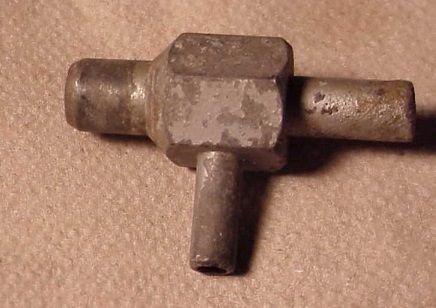

Was this vacuum fitting specific only to certain 1970 Quadrajets?
Old Oct 16, 2020 | 05:53 AM
Yes. The 1971-up carbs used two separate tubes pushed into the rear of the air horn. This was a last-minute addition for the TCS vent line in 1970, thus the kludged tee fitting.
