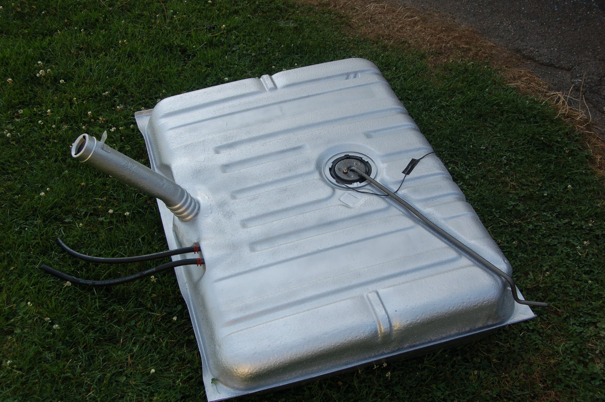

Use a screwdriver and a hammer to rotate the locking ring counterclockwise. In the photo below, the locking ring is the black circle above the sending unit. Once the locking ring is loose you will be able to pull the sending unit up and out. Be careful not to damage the float assembly.

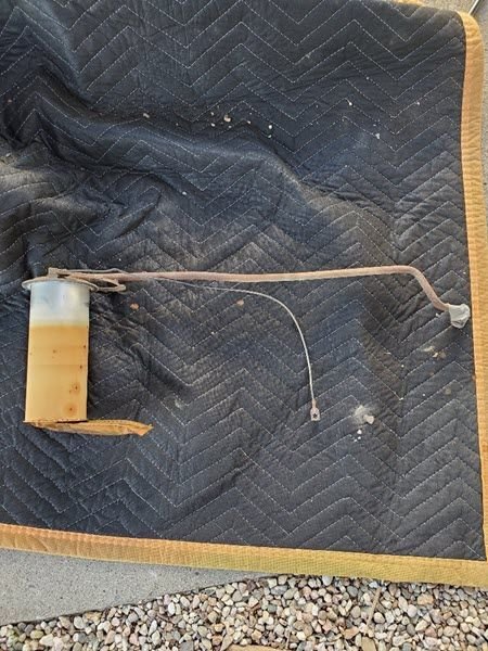

Thanks, it rotated easier than I thought it would. The sending unit is busted anyway, one of the rationale to drop the tank. It's all gooped up, and that sock at the bottom just fell/ripped off of its own weight.
