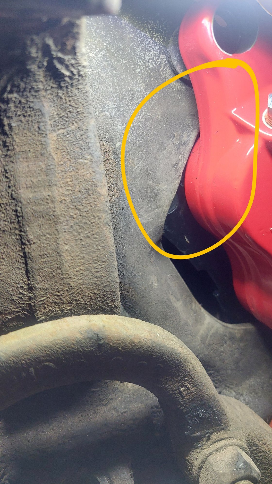

In this picture with no pads installed or just the inner pad the caliper goes on perfect. In the two areas circled the caliper drops all the way down and caliper is flesh with bracket.

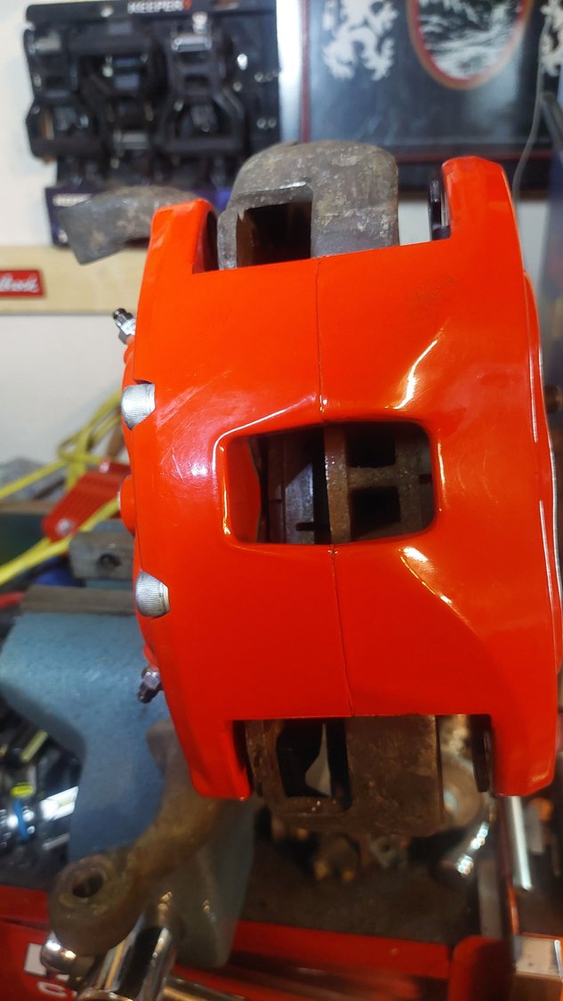

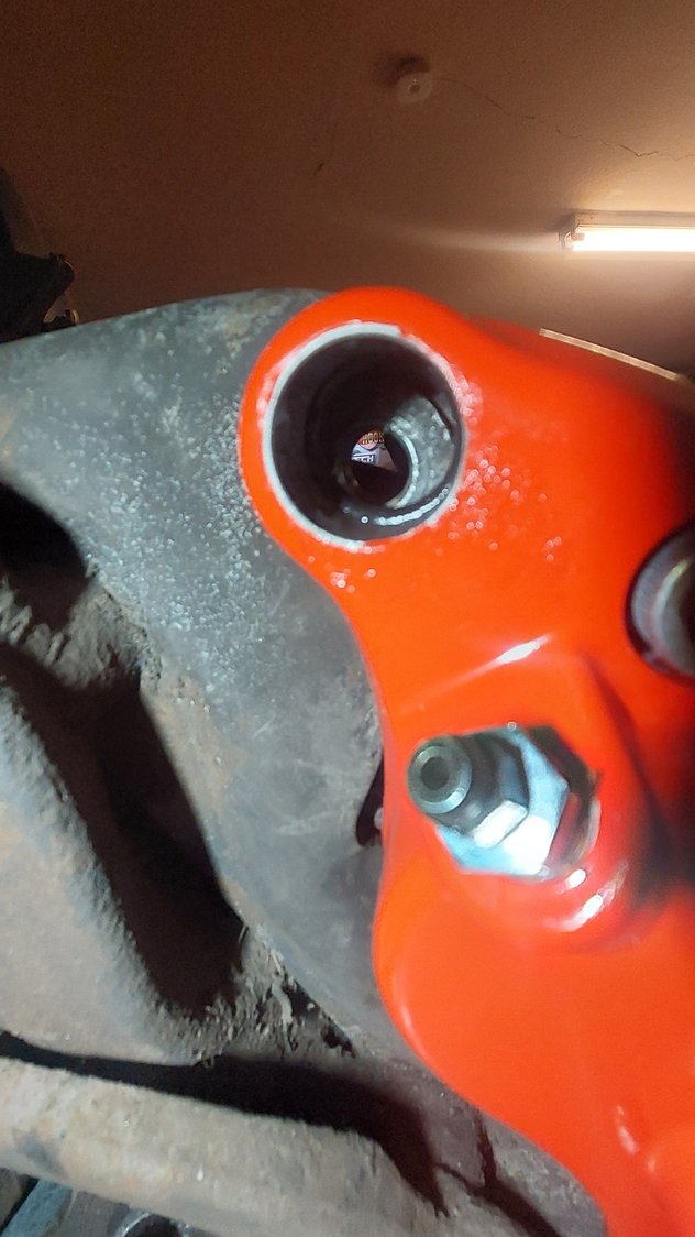

Posts: 20
In these pictures with the outer pad installed the caliper won't drop down into bracket. It appears the outer brake pad is hitting the rotor not letting the caliper move any more to the left. Note in first picture above where the two half's of the caliper come together. If this isn't in the open area of the bracket the caliper won't drop down and the mounting holes don't line up

Old Sep 27, 2024 | 07:51 PM
69olds98's Avatar
Joined: Oct 2017
Posts: 20

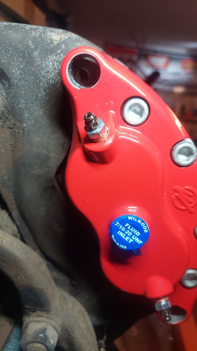

Old Sep 27, 2024 | 07:54 PM
69olds98's Avatar
Joined: Oct 2017
Posts: 20
It looks like it's hitting in this area circled. Maybe I can just grind this area down?
Old Sep 27, 2024 | 08:02 PM
69olds98's Avatar
Joined: Oct 2017
Posts: 20
If I tilt the caliper so the top hole lines up then the bottom hole is off in this picture. If grinding the spindle is the solution looks like it would need to happen at the bottom.
Old Sep 28, 2024 | 06:35 AM
Yes, that is the problem. When you leave the pad out, the caliper fits over that bracket because it isn't in the correct position relative to the bracket. The original single piston caliper is narrower there, the dual pistons obviously are wider. Simple grinding will solve this. That's not the spindle, it's just the bolt-on caliper bracket. The other thing to note is that the caliper moves away from that bracket as the pads wear, so you don't have to go wild when grinding. And I'll also point out that as I noted above, Wilwood's tech line response on this was completely wrong. This has nothing to do with the rotors. Again, I'm sure they've never even seen a full size Olds with disc brakes. These particular D52 calipers were sized to fit the half-ton GM full size pickups.

69olds98's Avatar
Joined: Oct 2017
Posts: 20
Thank you! I only had to gring a small amount on the bottom and the caliper goes right in now.
