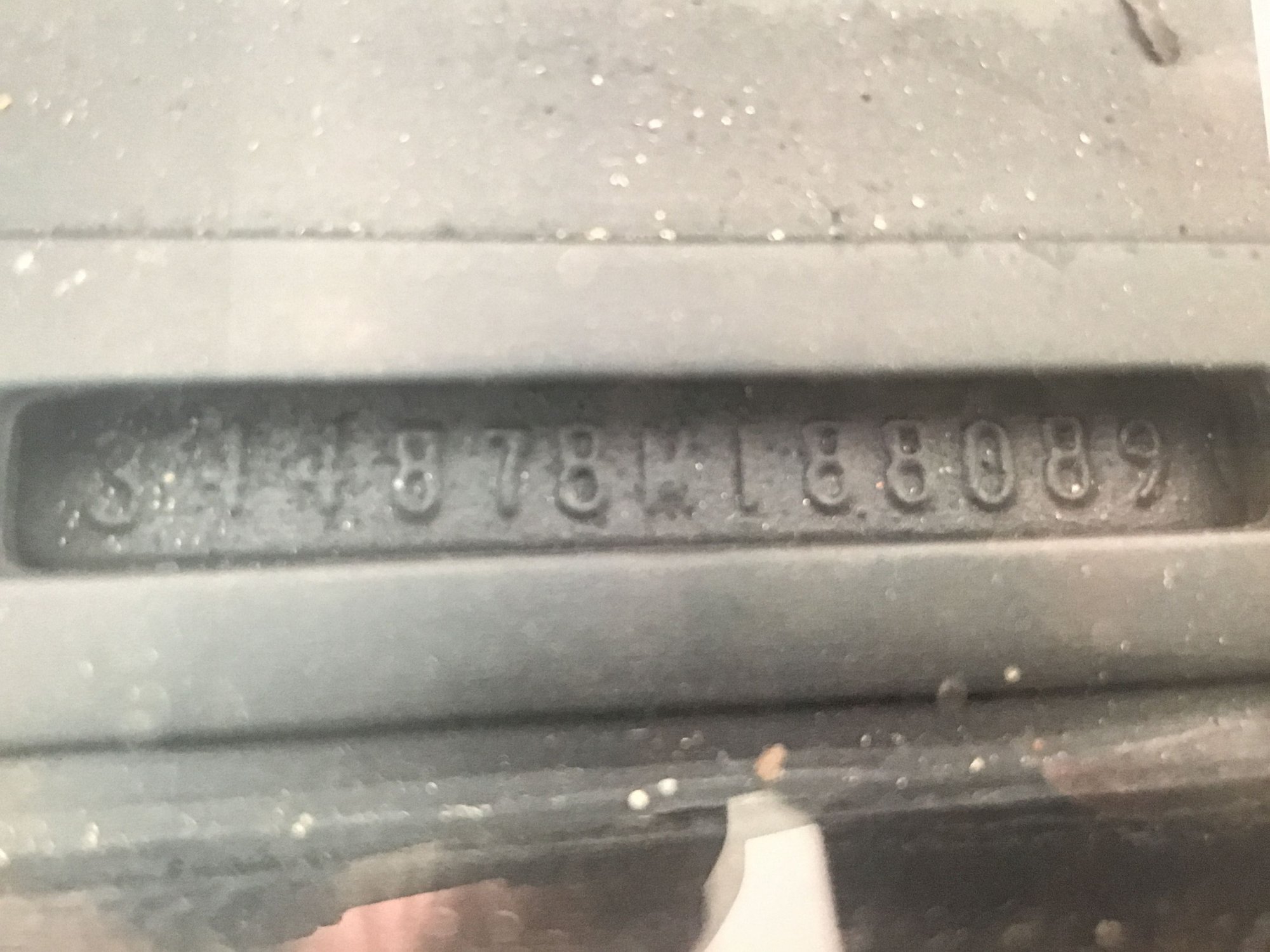

Old Mar 28, 2024 | 06:38 PM
Posts: 26,066
Post a picture/image of the VIN and post a picture/image of the VIN Derivative located on the engine block. If they match, that will tell you that engine came in that car off the assembly line - if they don't match...guess what.
Old Mar 28, 2024 | 11:28 PM
Posts: 16,712
I think he's pretty much determined that it doesn't have the original matching G-block, Norm. Now he just wants to know how it was equipped from the factory 56 years ago.
To OP: unless the car was built or first sold in Canada, or it came with paperwork, or you get lucky and find a build sheet, there's really no way of knowing how your car was originally equipped.
However, if you post the VIN and cowl tag, we might be able to provide a few clues.

It's probably a Cutlass, not a 442. Like 4 people have said, post the vin to know.
Old Mar 29, 2024 | 11:21 AM
Posts: 16,712
We can also determine where it was built, which could be the key to whether or not it's possible to document the car further.

A 1968 442 with a replacement engine is nothing unusual. Those long-stroke G block 400s were better suited to truck and station wagon duty than high-revving performance.
Post the first 7 characters in the VIN i.e. 344878Mxxxxxx. That's all we need to tell us definitively if the car started life as a 442.

After 50+ years, anything is possible. If I had to put money on it, I'd say it's a Cutlass (with a Cutlass VIN and 2bbl 350) that somebody stuck a few repro 442 badges on rather than a legit 442 that someone swapped a 350 into.
Old Apr 1, 2024 | 04:18 PM
Iguanaman's Avatar
Joined: Mar 2024
Posts: 8
It’s a legit 442, vin has been verified with the sheriffs dept here.
