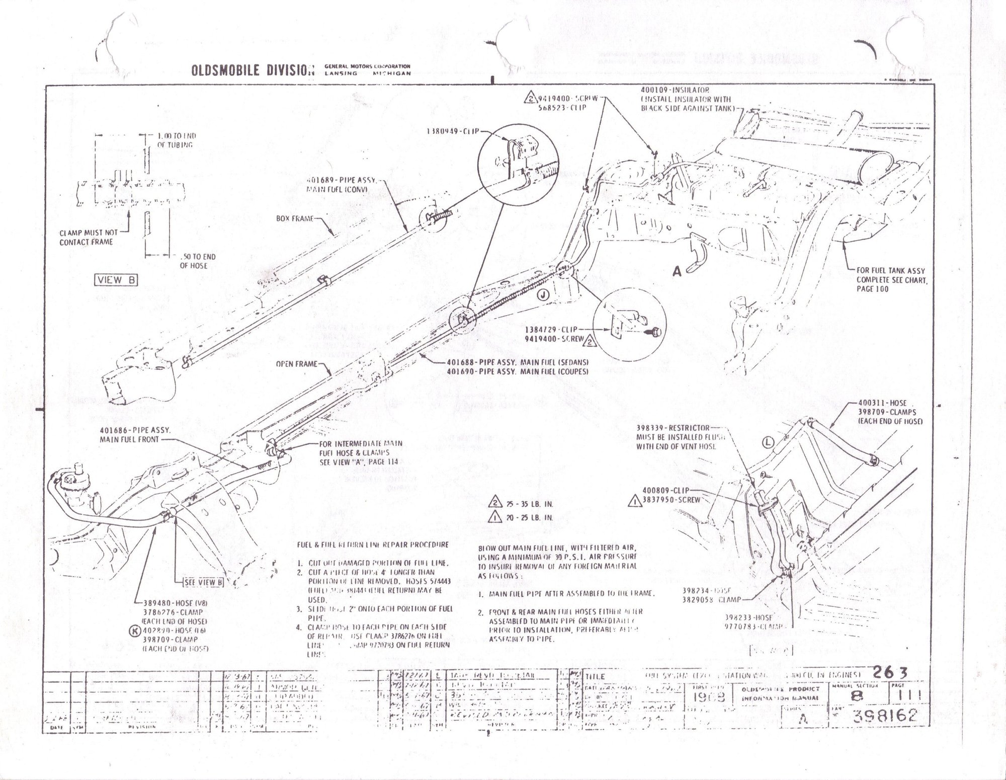

So it looks like somebody messed with the vent lines and did a pigtail with them can anybody send me a photo on how it’s supposed to be routed. They even capped off one of the vents. Thank you for all the help.

THe two vent hoses are supposed to come up above the clip that's holding your single-looped hose in place. The hose on the left, as I recall, is slightly larger than the hose on the right. As well, the hose on the left is supposed to have something called a restrictor (looks like a piece of spongy material to me) plugged into the hose. I never liked that set-up so, instead of trying to find something to simulate a "restrictor", I went with the set-up used on the '69 models, which Fusick reproduces. I have an old Fusick catalog and their part number for it was GTF690K, gas tank vent tube filter kit. You can look it up in Fusick's on-line catalog at www.fusickautomotiveproducts.com. It just seems to be a more sensible set-up than the one used for the '68 model year.

What I am saying is shown in the lower right side of the '68 A-Body Olds PIM, manual section 8, page 111, which shows the dual vent tube set-up for the gas tank. Randy C.
PS: That filter set-up was amended with the '69 model year to show the filter set-up that Fusick offers as a reproduction.

^^^What Randy said. Small piece of foam stuffed into the top of the 1/2" hose.
