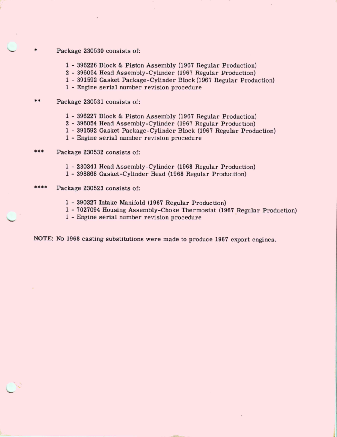

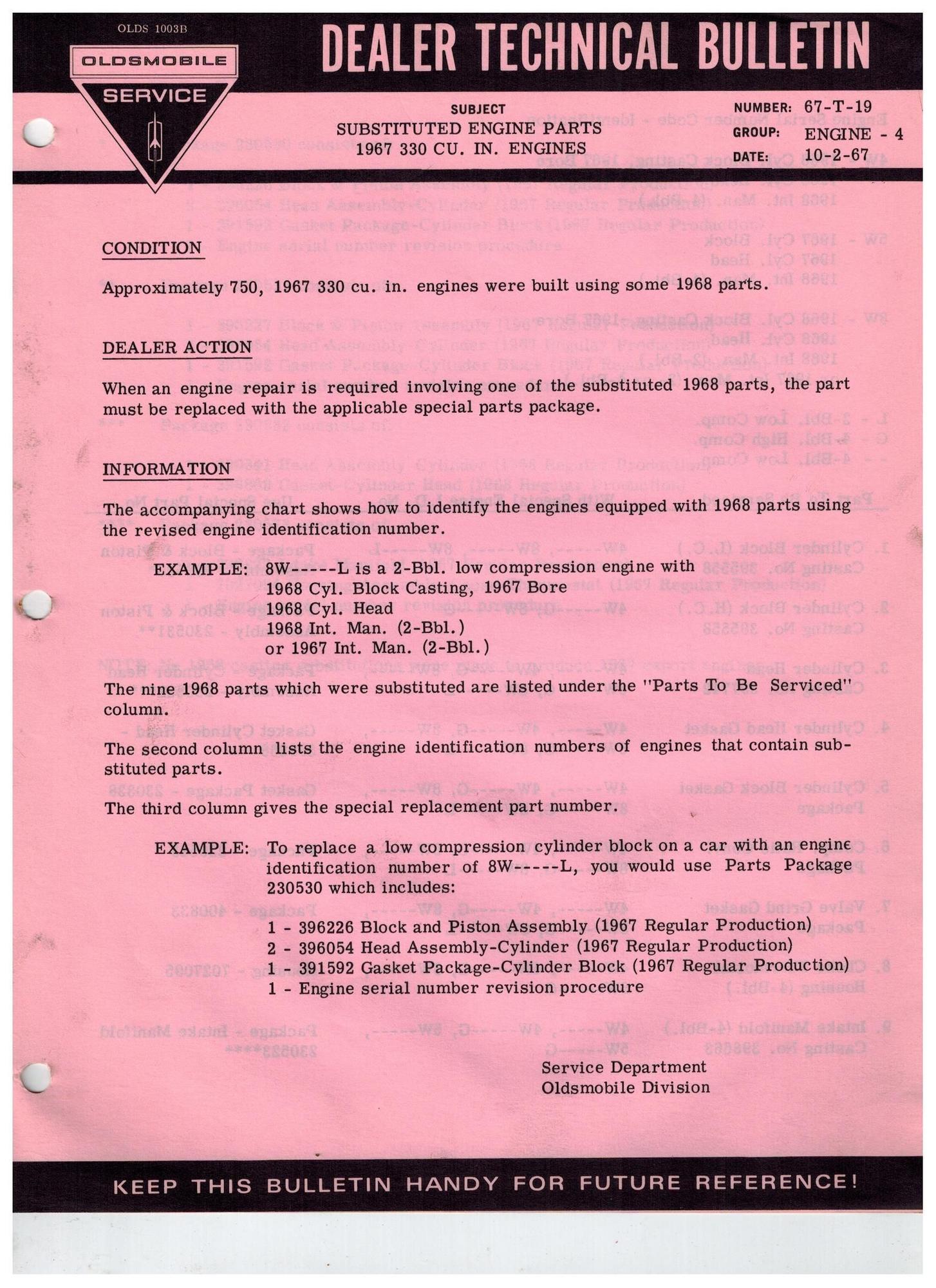

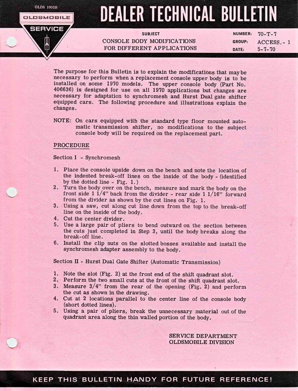

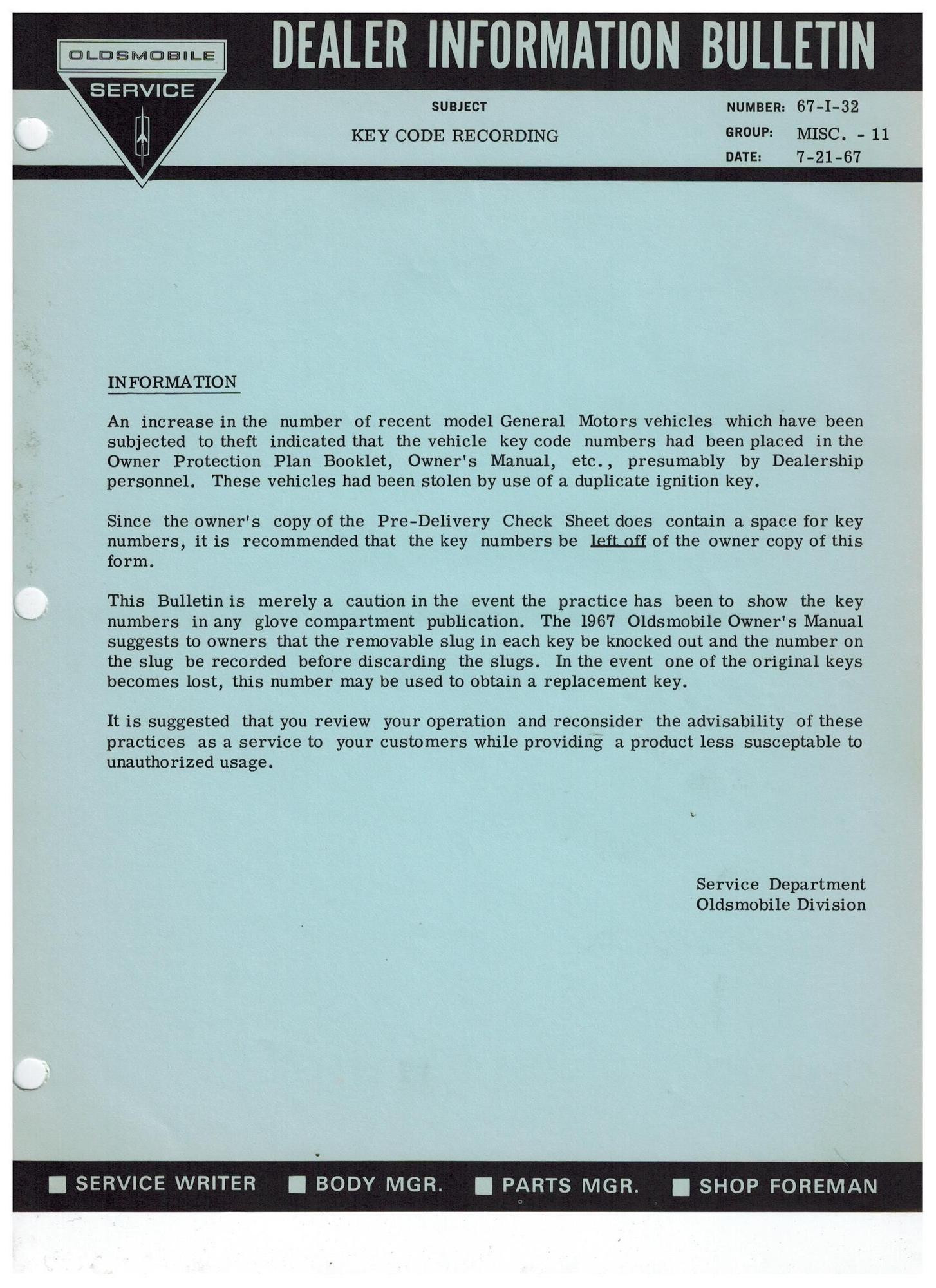

Scott Winn sold a bunch of manuals and literature a few weeks ago. One of the items I purchased from him is a binder called Technical Bulletins and Service Guild dated 1967. As I skimmed through the contents I thought this must have been something provided to each dealership. So there should be a number of these floating around out there. This is the first time I've seen one, do other members here have copies of these from various years? Much of the contents strikes me as simple details on how to resolve issues that came up. But there's a few that contain interesting information I've never heard before. Attached are scans of a couple of these.

John, I've posted 67-T-19 previously. Here it is again for reference.
I'll also point out once again that the stories of "anything was possible" on the assembly line are BS. Olds issued complete documentation when a change was made like this. The parts book also documents this change.

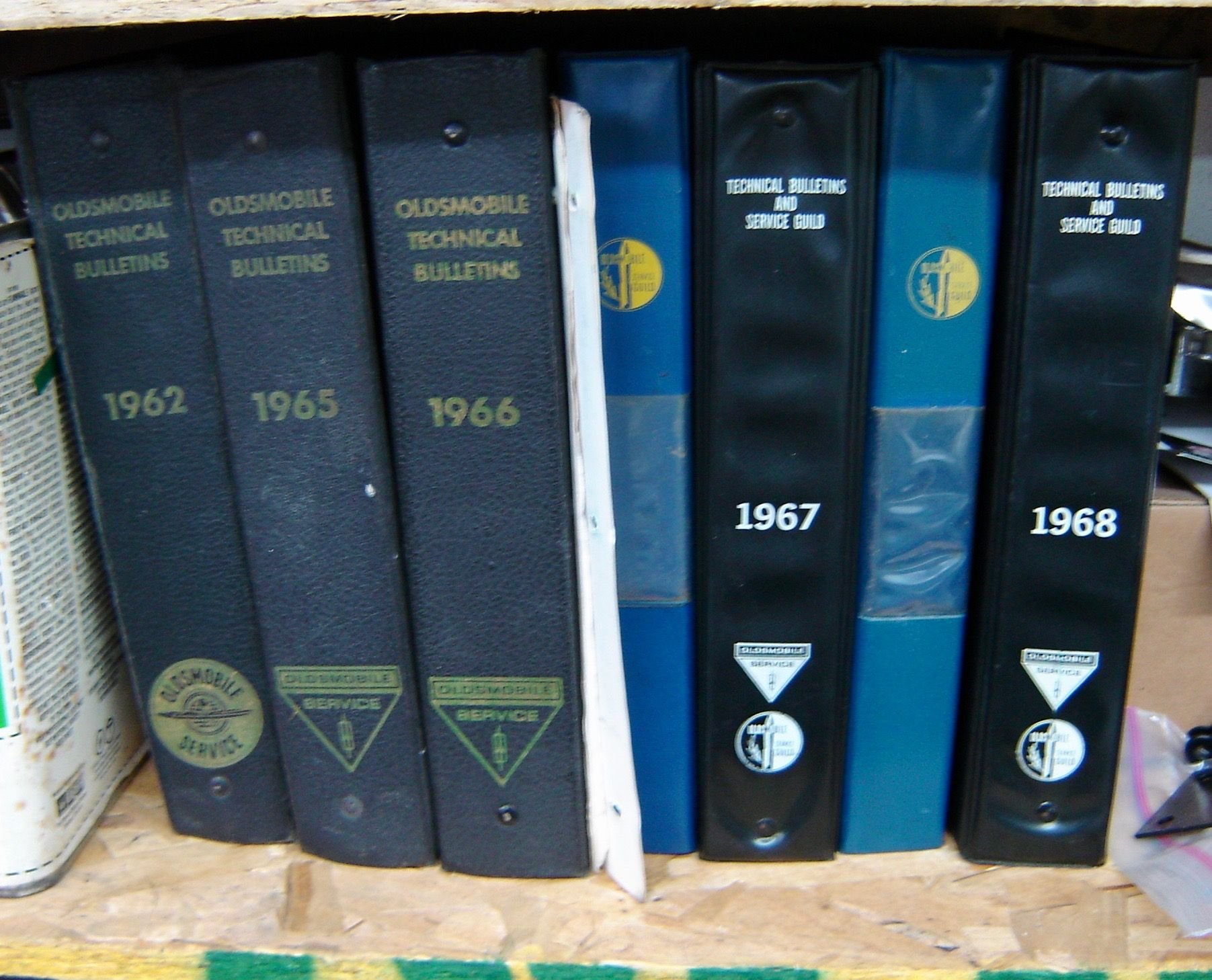

I'm missing a few years but I have 2 binders for 67 and 68.

I have the '68 binder.

I have a '68 and a '69. Comprehensive info!!
