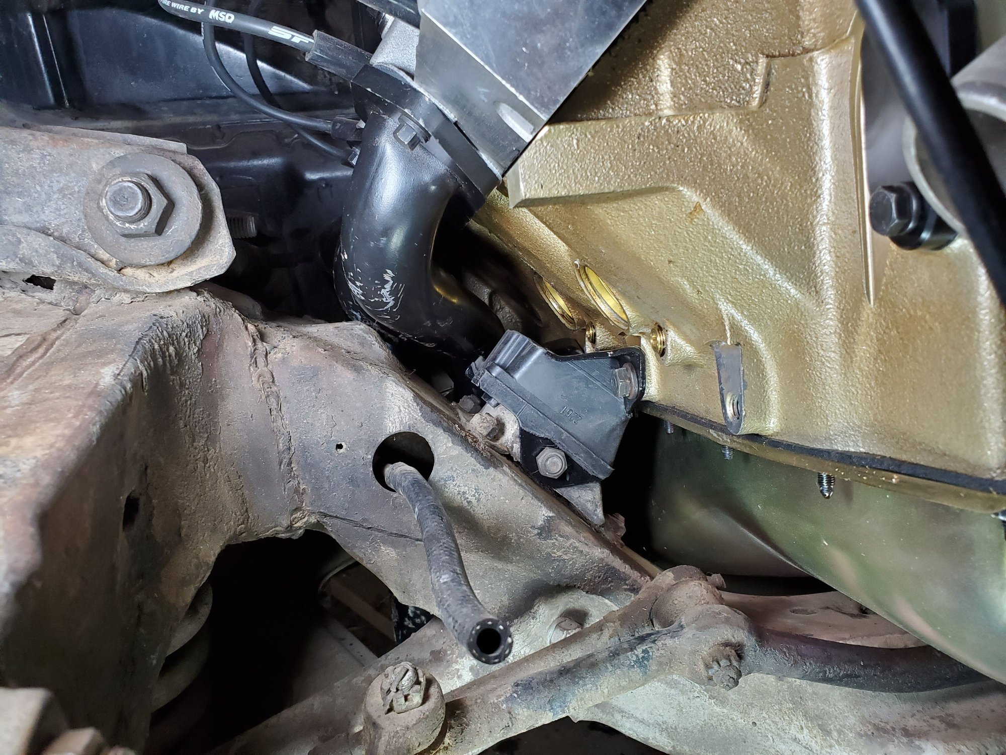

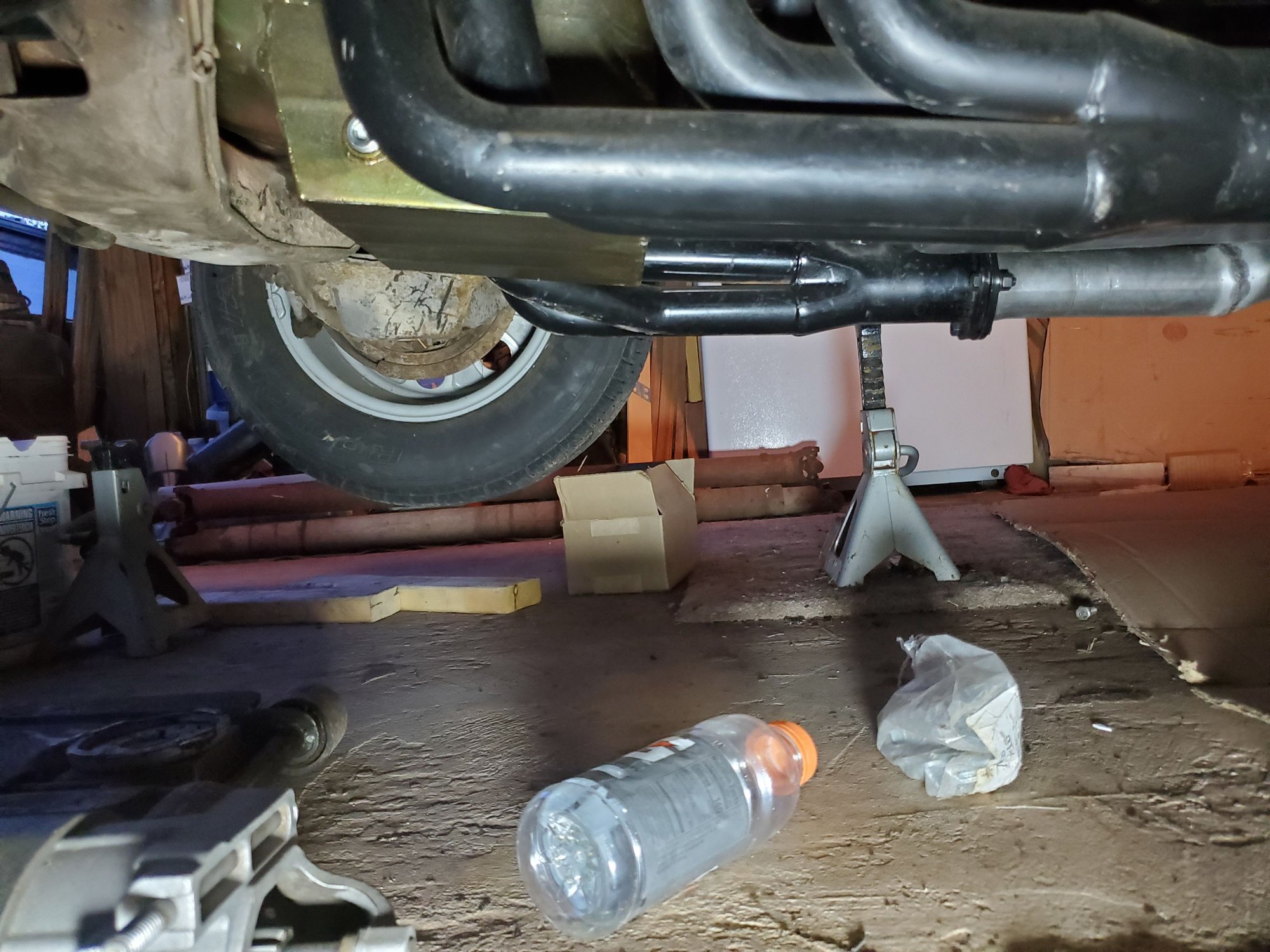

Flowtech headers will fit. I put them on my 67 with a 350 block engine. Passenger side fit unmodified. No clearance issues at all. Driver side needed to be massaged in two locations, one for the motor mount and one for the starter. I suspect that at least the mount location would not need clearancing on the 400 engine. The starter may not need clearancing on the big block either but I'm not sure on that. They are budget oriented so the collector gaskets that come with are paper junk so get some good ones. My good ones came with the exhaust system from JEGs.

the starter is no problem just go with a mini starter. looks like summit's headers are the same as doug's headers.

I did use a mini starter but the battery connection is on the side so I had to make clearance for that.
