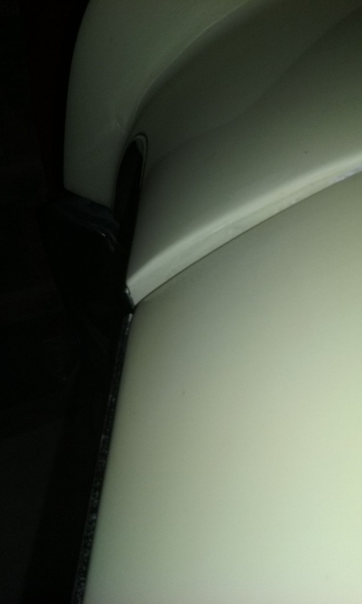

My 67 442 hood is short on the radius in the front of the hood. The hood radius is different than than the fender radius. The fenders don not have the extensions, mine are 1 pc fenders. The hood install went reasonabily good but I can't get the radius to match. I suspect that the hood has been damaged and I am wondering if anyone know the proper and correct way to correct my issue. Also there is a small difference from the left ( the worse of the two ). The radius seems to be flatter on the driver side.

Sounds like your fenders and radiator support are not square with the body. Can you post pictures of what your dealing with including one with the rear of the hood closed against the defroster vent grill.

My bad guys, you got me thinking, so I went out and checked, the fenders DO indeed have the extensions, the owner before me aparently filled the seams with BONDO. Now I'm wondering if the left side has the extension for a 66. I know the 67's are longer.

66 and 67 extensions are definitely different in shape and length and the 67 hood will not in any way match up if there is a 66 extension on the fender. How about some pics so we can decifer what the problem is.

Sorry it's been so long. Here are some photos.
