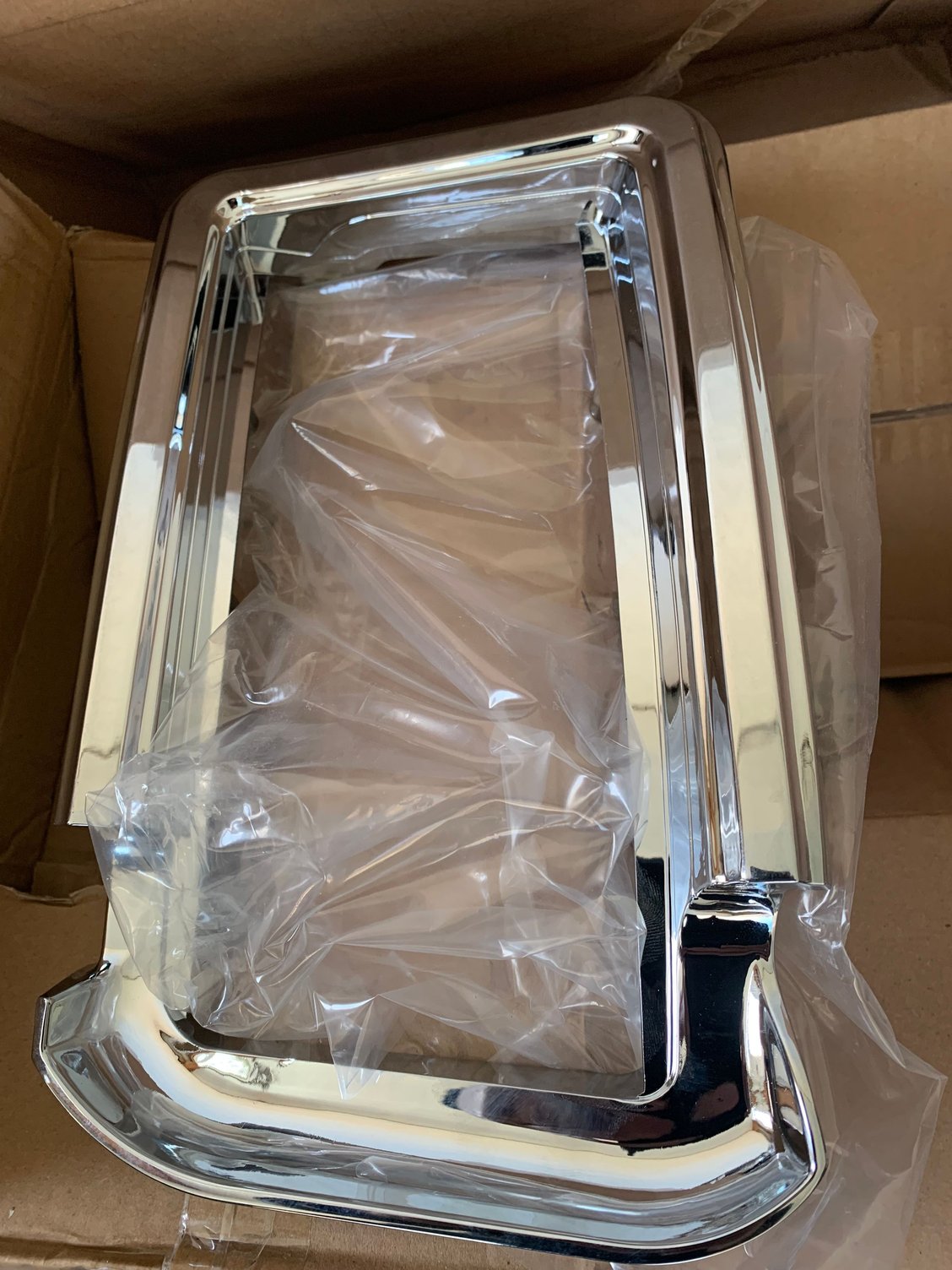

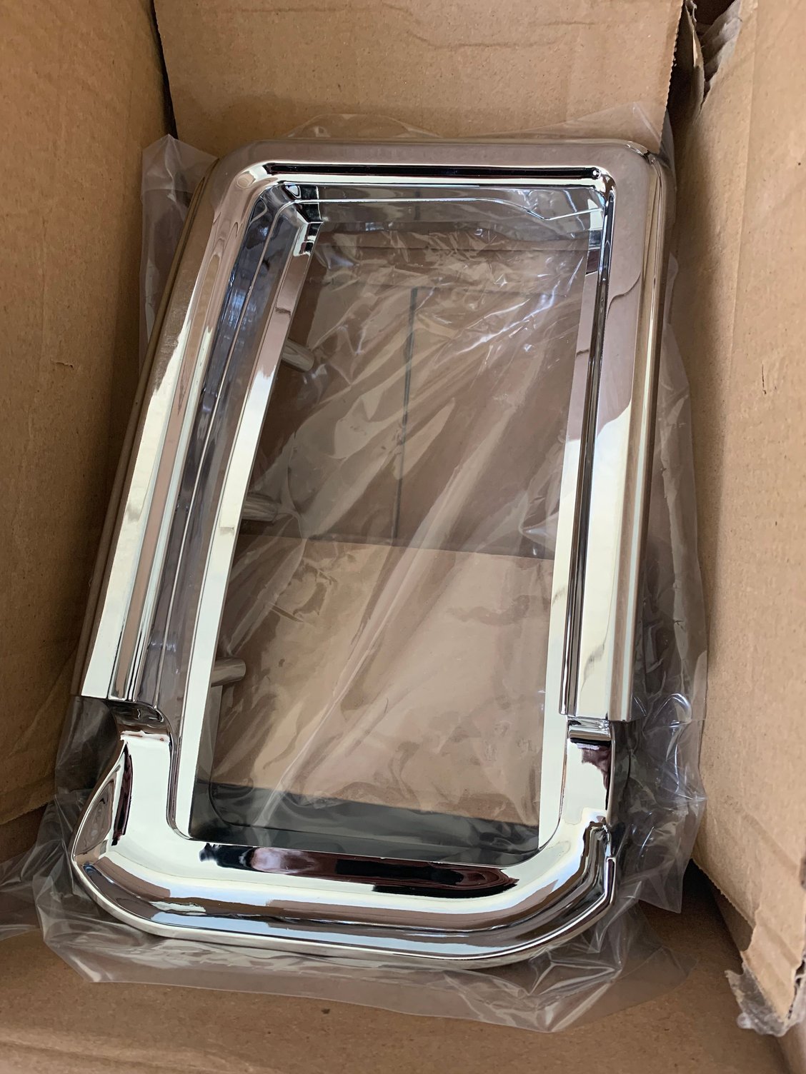

What is the experts appearance and fit review on these?
Chrome plating especially expert restoration of pot metal has been hit by inflation. It was very expensive before and now at least for me is almost beyond practical consideration for a part which could be replaced at much lesser cost. Might be wise to buy a set of these, wrap them in tissue and store them in my dresser drawer for the day final assembly arrives. Anyway, can't imagine losing money over the long term even at $400 final cost if they check out.
Old Nov 24, 2024 | 04:28 PM
Andy's Avatar
Joined: Jan 2020
Posts: 2,831
From: Sarasota Florida
Certainly don’t consider myself an expert but i did put a set on my 66 trac pac car. Fit was perfect, chrome excellent. No issues
Old Dec 1, 2024 | 10:14 AM
coldwar's Avatar
Posts: 784
From: USA Ohio
Thanks Andy and to the others for the avalanche of comments ;-/ They went on sale down to $319 at Thornton's so a pair of those will appear under our Xmas tree this year. Enough of a generous drop to move Santy Claus in to action - CW

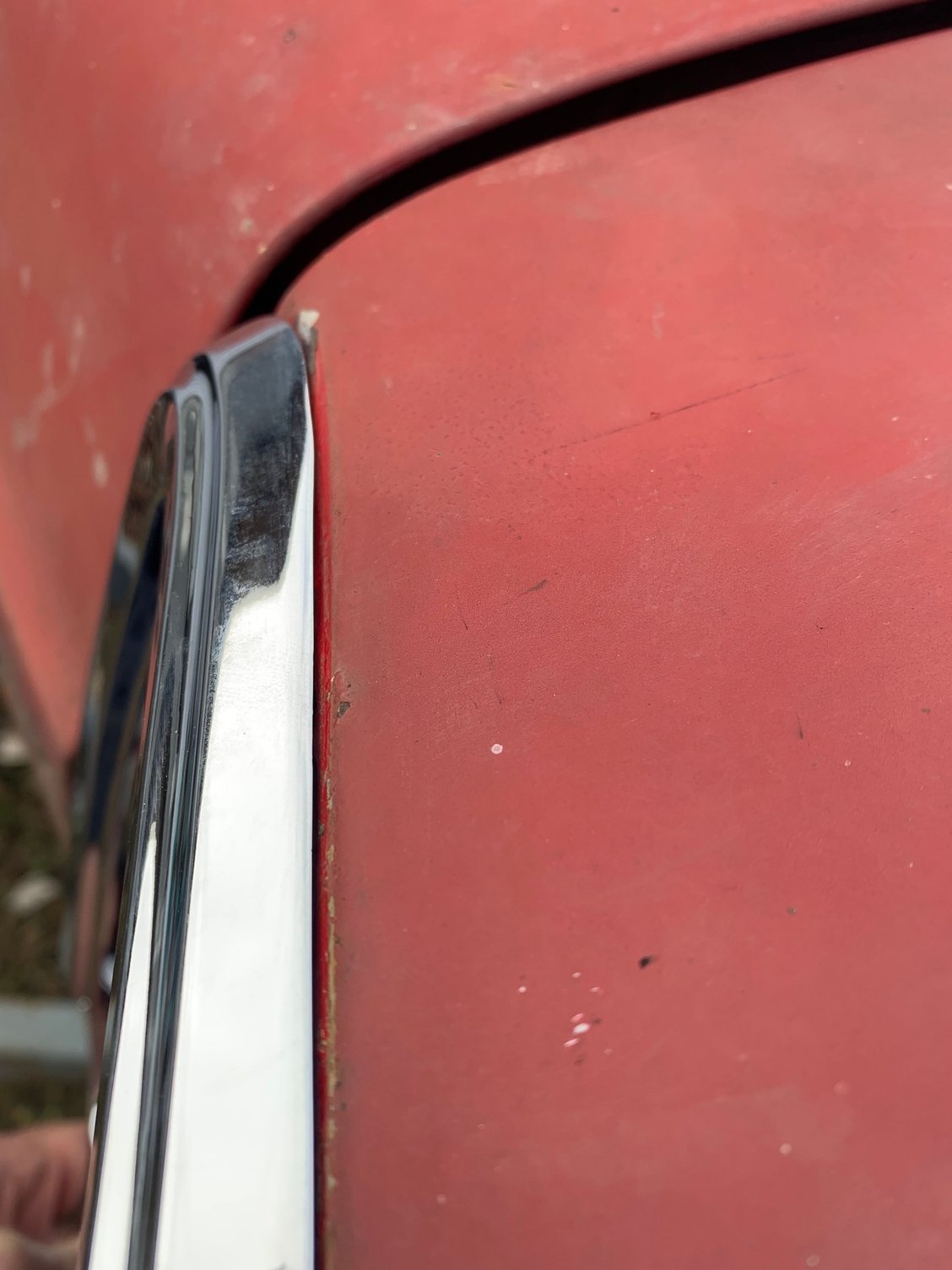

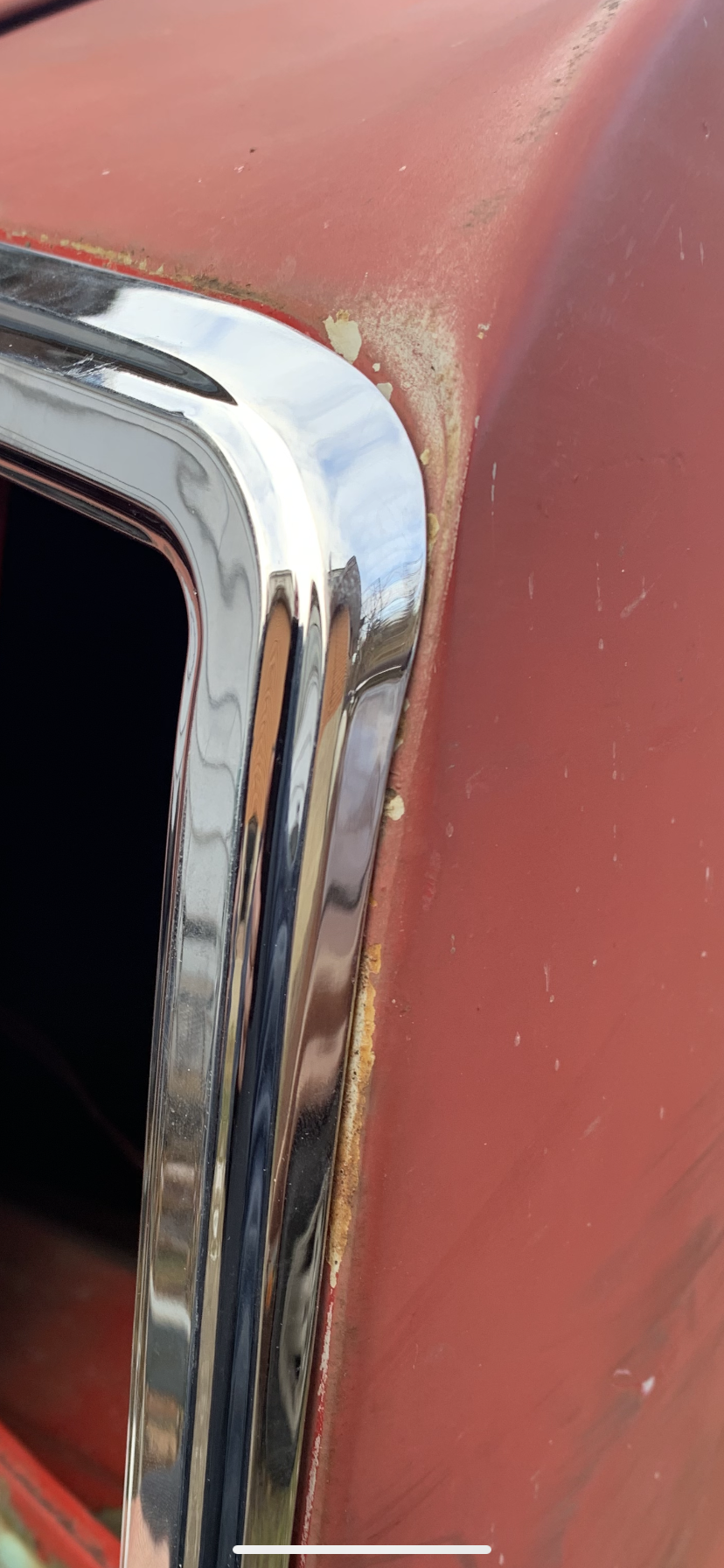

I removed the original bezels after dropping the bumper down a bit. I dry fitted the repops and they're not fitting the contour that well. I thought these were Thornton repops but they may not be. Got them off eBay and vendor is also located in PA , so I thought it may have been a Thornton reseller. I did not fasten them to the lens bucket but I dont think that matters. I still think they are not a great fit. They look great but as I stated, they they don't follow the contour top to bottom and have gaps mostly on top and nearest to the trunk side. I got them from The Motor Company eBay Item number 116397004107 . They are less expensive than the Thornton's, but fitting correctly is definitely more important. I'd imagine that CANADIANOLDS got the Thornton's so would like to know if there are any fitment issues with them. I see that Andy is happy with the Thornton's so just waiting to see if others are happy with them as well.
Old Jan 1, 2025 | 05:53 PM
66-3X2 442's Avatar
Posts: 5,155
From: Birmingham,Alabama
Did you try them with the new outer rubber gaskets? When tightened they conform to the contour better. Thornton is the only vendor for the 66 442 T/L bezels.
Old Jan 1, 2025 | 06:23 PM
OLDScience's Avatar
Joined: Apr 2013
Posts: 157
I took the gasket off and did an A / B comparison. I need new gaskets, and looks like Fusick has them, Pretty pricey, but they're pretty thick and mine are trash. The space between the body and bezel was significant but I did not want to run the fastener in because I may return them.. Going to check again and probably will contact Thornton to see if the ones I bought were his.
Old Jan 1, 2025 | 07:21 PM
OLDScience's Avatar
Joined: Apr 2013
Posts: 157
I just tried to attach the left side bezel to the bucket, and it did not fit until I took an adjustable wrench to the bucket and opened it up a bit. It then fit but not as good as my factory piece. .The interference was on the bottom right. I think I'm just going to have my originals plated. If they're not Thornton's then I may give those a try, but the originals fit nicely and these don't. . PIC's attached showing the bezels and the boxes they came in. The boxes look like they are from Asia , maybe Taiwan or China...not certain.
Old Jan 2, 2025 | 11:47 AM
CANADIANOLDS's Avatar
Joined: Sep 2013
Posts: 2,882
they’re all made somewhere in Asia at the same place…they are peddled by a few Olds vendors, so it shouldn’t matter where you got them..only the price would be different.
I tried mine on the opening when I first got them…they fit the body opening perfect..bracket also fits good. this is on an original paint car so the opening has never been whacked

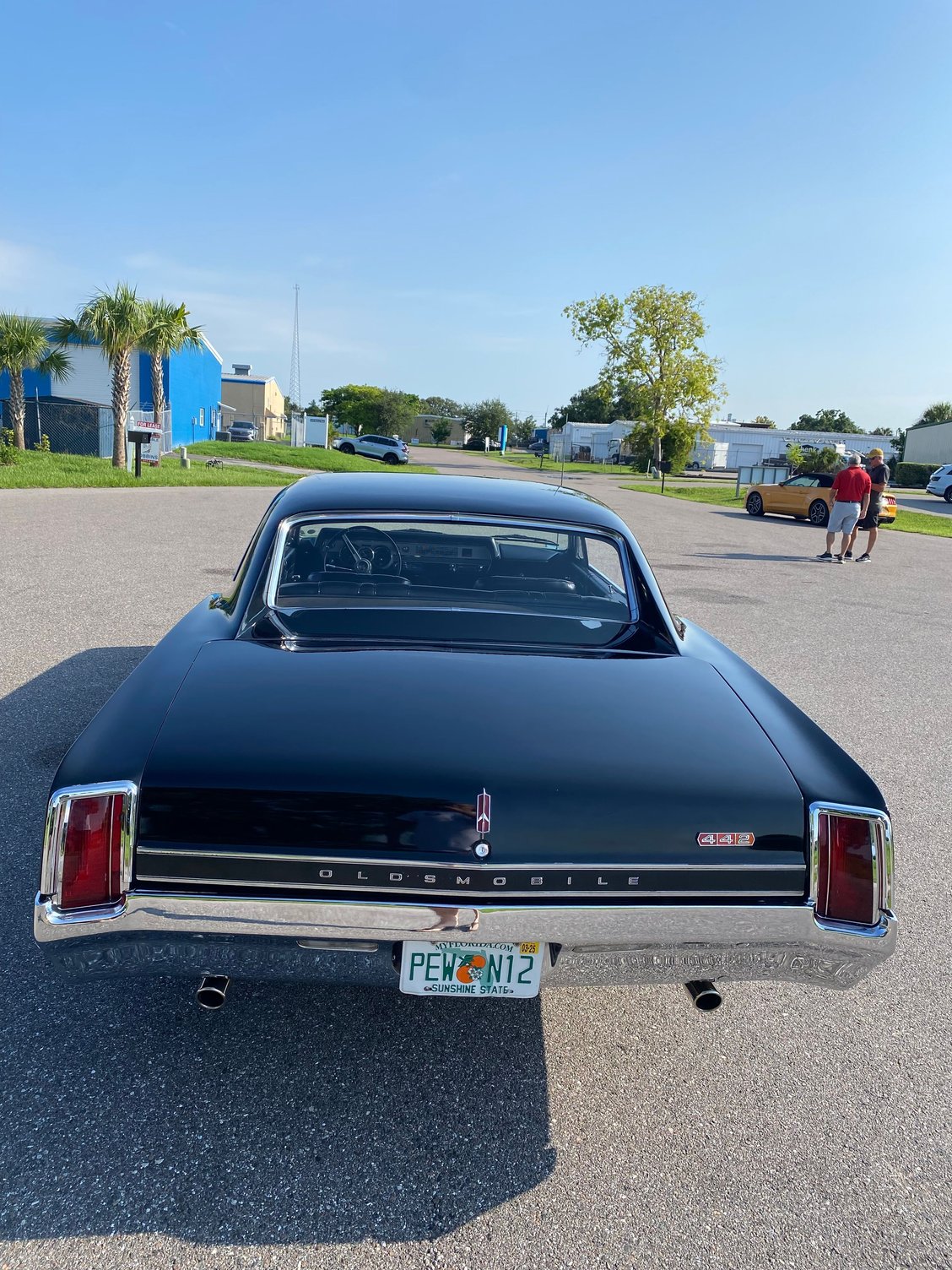

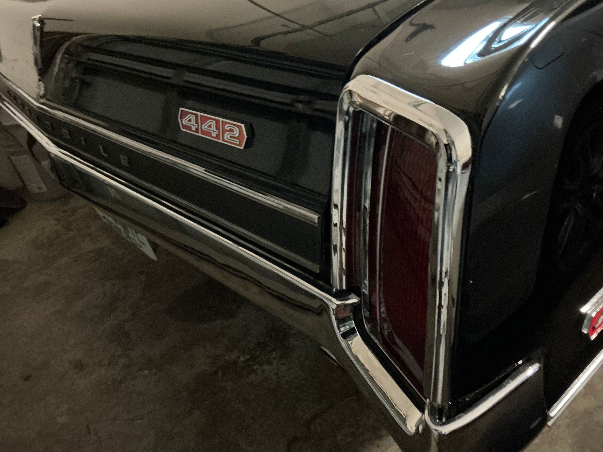

Thorntons on my car.
Old Jan 2, 2025 | 03:20 PM
Joined: Sep 2013
Posts: 2,882
looks nice. how’s your trunk trim? I have two, neither are that good
Old Jan 2, 2025 | 04:06 PM
Andy's Avatar
Joined: Jan 2020
Posts: 2,831
‘Trunk trim is decent, fair amount of pimpling, just cleaned and repainted it.
