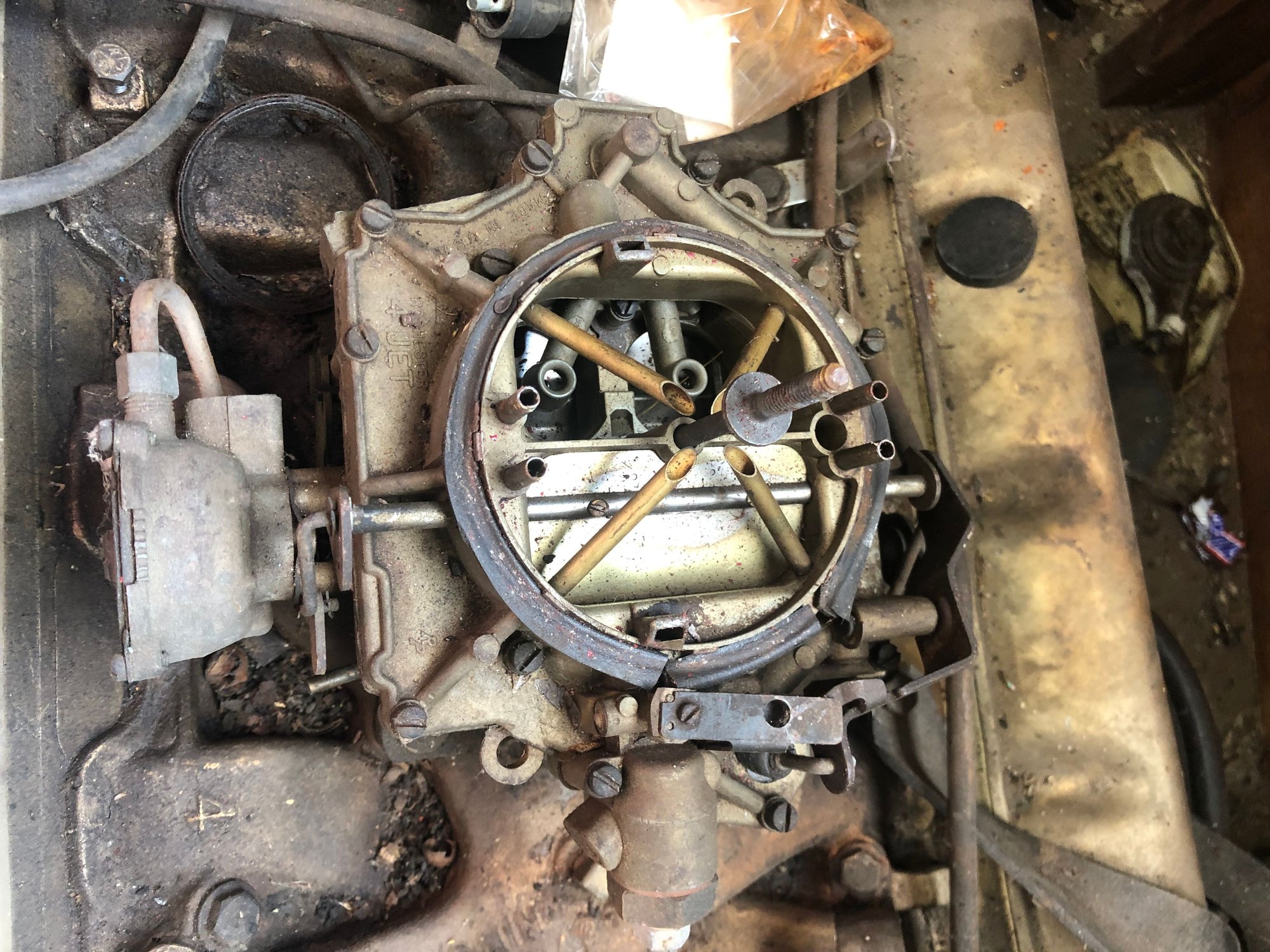

Here’s what I found.

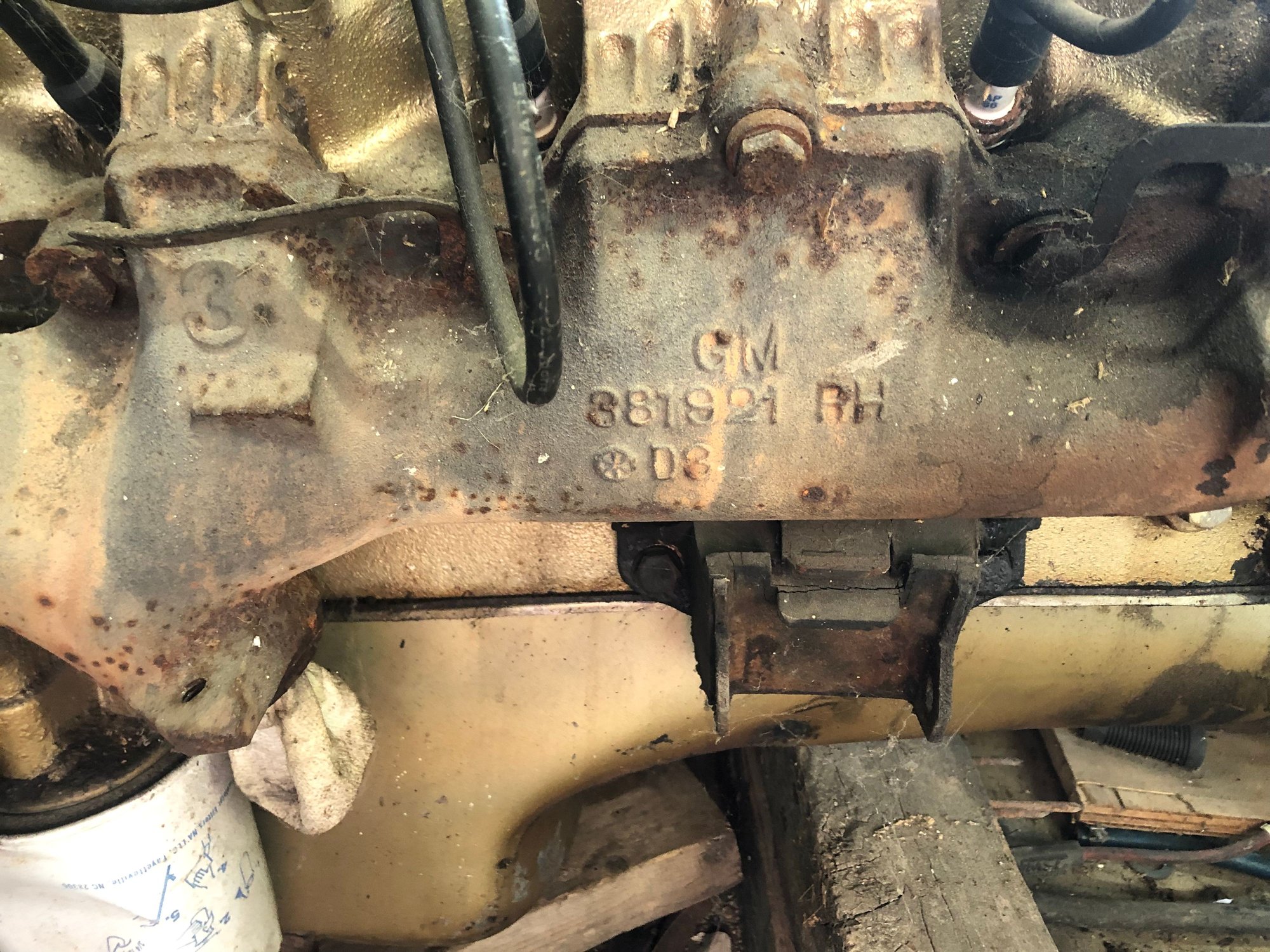

Old Dec 18, 2022 | 11:02 AM
The engine unit number with a "T" prefix and a "G" suffix was used on every high compression 330 4bbl motor built in 1964 and 65. The engine unit numbers started with 001xx in 1964 and 5xxxx in 1965. I can't read the number in the photo. The air cleaner is a 1965 style. The water pump is a 1965-newer pump, not the correct 1964 pump with the driver side inlet. To use this pump, both the timing tab and the balancer would need to be changed to the 1965-newer style. Exhaust manifold 381921 was used on every 1964-67 Olds 330. Intake manifold 387691 is a 1965-only intake. The evidence suggests that this is not a 1964 motor but a 1965 item, so not surprisingly the seller's story is a total fabrication.

Thanks for the info Joe. My first impression when I saw the set up was 65 but I wasnt going to argue with the guy unless I knew it for sure. He wants $1200 so I passed quickly.
